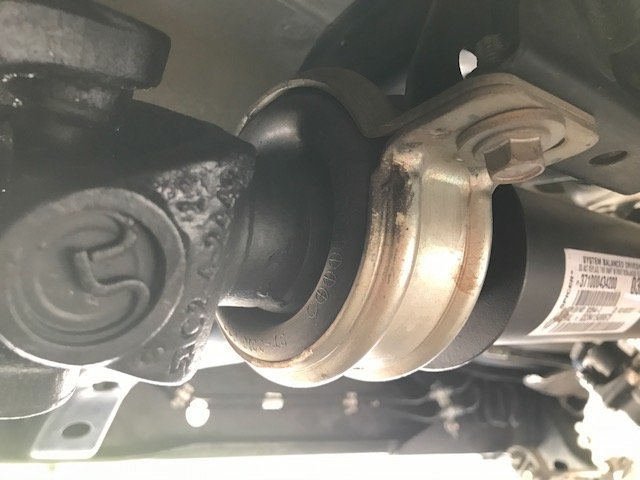

    Here is a photo of my carrier bearing. Not sure if I see an issue other than it sags about 1/2 inch low from center comparing the rubber at the top and bottom. You guys see anything wrong with it?

    I tested slow n go traffic driving in 4th all week and the same problem persists. I soon as I let off the accelerator the truck slightly shakes and after coasting for a bit when I press the accelerator I feel a thud as the tranny engages again. Any comments on my carrier bearing photo?
