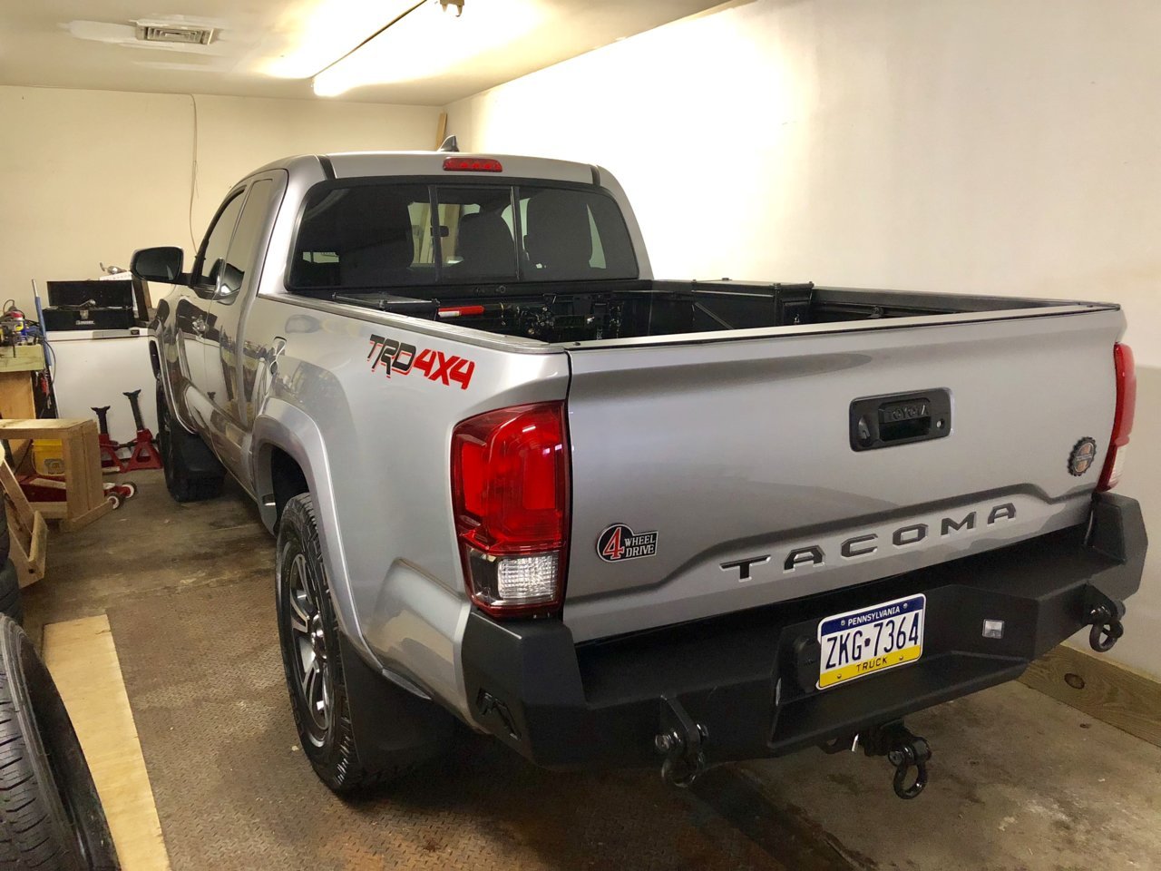

    Just put a shackle in the hitch receiver

    342
    Portland, OR
    2017 Tacoma D-Cab Off Road (MT)
    Norsemanvike[OP] likes this.
