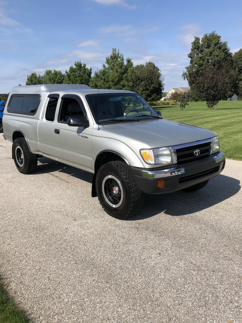

    Hey everyone,
    My name is Josh and I need some advice. I currently own a 2000 Tacoma 4 cylinder. I bought this truck when I turned 16 and it was my first vehicle. It had 114xxx miles on it when I bought it and currently has around 175xxx miles on it. I graduated college last May and got my first adult job in April. I currently drive approximately 60 miles to work one way. The other day, on my way home from work, I noticed that my check engine light was on. My dad and I checked it out and it threw a code, 420 I believe, for the EGR valve. In the process of checking that, we noticed that the truck had major rust issues on the frame (go figure). I have had rust problems before that failed inspection, and was a quick relatively inexpensive fix, but this seems much worse. The whole crossmember in the rear is rusted severely and is one bad bump away from falling apart on the passenger side, which creates its own set of problems. Not only that but the bottom of the engine/transmission was also wet with transmission fluid. It wasn't dripping but it was slightly wet. We found an aftermarket crossmember that costs about $300. There is also some other rust spots that need touched up, which is gonna cost around another $300. That just will be a stop gap until next May, when I'm sure after another PA winter (the state uses salt) there will be more rust damage that will need to be addressed to pass inspection. But we still don't know how much it will cost to fix the truck for the EGR valve (?) or the transmission leak. Yesterday, the check engine light came back on after we cleared it and it threw the original codes as well as another one relating to the cadillac converter. Also it's worth noting that the truck has a slight knock when you start it cold in the winter that dissipates when the truck is warmed up. Taking all of that into consideration, I'm just not sure it's worth spending more money trying to fix it or just cut my losses. I love this truck and really would like to keep it, at the same time I realize that continuing to throw money at it is a losing battle. I am looking at the new 2019 Tacoma TRD sport and like that but I have also heard that the new generation is having problems with the transmission. I am trying to decide if I should fix my truck or move on. Does anyone have the new generation or 2019 and have problems with the transmission? Has toyota fixed this problem? Also, has toyota done anything to fix their frames so they don't rust as much? Should I fix my first gen or should I cut my losses? Any guidance, advice, or recommendations would be much appreciated. Thank you.
