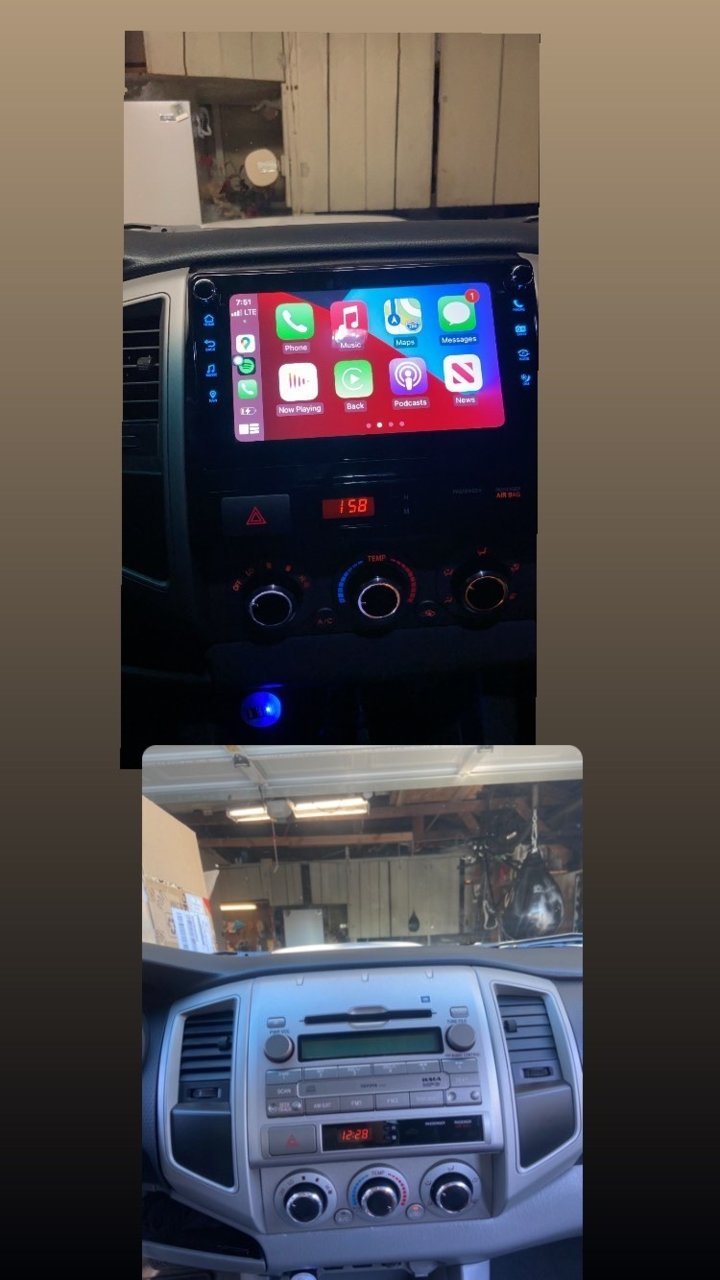

  15. Dec 14, 2021 at 6:55 PM
    Pearson
    Pearson Well-Known Member
    Aug 21, 2021
    #374865
    736
    Elliott
    Lexington Texas
    Black 2012 2.7L Prerunner
    Full Squish[OP] likes this.
  16. Dec 15, 2021 at 12:34 AM
    #16
    Tac11
    Tac11 Well-Known Member
    Mar 15, 2016
    #181370
    301
    Luis
    2011 white Tacoma sport TRD
    3" Front lift OME/5100 set at 0, 1/4 spacer on driver side CMC, BFG 285's, SCS ray 10’s -38 offset 1 inch rear block N-Fab steps Bumper Cali Raised LED light bar Cali Raised LED fog lights After market exhaust, and muffler tip Redline hood struts Tacoma Bed-liner mat Tailgate lock Tinted windows 20% HID headlights Short antenna Clazzio Seat covers Joying head unit
    Joying for the win
    Full Squish[OP] and Pearson like this.
