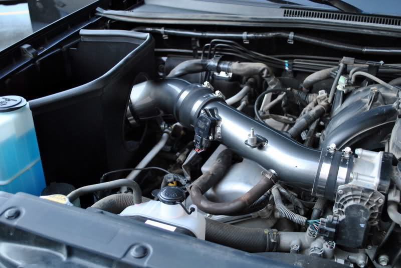

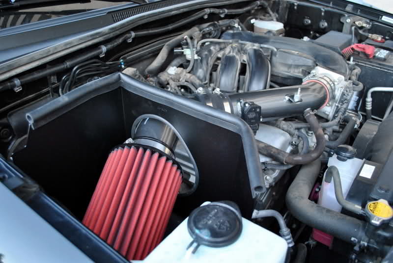

    First "can't leave well enough alone" mod done to the new Taco :)
    AEM Brute Force intake. Magnaflow Exhaust to come tomorrow!

    seems with that big hole and all that the air your engine will be getting may actually be warmer that the OEM intake

    that seems like it'll bring in more hot air then cold air vs. the stock intake

    Yes, the MAF has to be that way. The tube can't be rotated because it is also the mount for the engine cover. Also, I'm not concerned about the slightly warmer air over stock. There will be a whole lot more of it. As for water... also not concerned. Don't blast puddles no mo.

    So to the naysayers, I drove the truck up into the mountains this evening after hooking up my new PLX Kiwi. Outside temp was listed as 70°F, intake temp list as 78.8°F. I think less than 10 degrees warmer is negligible at best. I'm sure it would be a higher delta while going slow, but I don't really care 'bout that!
