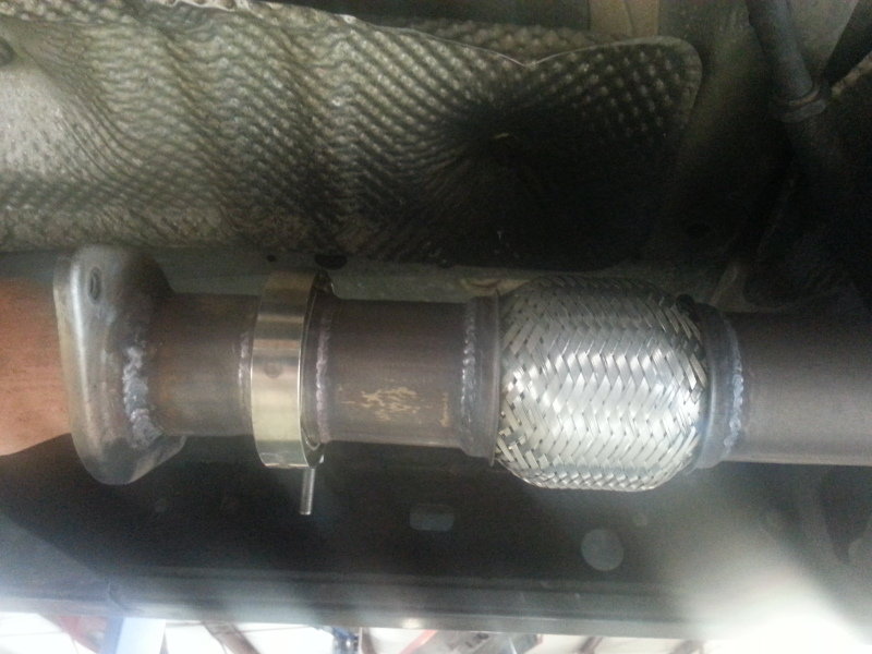

    I will snap a photo for you tomorrow when the truck is on the lift.

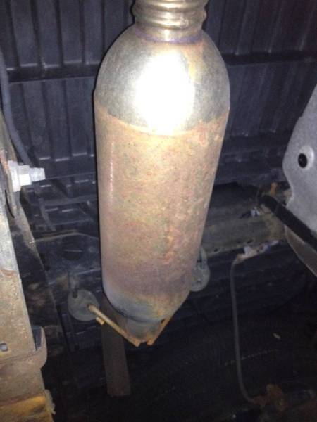

    Sorry for shitty try photos. I love the sound. And I am in New England and had a ton of salt on this thing. Good thing it has lifetime rust out warranty.

    Much appreciated. Did you do the install yourself? Anything I should be concerned about? Is there anything you'd do differently? Are you dumped after the axle?

    I did not install it myself. I had a muffler shop cut out the factory muffler and weld in the 2525XL. I did cut off the exhaust tube just after the axle as you can see in the first picture. I have the 4.0l with the automatic trans and I was getting an very annoying drone at 1200-1300 RPMs. Once I cut it off on the down turn I immediately noticed the drone was gone. In it's place is a a more noticeable throaty sound which is slightly louder which I liked much better.

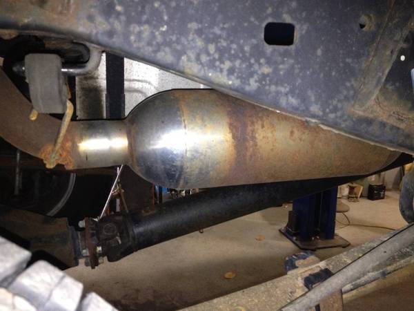

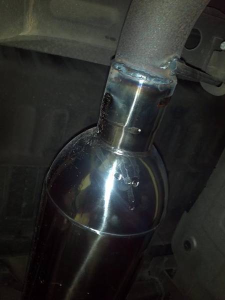

    I had it installed as quickly as possible. (within 12hours) and I must say I really do enjoy the sound. The beauty of this muffler is it doesn't really sound and louder when cruising. For those who have a CAI and enjoy that volume, it's definitely no louder, however, now you don't have to press on it to hear. I like driving around real slow, while trying to keep my RPM's as low as possible and with this muffler the truck sounds unreal when doing so. Below are a couple of pics of the muffler installed. Overall I think it's job well done, however, in hindsight I would have like to see the writing stamped on the muffler pointed down so anyone who bent down to look would see, but that's just me being picky.

    Did u need add more pipe for it , mine they add more pipe to make it even cause thr inlet higher than outlet and the Aero 2525 is straight in & out

    No they didn't add any pipe, there was enough play to make them line up and by doing so it actually made the muffler tuck up a little higher. Since it's gotten nice out (I'm up in Canada), I've been driving alot more with the rear window open and I do hear a bit of a rattle in the exhaust, especially during idle when the engine is cold. Not sure if it's related because I haven't had a chance to get under and look.
