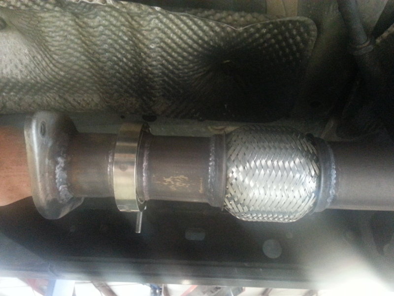

    Torspd Custom Turbo kit [] Borg Warner 9180EFR Turbo [] Haltech Elite 2500 [] TiAL Q BOV [] TiAL V44 Wastegate @ 15psi [] CP Pistons [] CP Carrillo Rods [] ARP Head studs [] ARP Main Studs [] ARP Header - Head Studs [] Ported Heads w/ 1mm oversized valves intake/exhaust [] Brian Crower Forged Stroker Crank [] Darton M.I.D. Sleeved Block [] Kelford Camshafts [] Torspd 160* T-stat mod [] APR Large Fuel Rail [] Walbro 460 LPH E85 Fuel Pump [] FueLab FPR [] APR T56 Conversion Kit [] KP RACING Built T56 [] McLeod Racing Custom Twin Disk Clutch [] One Piece Aluminum Driveshaft [] MGW Shifter [] Custom lowering kit [] Ohlins Front Coilovers [] QA1rear shocks [] Custom Ron Davis Radiator [] Dual SPAL Electric Fans []
    Here you go Moose.
    You'll have to have the shop add in some sort of flange, if you want to make it easier to pull your exhaust in pieces.
    ETaco23, still has his OEM flanges, which simulate a flex coupling.

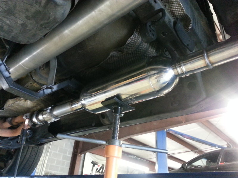

  8. Sep 2, 2014 at 4:54 PM
    #48
    ETaco23
    ETaco23 Marshall offroad Fabrication
    Feb 2, 2008
    #4544
    5,509
    Evan
    PNW
    13' Pyrite Mica TRD Offroad DCSB 4x4
    Color Match Grille, Bed mat, Kings with JBA UCA's, Dakars and 34" BFG KM3, Snugtop Canopy, and my "Marshall Fabrication" Rock Sliders.
    They're full of shit man! they just didn't want to do it.
    Im sure my 18" res. is quieter than the Aero by itself, but it for sure made a huge difference. for him to say it wont do anything is s
    just stupid.
    I would leave the 3" piping but just put in a resonator.
    If u do high flow cats, do it first before the res. and see how it sounds. it may quiet it down enough.

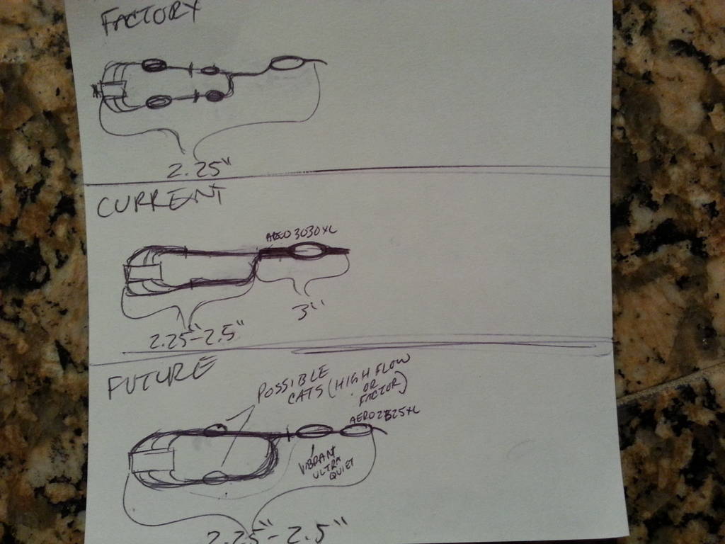

    I mean i somewhat see their point, as how they ran the 3" piping would make it difficult to add it in. they need to redo the collector and add a flange, then add a new section of 3".. add the resonator, then move the aero back.
    Im just taking it in saturday and will be there the entire time to make sure its right.
    this is what im thinking..
    1) add high flow cats (which ones?) to the Y, then a new collector, flange, new 3" piping, 18" vibrant ultra quiet, and then the 3030xl
    2) same as above.. but ditch the 3" piping. and go back to 2.5" after the collector (so its 2.5" throughout), flange, 18" vibrant, and back to the 2525xl.
    or i could throw in the factory cats in the Y.. there are just so many factors and options... AAAAGHHH!! :goingcrazy: :pout:

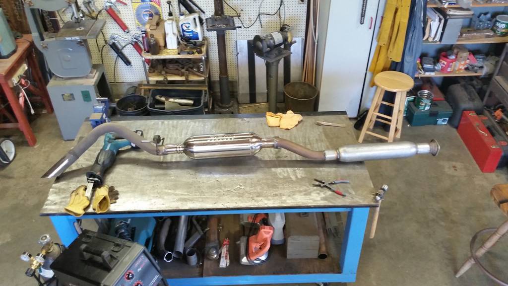

  11. Sep 2, 2014 at 7:21 PM
    #51
    tooter
    tooter play every day
    Apr 13, 2013
    #102021
    2,456
    Greg
    Los Angeles
    2012, std cab, 5 lug, 2.7, 5 speed
    Built for maximum low end torque, tooter II.VII intake manifold spacer, LCE long tube header, Injen long tube intake, 2,900 rpm torque peak.
    Yikes, now I know what you mean. That's effing loud... :eek:
    If you don't alrady have a great big exhaust tip welded on the end of your pipe, you could try a really cheap experiment yourself. :)
    At the auto parts stores they typically have a rack with all sizes of exhaust couplings and adaptors. They're usually under $5 each. See if you can find one that reduces down in size from the exhaust pipe you're running. Slip it over the end and start it up just to see how it sounds.
    Greg

    interesting. may try that. thanks :thumbsup:
    quoted from my build:
    this is what im thinking of doing. starting with the removal of the 3" piping, going down to match the rest. adding a Vibrant Ultra Quiet, then my 2525xl. if it needs more.. ill add either 2 high flow cats, or just factory ones, maybe even mine.

    I guess thats one way to look at it. lol
    I'm thinking this is what I'll end up doing..
    high flow cats in the Y
    ditch the 3" piping
    add flanges
    do 2.25" piping
    18" Vibrant ultra quiet resonator
    put my 2525xl back on
    Im wanting to tame the sound and rasp a bit more, as well as get some of my low end back. I think this will be the best setup to get a good mix.
    unless others think differently... lol
