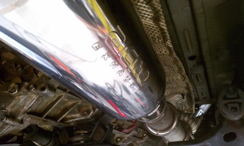

    There should be an indicator of direction of exhaust flow on the muffler itself.

    The indicator on the pipe is the two rings on one inlet side, this is the outlet of the the muffler.
    [​IMG]Here is what my instructions say...

    In this picture, if you look closely at the front of it, you can see the sticker that says,"Inlet".

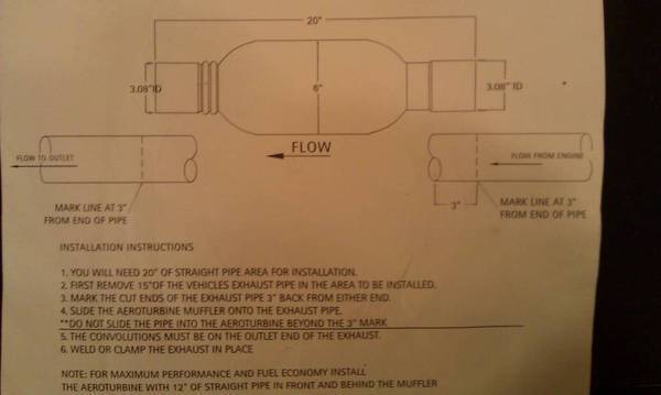

    Here is the instructions i got with my Aero.

    ^^^thanks for posting, wonder if that 3" criteria is causing my drone @ 1300rpm...really have no way of knowing what went on @ install...

    I've got a 2525 areo muff and a AR25 resonator. I had the Ar25 welded in front of 2525, now i am running into the problem of will it fit per instructions. I've looked at the oe muff and there is a offset in front of the muffler and only like less than 6 in of strait pipe after the oe muff.
    My question is: when i cut the oe muffler out and i cut the offset pipe off and add 12" of pipe to the outlet of the aero set. Will i need an offset to link the exhaust all back together? The other think that im over thinking is that will the muffler be to low and cause problem?
    Oh well, its to hard for some one to visualize the problems that could occur. I just have to dig in and do it...
