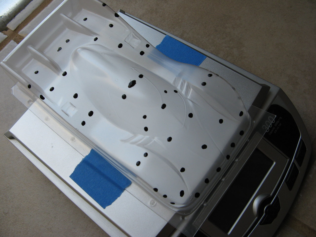

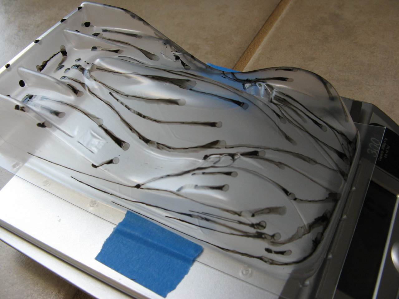

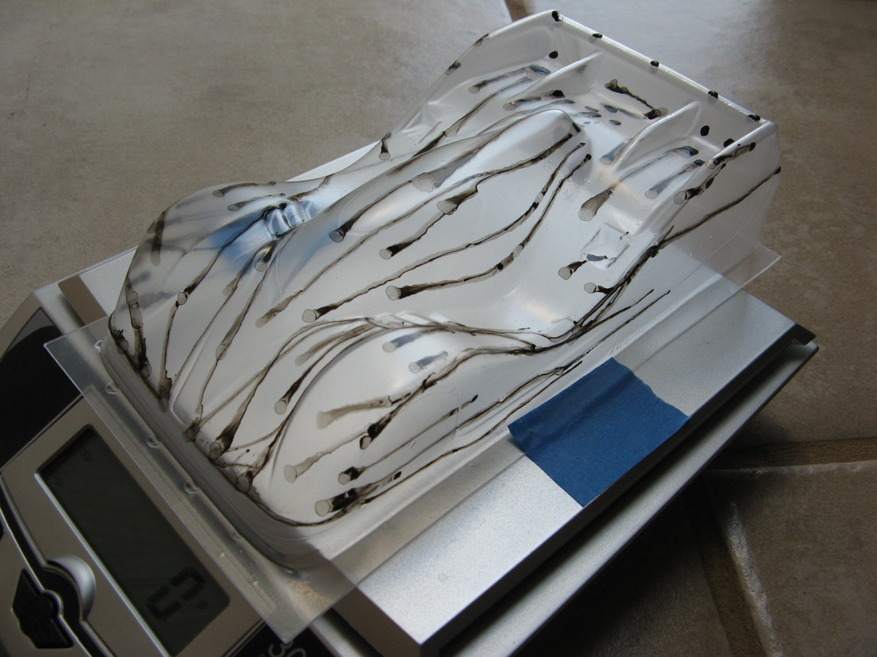

    One way to check where detachment actually starts is by adding some kind of watercolor dots or visible fluid, that won't stain the paint in specific questionable areas you want the air to stay attached. Then drive it fast! You will probably figure out a newer optimal position to place your little VG gadgets at these points and angle the side ones differently to see if helps optimize flow and your KPL tests even more.
    That's how we run tests in a tunnel, with ink blots on the surfaces of our models. Would love to see ink streaks on a full size vehicle. LOL. Fun project you've got going on!
    Since I can't post pics of the secret stuff in the tunnels, here was an example we used before to observe flow on a race car speed form. Hope this gives you an understanding of what I was talking about with the water color and identifiable marks. (Please be careful with what you end up using as I don't want to be held responsible for you paint staining should you decide to try this).

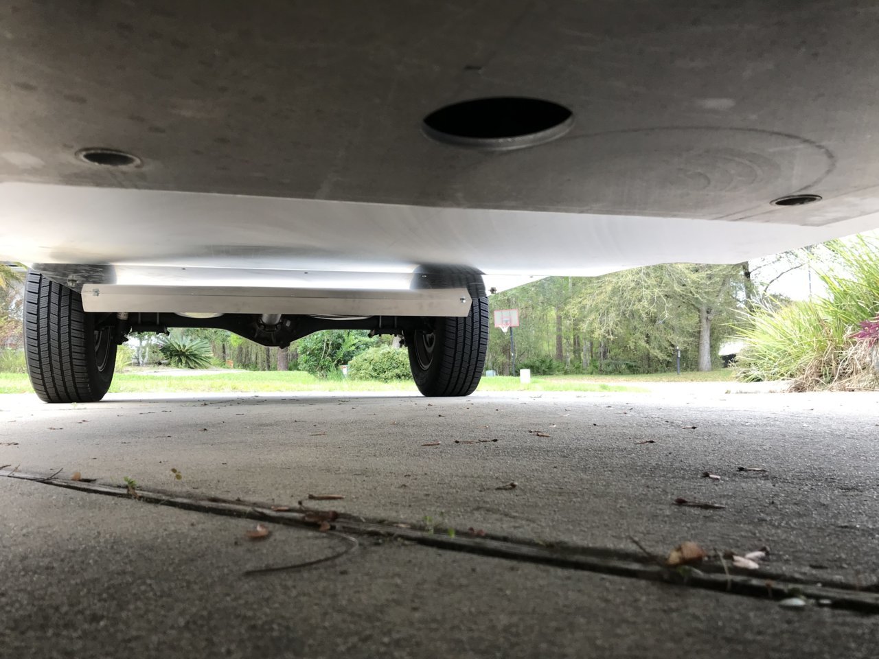

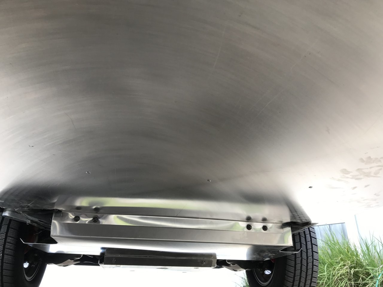

    It turns out to be closer to 5% after testing on the same 150+ mile round trip that I make once a week using the same gas and highway speeds. The only variable out of my control was the wind speed and direction. Averaging out the results over many months showed a 1.25 MPG increase with the belly pan. The following pictures show my revised V.2 version while the following link gives a more detailed write up and a link to my V.1. I will be selling my V.1 for 75$ but will not be able to ship it. It will be for a Florida or Georgia pick up only.
    https://www.tacomaworld.com/threads...-3rd-gen-today.399305/page-5882#post-20070643
