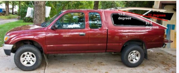

    I don't see the big deal in a max 30lb fiberglass shell. Remove it for the weekend if you need the extra 2 feet above the tailgate
    People on this forum do crazier, more expensive, less practical things every day.
    As I think said before, 1st gens in particular have so many little improvements that could be made and they all add up. If new trucks are squeezing out 21mpg+ and I average like 15, I see that as 6mpg that can be scavenged by traditional means, even if only 2-3 is from applying modern aero practices (the other being mechanical) and more-so from unconventional means.
    Personally I wouldn't build a shell, I'd build a front air dam and flat undercarriage that meets up with built sideskirts and level them with my point of min ground clearance.
    Mechanically, I'd get like 10.5:1 pistons and Camry camshafts.

    Some flaps on the back might make a difference...you never know until you try, or test them in a wind tunnel. I would try some small ones.
    Smaller side mirrors can reduce drag a little bit.

    I believe those aerocaps are designed to be pretty versatile. If there was something economical and removable for the 4runner I'd be interested. I've thought about a removable air dam for cross country driving. I just don't know if it would be effective enough to justify the effort.
    In the case of someone looking to save money on their work commute, I would agree that a Corolla or something similar would be more effective, given the person has space and money for an additional vehicle.

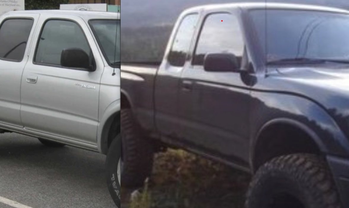

    A step in the right direction is adding a lip kit, and a tonneau cover for your bed. After that, it may be a good idea to look into slightly narrower tires, as well as some sort of spoiler above the cabin.
    Another thing, that probably helps, are the manual side mirror that some 1st gens have. Compared to the electric powered ones, that 1st gens have, the manual ones are sleeker and less boxier, which should have an effect on aerodynamics. Like this:
    This is all based on info from here:
    https://www.youtube.com/watch?v=Qy-nNeCnfYY
    https://allfitautomotive.com/blog/how-to-improve-your-aerodynamics-allfit-automotive/
