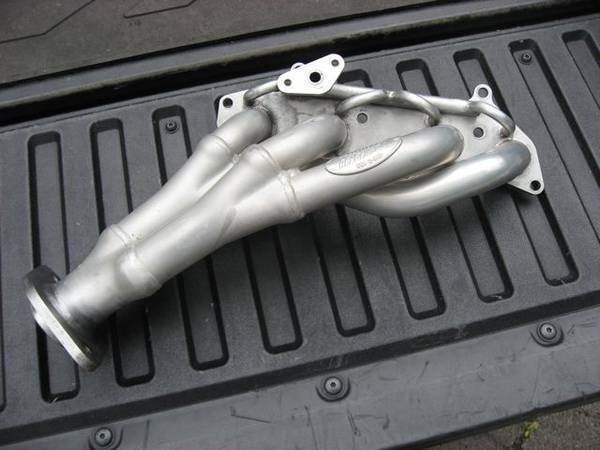

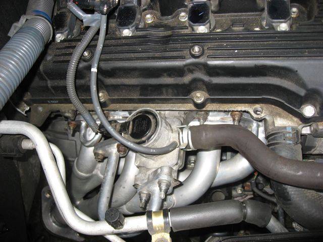

    Installed my DT headers last week. Finally got the pics off the camera.
    Before
    After
    I replaced the header gasket and the exhaust gasket during the install. Thought I had an exhaust leak, but it didn't smell like exhaust. Turned out to be the Deep Creep I used to loosen the bolts burning off. :rolleyes: Other than that the install went well, but some of the bolts were hard to get to after installing the header. I haven't noticed much of an increase in hp or torque with the butt dyno, but at the RPM ranges I run, it's probably hard to notice.

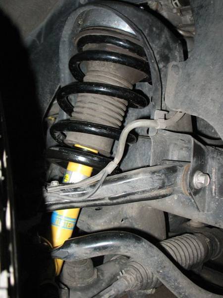

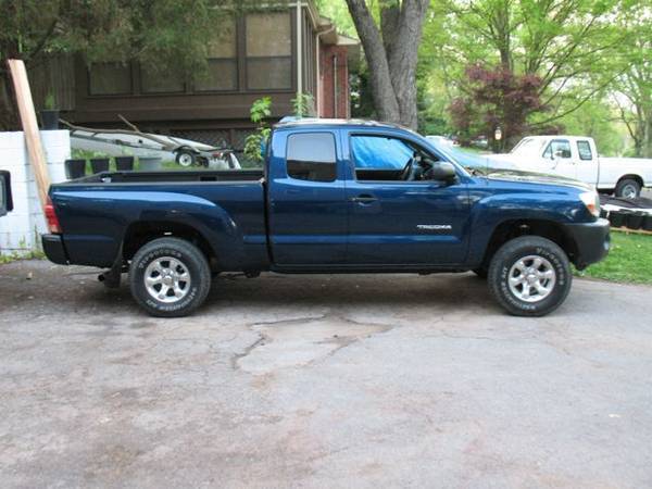

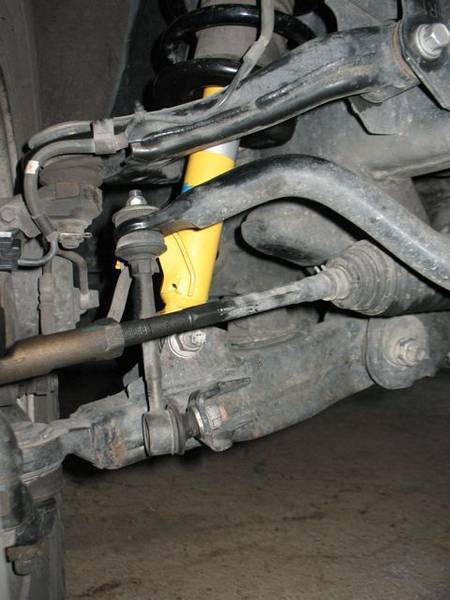

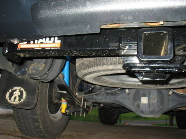

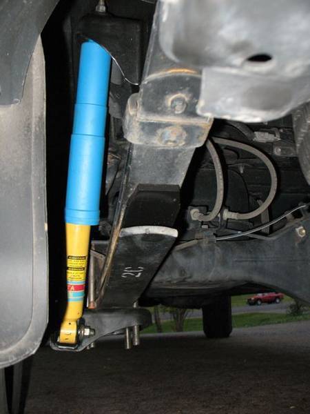

    Last weekend I got to do some work on the truck. Put on the lift from Fat Bob's, Bilstein HD shocks, a Curt Mfg Class III hitch and the trailer wiring.
    After the lift and struts
    Couple pics of the front struts
    Here's one of the rears
    And the receiver hitch

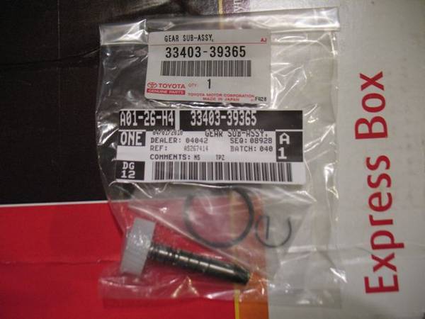

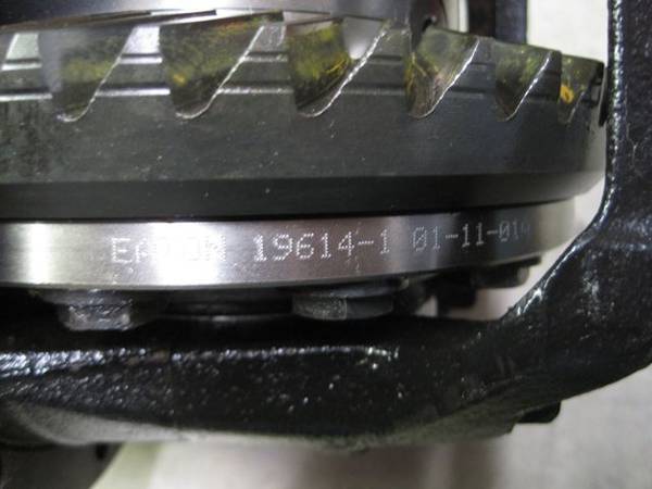

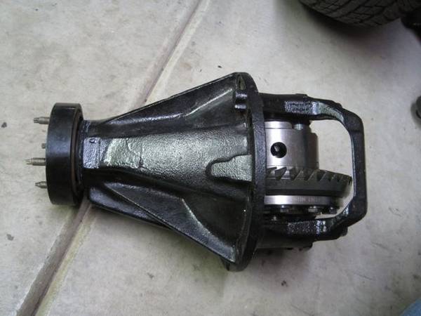

    Up next is Bridgestone AT Revo 2's, 4.10 gears with an Eaton LSD, and new speedo gear so the speedo and odometer read correctly.
    Complete third member
    Eaton Part No
    Gear Ratio
    Speedo Gear

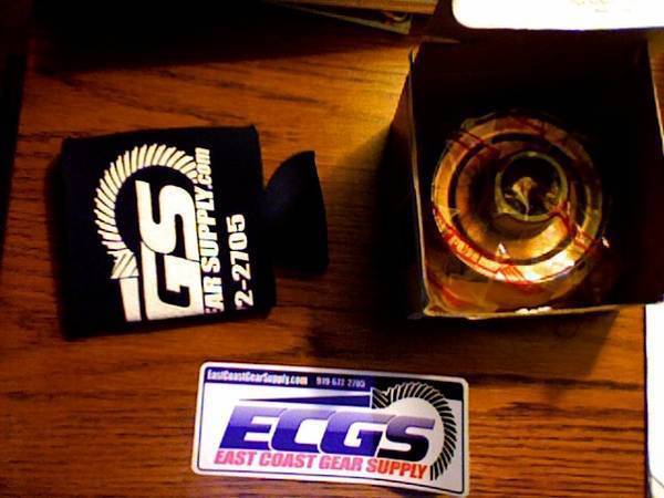

    Tried to install the new third member last weekend only to find out the hard way that it has a different pinion flange on it. I apparently knew this needed to be changed but had forgotten about it at some point. So while I had everything apart I painted my brake drums black with VHT paint.
    On a side note when I drained the AMSoil 75w-90 from the rear diff, it looked and smelled just like new. There were some metal shavings on the drain plug but I consider that normal. I should've taken a sample and sent it in for analysis just to see. Not sure how many miles on that oil but it was probably a little over 20k.

    On Monday I ordered a new double-drilled pinion flange from East Coast Gear Supply. It was at the door when I got home today. They included a sticker and a can koozie!:woot:

    I had the same problem with the flange last week when I was swapping diffs. How much did you pay for the double drill flange?

    It was $55 before shipping from east coast gear supply. They have another one that is $25 but I think that's for the pre tacoma trucks.
