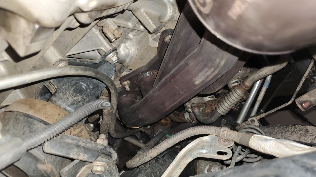

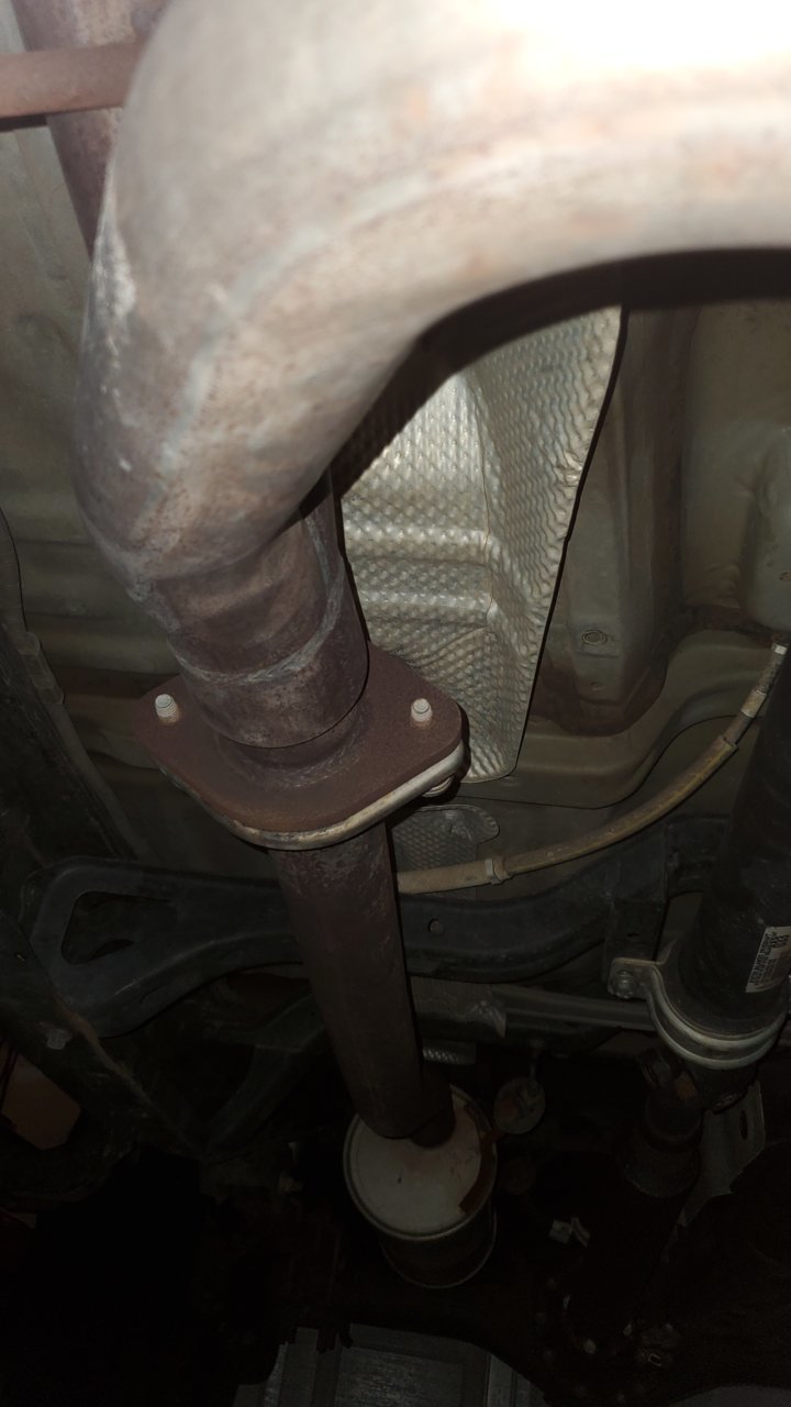

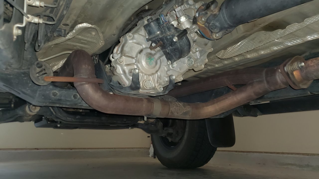

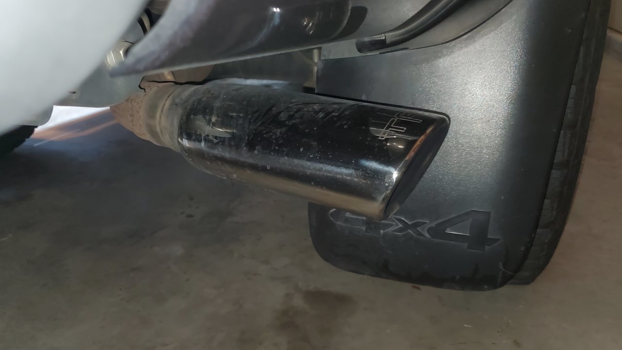

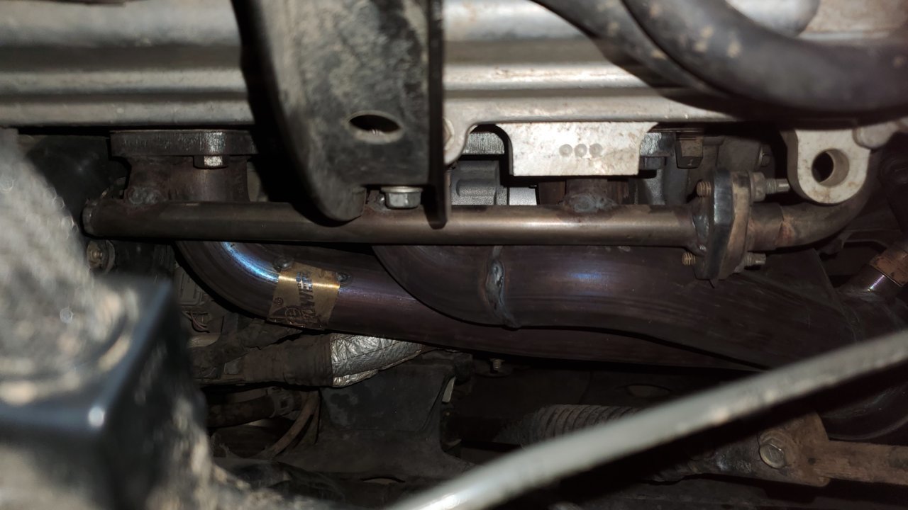

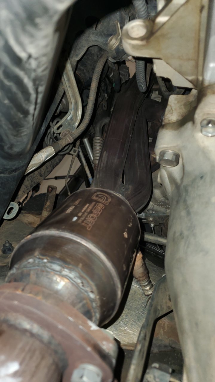

    @WebberLander I'm no photographer but here ya go.
    Also, I really enjoy this setup! Nice calm and throaty when I'm keeping it under 2k. Then a nice deep brAAAAAP when I lay into it over 2.5k.
    I have the whole truck matted too though and I know that makes a difference just fyi
