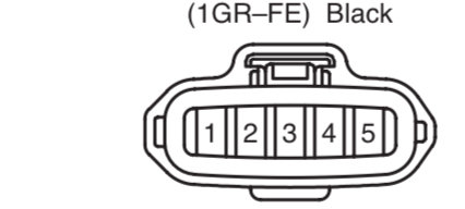

    Check pin #1 Blue/White for power
    And #5 Brown wire for ground
    Key ON - Engine doesn’t have to be running.
