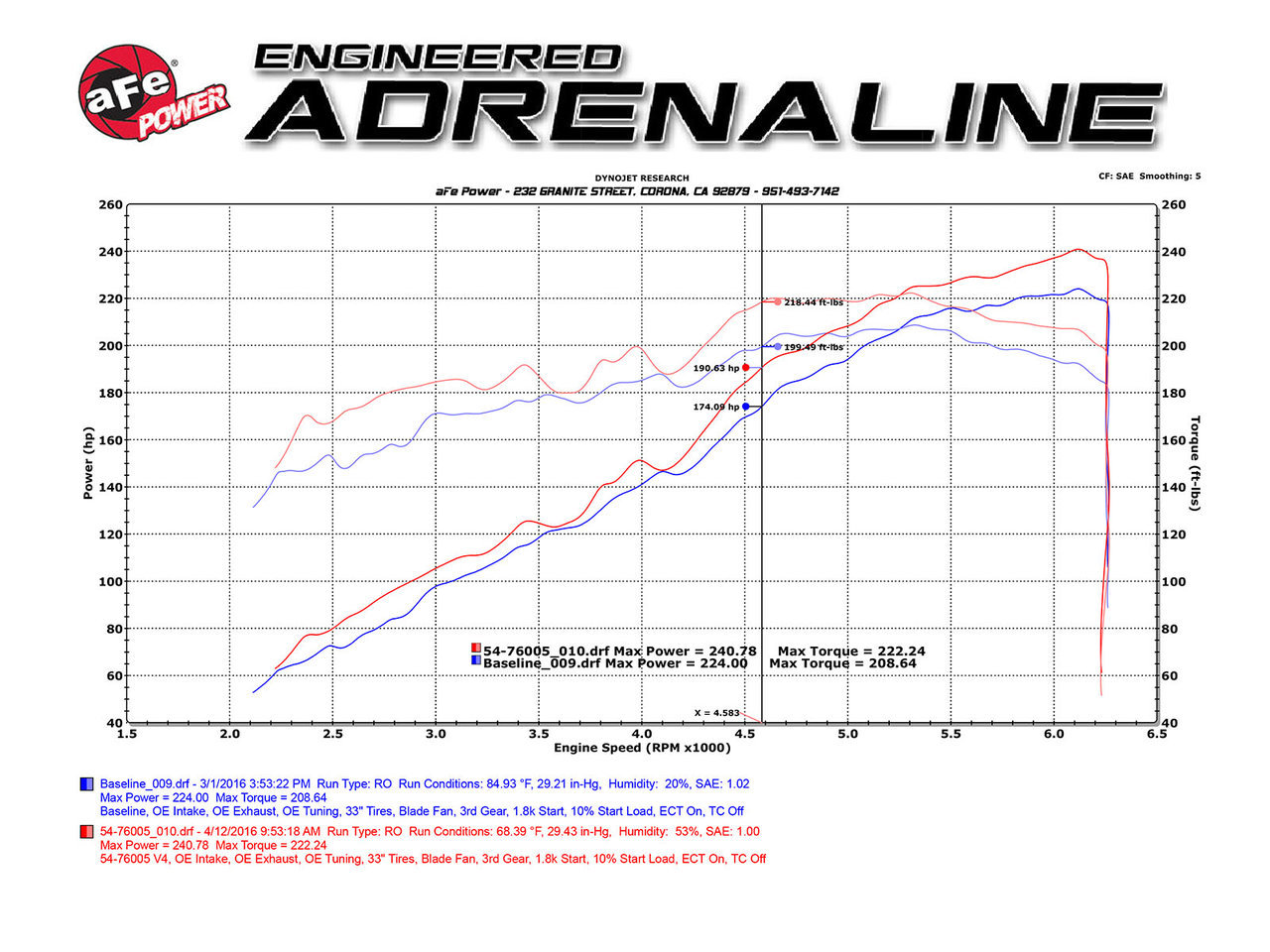

    I actually just did this for my own reference. Not a lot of information out there. IMG_3281.jpgI did find this on the manufacture's website. Note the dates and temperatures. Thus this dyno sheet can not be trusted. Not to mention the 20 ft lb torque increase at 2600 RPM would never happen. Their website is full of bs marketing. I find nothing dyno related from any independent Dyno. Bottom line, I expect a few hp gain (less than 10) at the top of the gear. The sound will be cool, and they look nice. The price is very, very high, and there is a lot of bs marketing. My $.02

    Exactly.
    Show me a dyno that was done same day, same car from an independent user. I already looked for an independent dyno that showed gains like what the manufacturer posted and did not find any. The previous community I was in was with AMG mercedes and a 1500 intake would net only about 3-5hp on a dyno, no different than what removing the charcoal air filters would do. People actually did their own dyno runs as did I with results. Intakes on N/A cars are generally useless unless you get full I/H/E with a tune.
