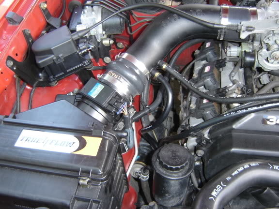

    Replacing the tube but leaving the air box will only add noise and if you do any serious off roading I do not recommend it.
    I had one and it broke my air box because unlike the stock air intake tube that bends the AEM tube is solid.
    Sold it as soon as I got home to a guy with an S-runner.
    If you aren't going for noise then just do a drop in filter..

    This is what I had, the little flex part near the airbox is new.DSC00918_290e3dba2d507aec3cb65710ed292d7802798dfe.jpg
