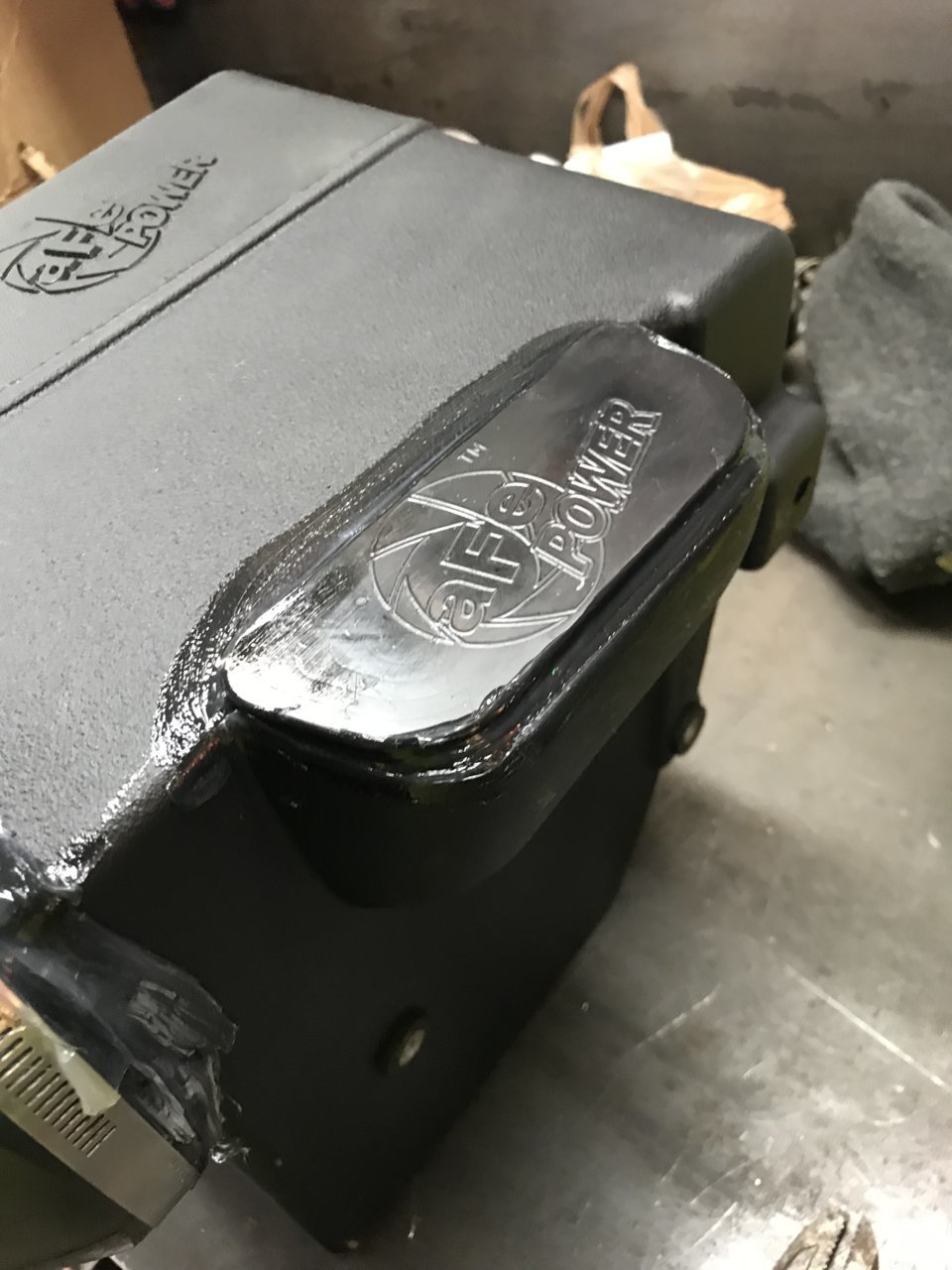

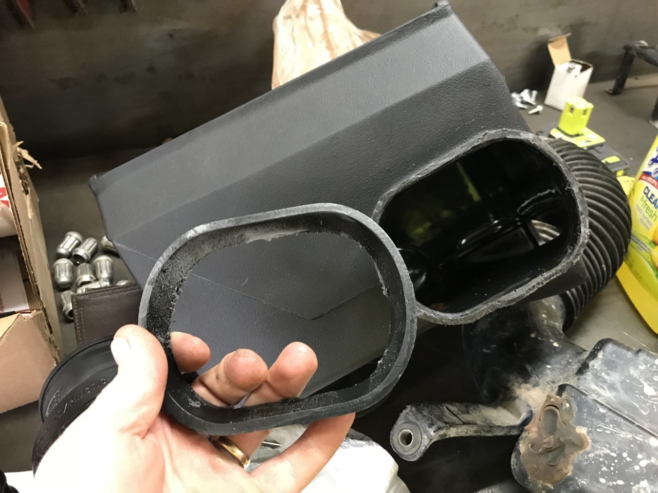

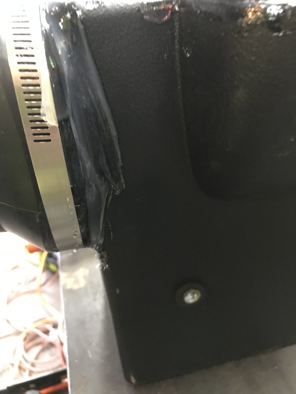

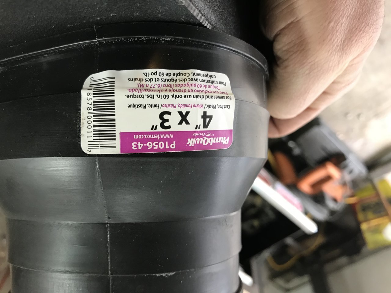

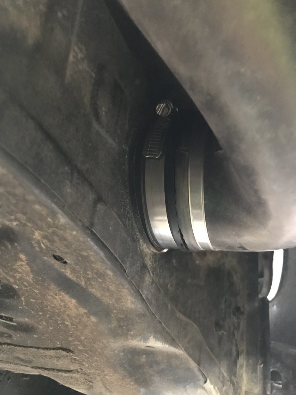

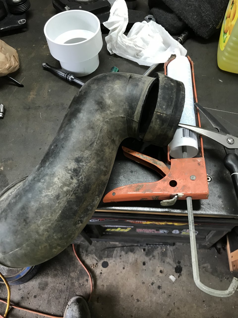

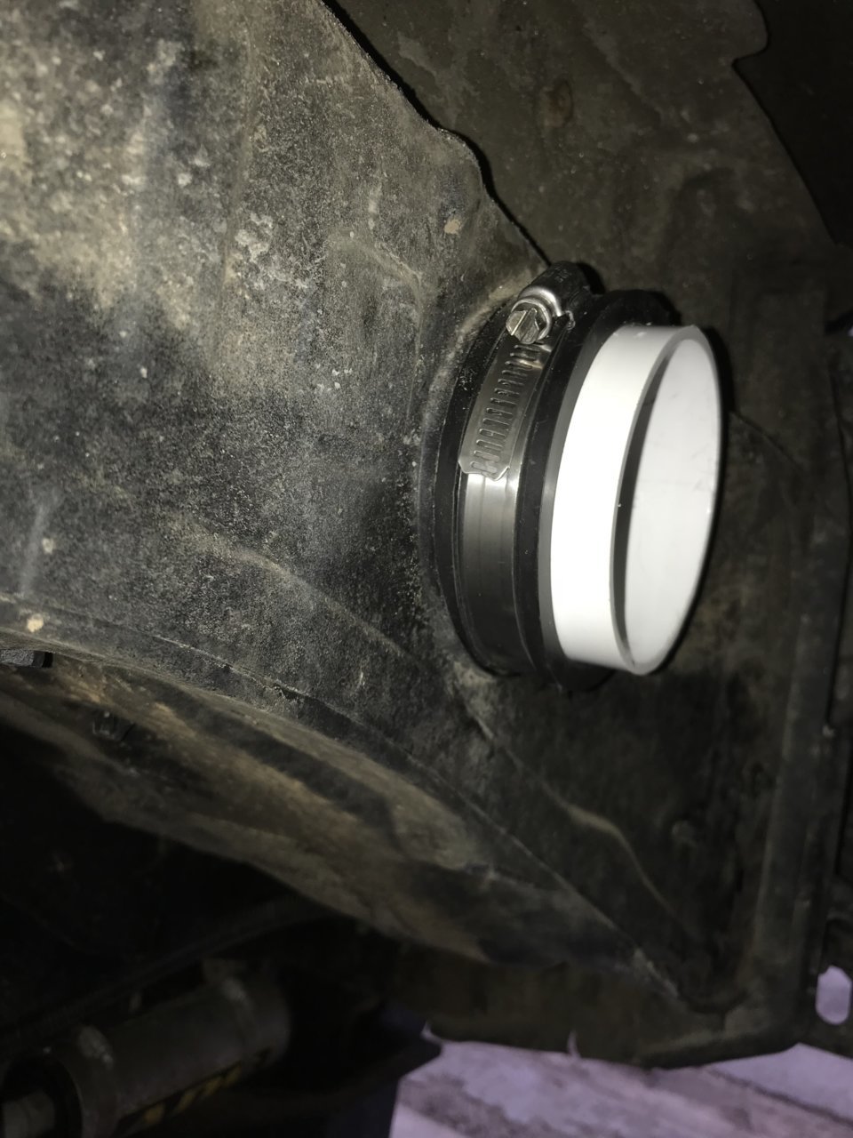

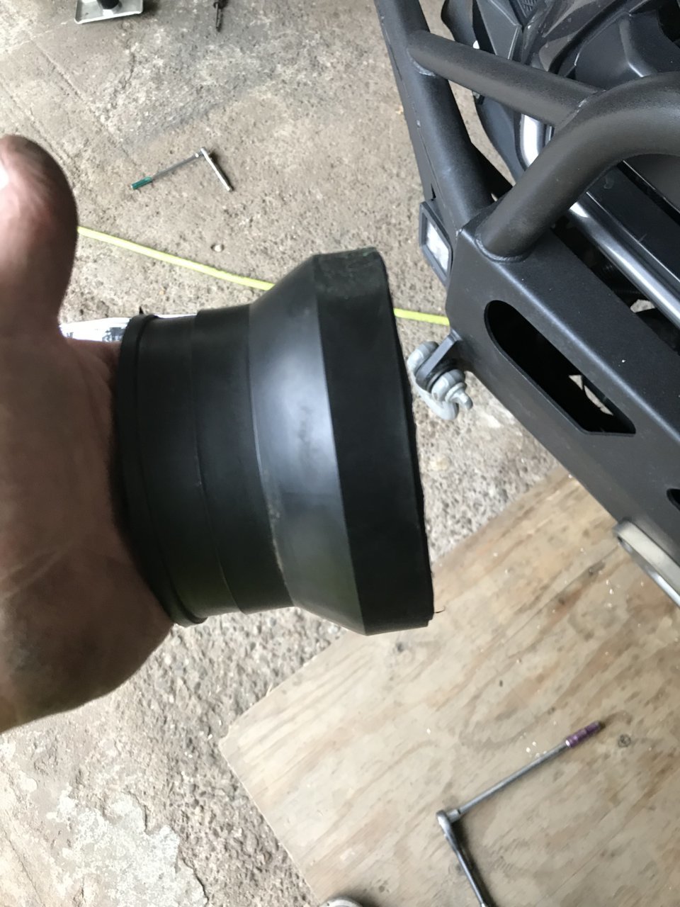

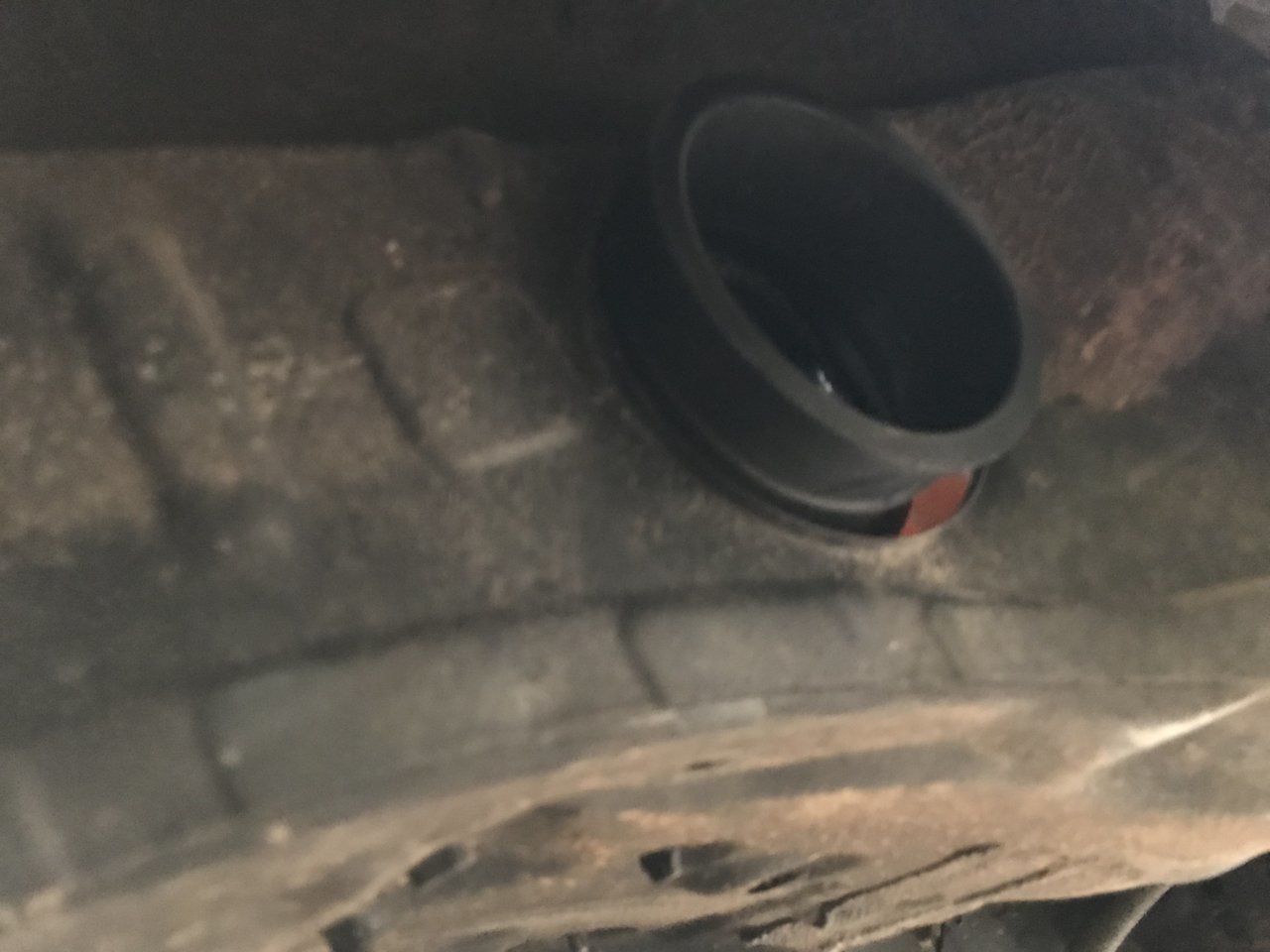

    When I was searching, I couldn’t find a write up, so here are the parts needed.
    -Fernco Reducer coupler
    -Small length of 3” PVC
    Fernco part # p1056-43 (thank you @stairgod for the Fernco suggestion)
    Cut the lip off of the AFE it’s too long & too big to work as out of the box
    Also have to shorten the big end of the Fernco
    RTV to seal things up. I could blow air through it. The clamp alone wasn’t getting it done
    More RTV
    Also have to shorten the rubber coupler from the snorkel
    Fernco poking through
    Done

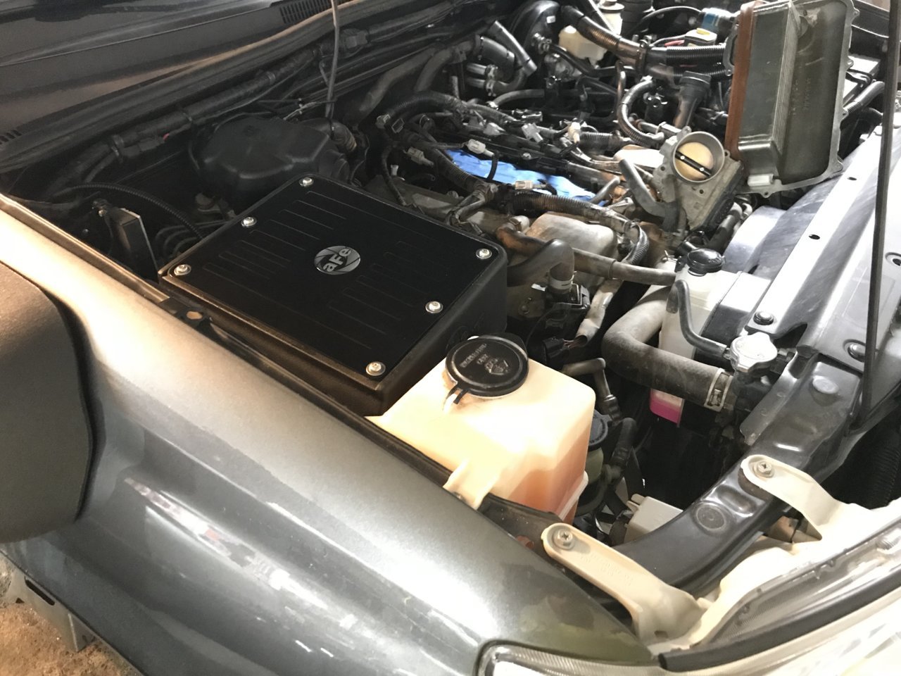

    I should note that the AFE was never meant to protrude through the Fender. It doesn’t line up exactly. It twists the box making the cover hard to install.
    Once the cover is on, it straightens it out, but it’s a bit of work to get it on.

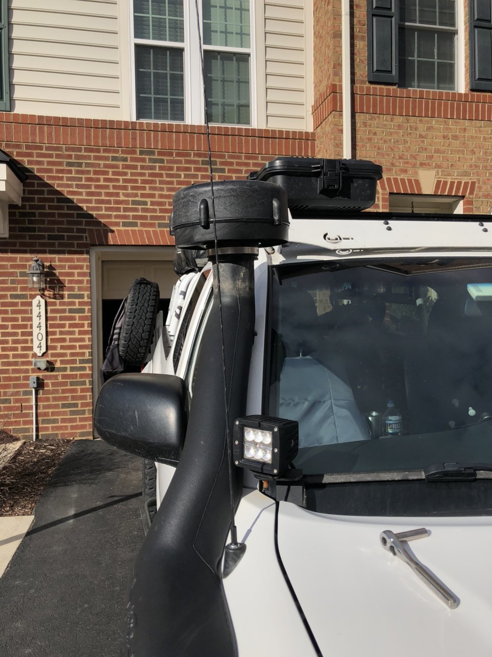

    Yeah, my truck was a trail rig long before the Supercharger. With the 35s and no inner fenders, the snorkel is a must.
    Figure I’ll make it as good as it can be though.

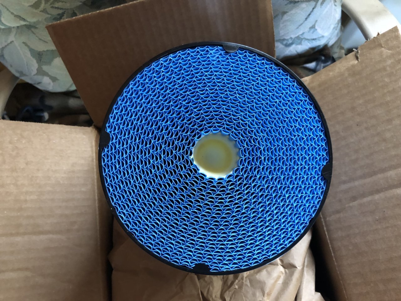

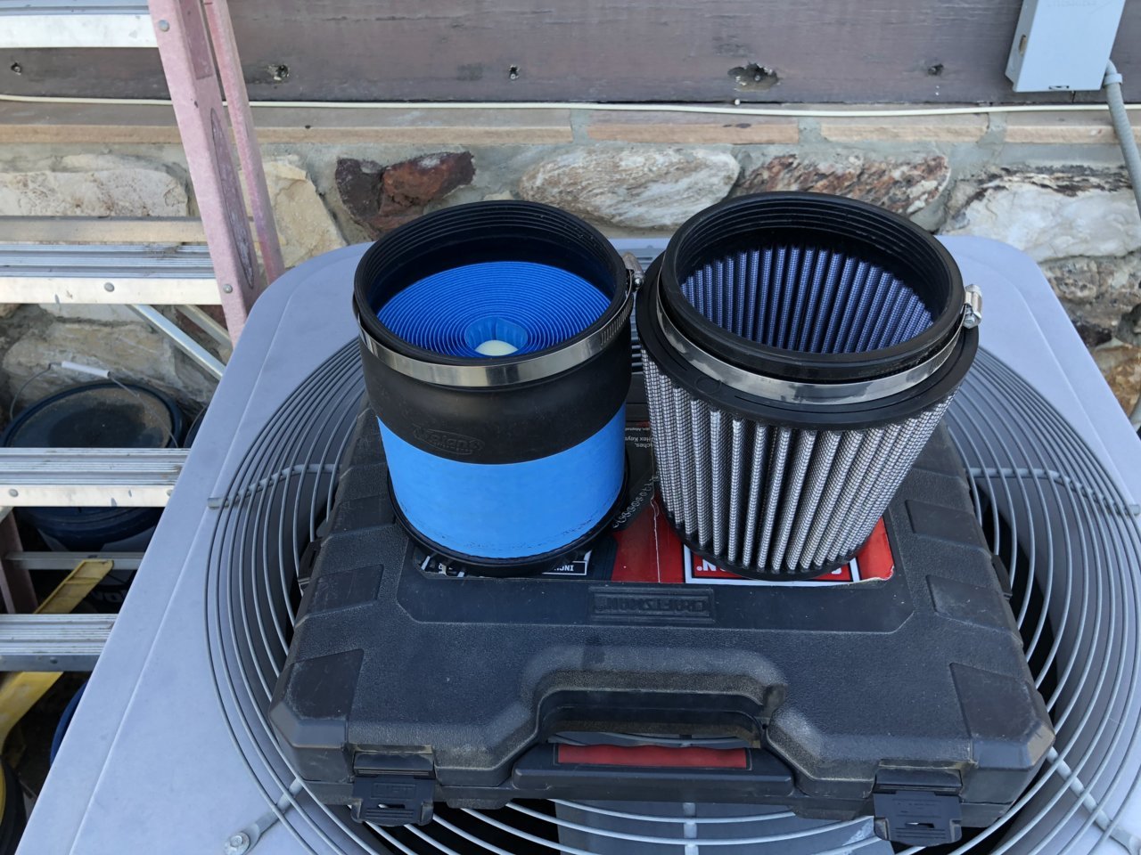

    It’s a filter that will fit with the afe intake. Not to derail too much, but here is a few pics.

    I should note, and I’ll fix it above now, the AFE was never meant to protrude through the Fender. It doesn’t line up exactly. It twists the box making the cover hard to install.

    My box is like this right now. The maf tube was super hard to install, almost as if it’s too long, and it makes instaling the lid highly annoying. I’ve been meaning to trim the tube a bit. You probably will have to as well once you get your 7th injector.

    Yeah, I’m planning on having to trim it.

    Did you get the AFE installed with the snorkel? Any boost issues?
    I've been running the AFE with my SC since new and am thinking about adding a snorkel so wondering how that's working out?

    It’s working out great. I’ve made as much as 12.5 lbs of boost on a cold day. That run translated into roughly 400 HP at the crank.

    When I did mine, I though that I really wasn't gonna like the look. But with the fender on the truck, I can't see it. And it works as intended.
