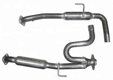

    I think adding the catalytic converter helped tone down the dBs some in my case.

    I had been running URD headers, my y-pipe, 3" cat, Vibrant resonator and numerous different mufflers as well. The Mopar muffler tops them all for quiet flow.

    I wanted to get the stock crossover tube out of harms way and be able to run a full set of skid plates without spacers, so I had the exhaust shop relocate it. They didn't do a great job, and I really want a bolt on solution so that I can swap it out easily if I end up living in a state that inspects. I'm from PA originally, and non-stock exhaust is not passable there in most cases. When we were young my buddies and I would have to swap back to stock exhaust once a year to get a sticker, and then right back to the performance parts after the inspection was over.
    Anyway, I've looked into this quite a bit, and have concluded that if I want ground clearance and skid place compatibility in an off-the-shelf, bolt-on product, it has to be the Doug Thorley Pipe Bomb: https://www.urdusa.com/89227-doug-thorley-tacoma-pipe-bomb-y-pipe-2005-v6/
    I will be installing one in October, and having a local shop weld up the mid-connection per the instructions. The whole thing can then be removed in one piece. It connects to the downstream exhaust at the factory location, and it's stainless. I think some exhaust wrap will also be a good idea where it's close to the transfer case.
    Most of the other options mentioned reduce ground clearance and make the driver-side pipe the first thing that's going to get hit, and they reduce or eliminate the ability to run skids. I'm also not a fan of it going right under the transmission sump where it's going to heat up the transmission fluid, but this could probably be fixed with some wrap.

    Lift the engine. Add a 3/8" - 1/2" shim or spacer between your motor mount and the engine, or your frame and motor mount. After wacking the oil pan on my LS400, I've found that guys do an engine lift by adding a spacer with the engine mount, so the oil pan isn't the lowest part of the car any longer. There's some wiggle room to go 1/2" easily without causing issues and needing to modify everything.
    Since the headers/y-pipe are connected to the engine, and also braced to the transmission, they will also raise with the engine giving more clearance to run mid skid that will protect the exhaust. Raising the engine alone may be enough, or you could also lift the transmission with a spacer between it and the cross member. That will mess with your driveline angles however.

    Damn, so I just came across this post after ordering AFE long tube headers 48-46001-1HC and their y-pipe 48-46006-rc
    https://afepower.com/afe-power-48-4...y-pipe-2-in-to-3-in-409-stainless-steel-w-cat
    Is this same part TacoTuesday1 is referring to? Now I'm concerned about fitment issues. I'm not sure what config "long 6MT RA60F" (TacoTuesday1's) is, mine is an '09 access cab, 4.0L, OR, Manual trans. Couldn't find TacoTuesdays1 original post :confused:
    Also I don't know what other options there are (with cats) for y-pipe if there is indeed a fitment issue. I'd go OEM but it's way too expensive.
