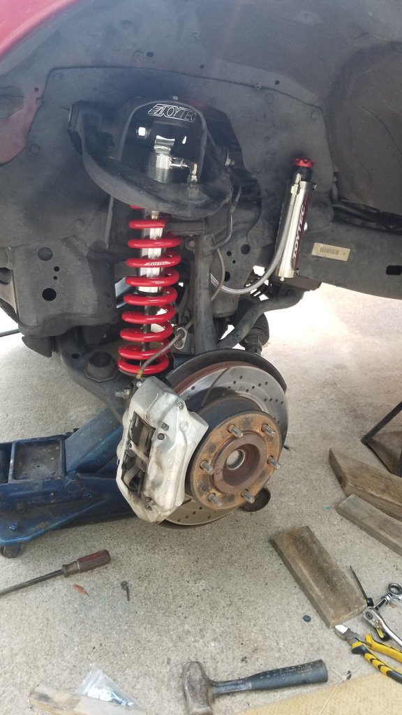

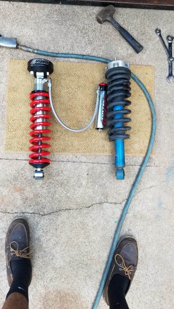

    taco71742
    taco71742 Well-Known Member
    Jul 8, 2017
    #223476
    317
    Daniel
    Woodstock GA
    04 Taco DC 4x4 5spd
    3" Toytec Boss Lift with External reservoir and adjusters Prerunner to 4x4 conversion Manual locking hubs 16x10 w/-38 offset 305/70r16 Toyo RT tire
    I put them on this morning and I've been driving my truck all day. As far as the first day, it's crazy how smooth it is and once you crank up the adjuster it'll get stiffer and you'll be able to tell the significance. I have the 600lb coils because I am doing a 4x4 conversion and I plan on adding a bumper. Once that extra weight is added I'm sure it'll ride like a Cadillac. You won't regret it. My girlfriend was able to tell the difference and she usually doesn't pay attention to the stuff I do to my truck.
