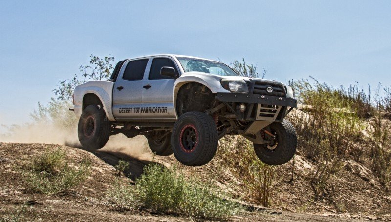

    DTF LT front & rear
    Somebody say go fast? :anonymous:
    :D:D:D
    For $800 Just find some used mid travel parts like I did when all this started lol

    Danm your truck looks better than most girls at my school... I want to ride in it but then I'd really want to upgrade my truck lol
    DTFtacoma[QUOTED] likes this.
