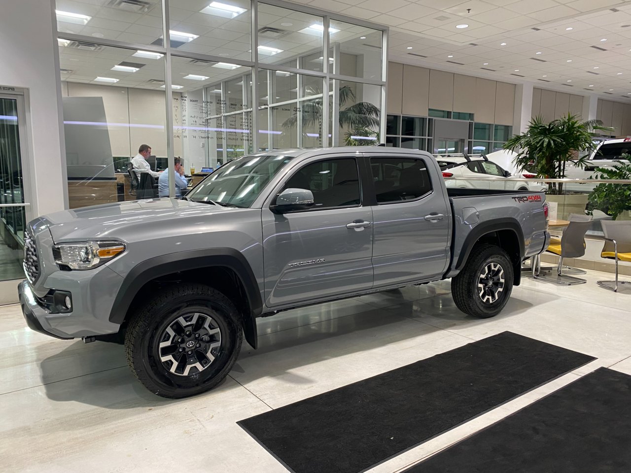

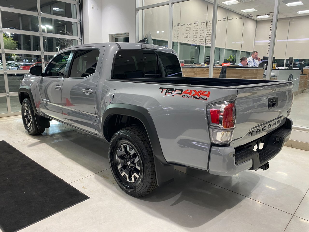

    I’m sure this sounds incredibly familiar and you’re right to believe that the Tacoma fits this profile. It’s quite a good thing that I’ve had my eye on owning a Tacoma since I was in high school. All of these aspects came together to make my decision one of the easiest, most unregretful decisions of my life.
    We’ll start where it all began, the dealership:

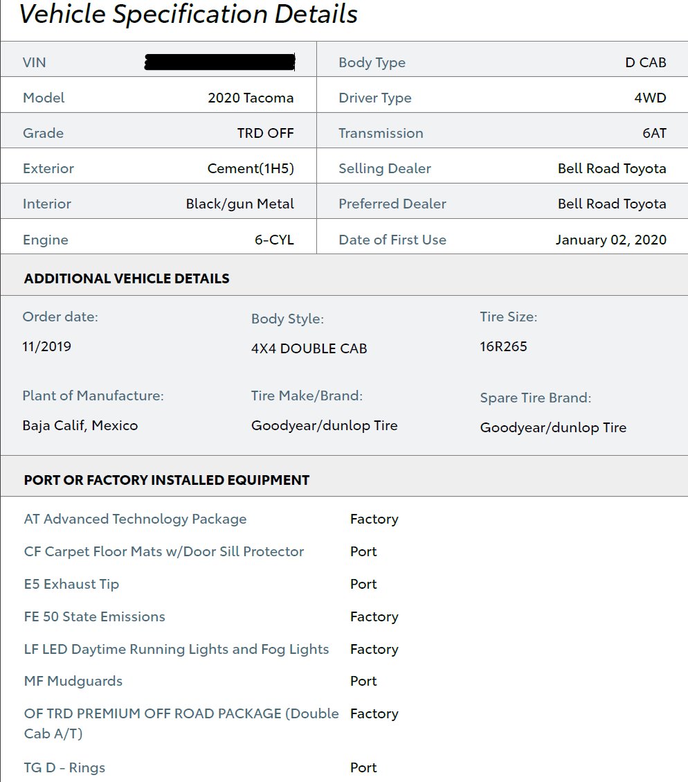

    Stock vehicle specs for those interested:
    Before I went to the dealership, I had done an exponential amount of research (as everyone should) and had known exactly what VIN number I was going to purchase, from color to options, I was sold before I left the house. With this in mind, I took my time there, test drove a few different TRD Off Road's with and without certain features. A question that commonly comes up (and thankfully there's an entire thread for this) is how much you'll pay out the door, at a dealership, with all the typical BS that occurs when trying to buy from them. Knowing how much I was going to pay, when I told the salesman that I was ready to pull the trigger, he drew up the numbers and I was confused because their numbers were much lower than mine, I mean much lower? Sure enough, they almost sold me the wrong VIN, which explained why everything was off. I used this to my advantage and had them take off what I could on the price. Out the door, after taxes, extras, and all the funny biz I paid $44,195.94.
    Obviously, prices differ depending on where you're at in the U.S. but I was happy with my approach and financing. I opted not to include a single "extra" option that I knew I would replace down the line, such as the pro headlights. Knowing that this would be my truck for as long as I could keep it running (forever, it's a Toyota) I wanted to make sure all of the comforts and "necessary" upgrades were there.
    I work in software, project management, and analysis so naturally, I broke my build into phases. Ideally, this should help me plan financially, buy-once-cry-once, and take an impactful approach towards developing (pun intended) a rig and kit that works for me.

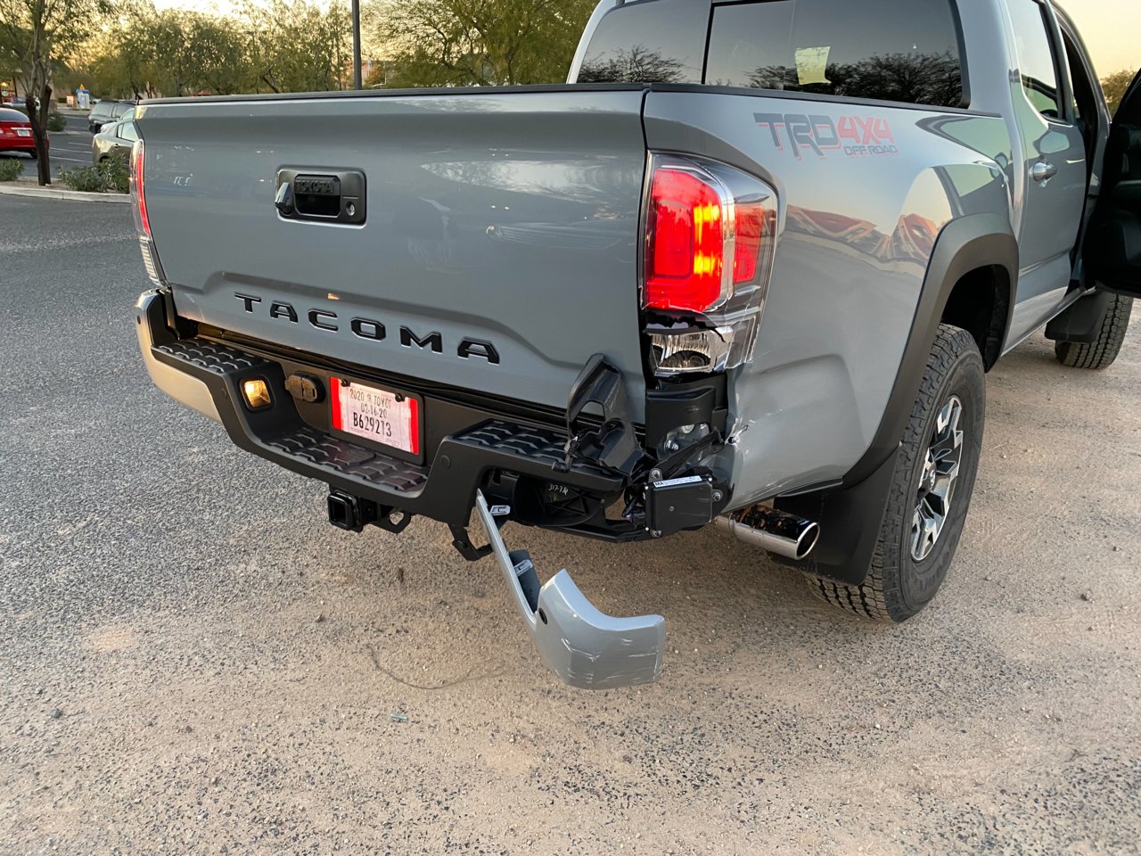

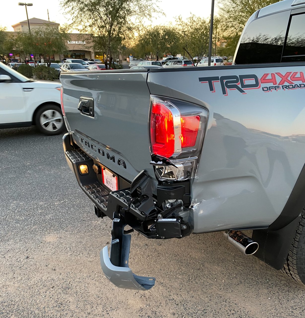

    But...Before I could even get to Phase 1, I was hit by a car. A small, but heartbreaking bump in the road, still had the temp plates on from the dealer.

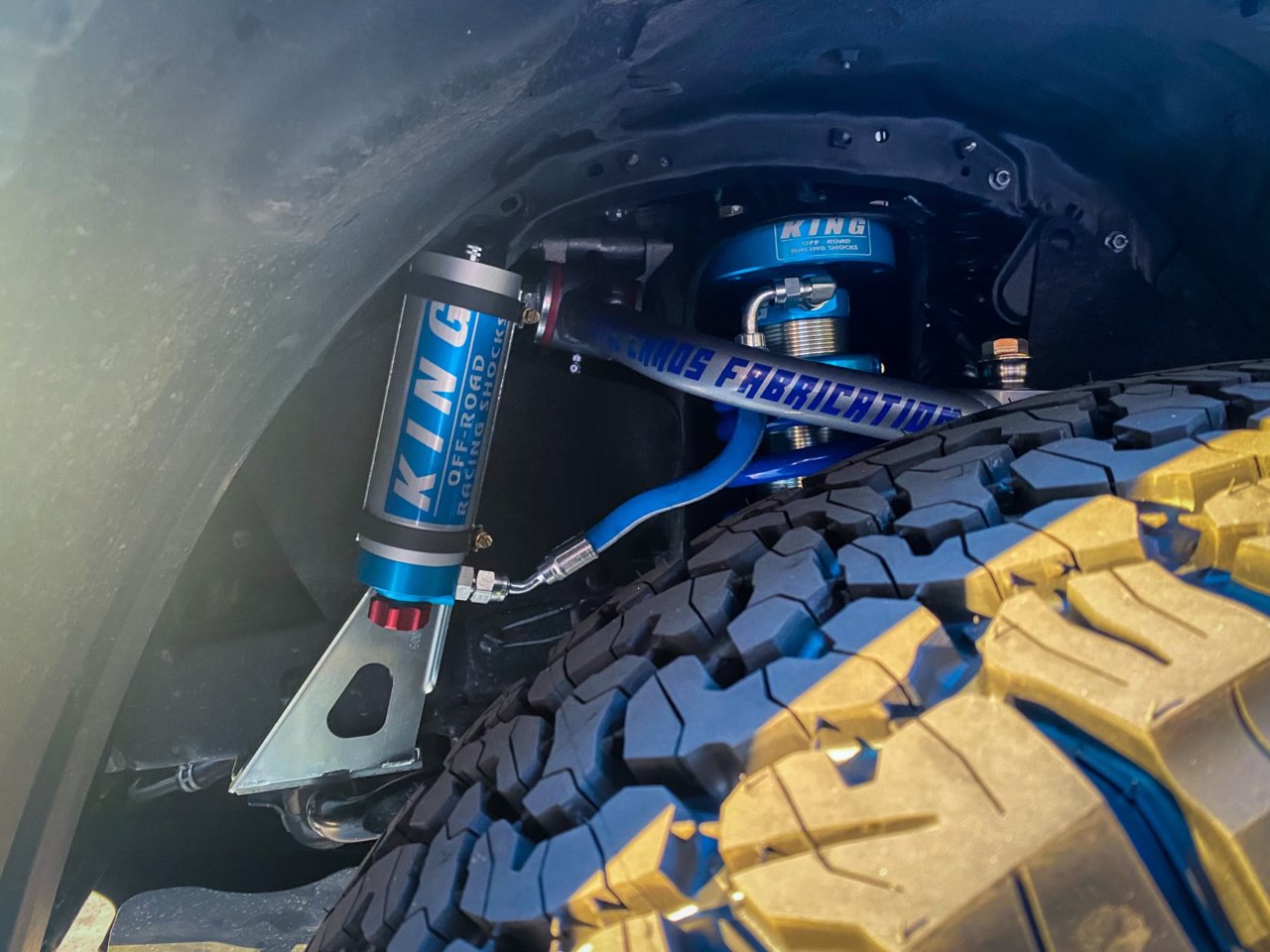

    • King Extended Travel Front Coil Overs w/ Remote Reservoir & King Rear Extended Travel Shocks w/ Remote Reservoir
      • I’ve been a long-time fan of King Shocks, not because I’ve been using them for decades as I haven’t, but because of the relentless quality feedback in different and dynamic applications, from off-roading to bush planes (let me know if you’re as much of a fan of Mike Patey as I am). As they say, once you go King you never go back and this will certainly be the path that I take after my experience with them. It’s important that I mention that although I had preferred Kings as my choice, I still did plenty of research on other brands, primarily Fox, Icon, and OME. I highly suggest you check out this video from Shock Surplus for a solid side-by-side comparison of suspension to help you make a decision on what may be best for you and your application: https://www.youtube.com/watch?v=QKXj0jBenIk&t=1027s

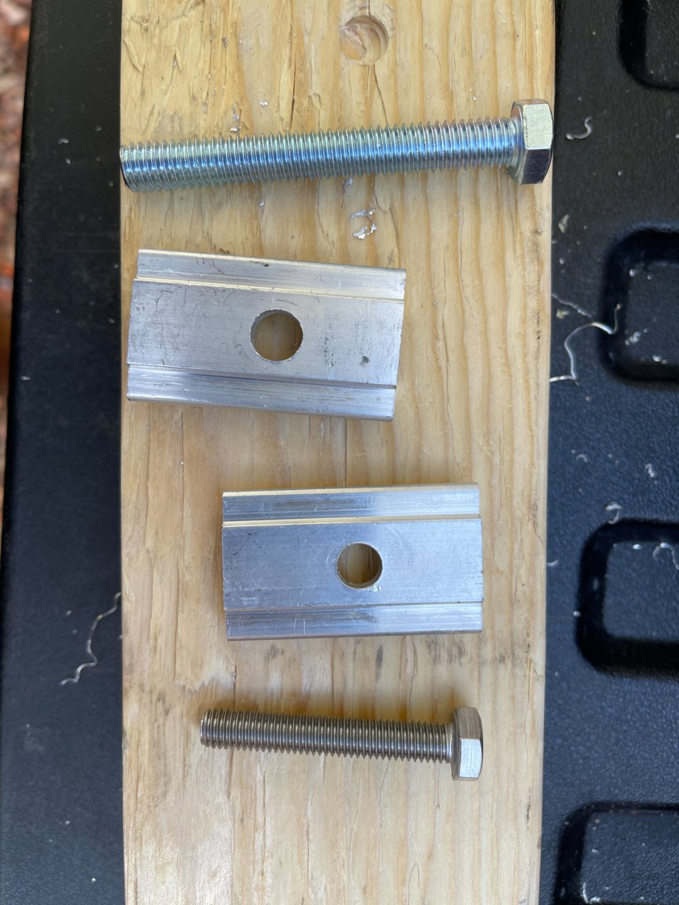

    I wanted to quickly share how I over came an issue when mounting the Vagabond Lite RTT to the RCI bed rack. The hardware provided in the RTT essentially isn't log enough to clear the bars of the rack. To overcome this, I thought I simply just needed longer bolts and then we should be good. Turns out there's another factor:
    The bolt/plate on the bottom are provided in the RTT, too small. The bolt on the top is the hardware that I ended up going with but with a catch.
    All other longer 5/16 bolts (the same size as provided) that I could find at local hardware stores didn't have enough purchase in the channel to be able to tighten down. Obviously a huge issue.
    So what I ended up doing is going up a size to 3/8 bolt and then bore out the plates to match the sizing. This was the result once we went to a bigger bolt and bored out the hole in the mounting plate.
    Much more purchase than what was provided, plus we upgraded to bigger, stronger hardware. After a day of running around, I'd say it was all for the better.

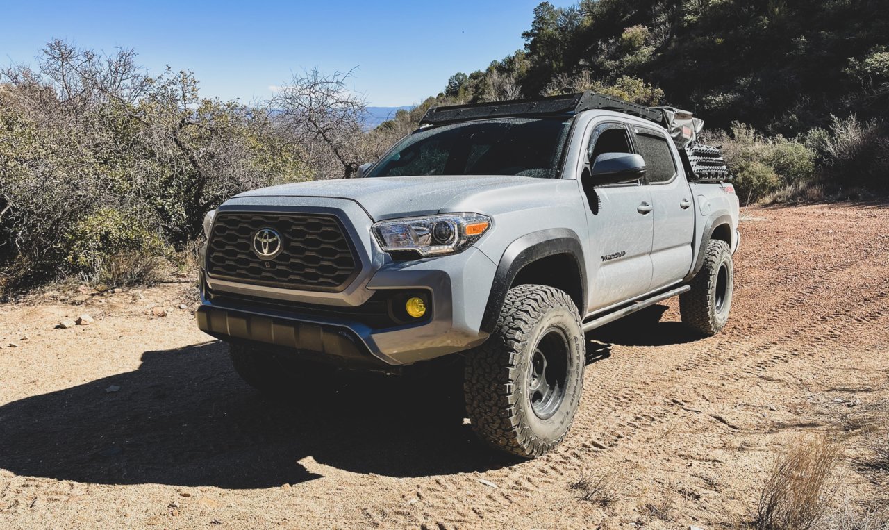

    It has been a while and some things have changed as of late so here's how the Taco currently sits. Hoping to start the process of including and managing lighting options in the near future.
