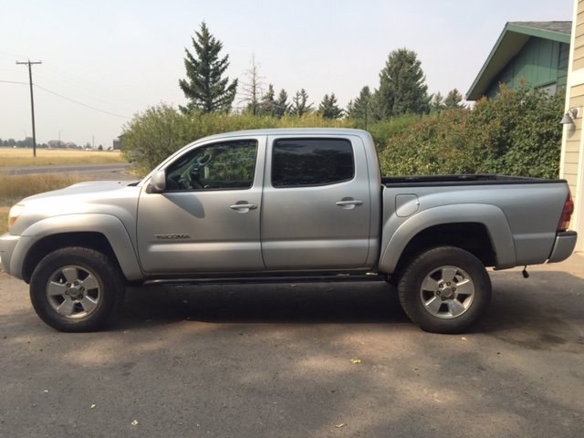

    Just installed an Old Man EMU lift kit and looking to get bigger tires. Need some good affordable control arms and need to level the truck, it sits a lot higher in the back than the front.

  8. Sep 18, 2020 at 10:58 AM
    VLTHNTR77
    VLTHNTR77 Well-Known Member
    May 27, 2016
    #188028
    631
    Andrew
    Everett, WA.
    2016 Inferno TRD off-road
    RCI skid and sliders, GoodYear Ultraterrains, HID's, SCS SR8s, lots of ME-SO goodies, Diamondback HD.
    The back is meant to be higher so that when you load the bed it levels out.
    That way the headlights aren't pointing at the sky when the bed is loaded.
    If you were just going for looks, front spacers and an AAL would have been cheaper.
    4x4cajun likes this.

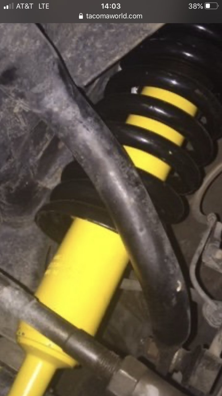

    Did you assemble these yourself? Is that spring perch upside down? Your front is way too low. Something is wrong.

  10. Sep 18, 2020 at 11:05 AM
    tacotruck2005
    tacotruck2005 [OP] Goodolboys 4x4 section
    Sep 3, 2018
    #265116
    119
    Bozeman Mt
    I know trucks do that lift in the back. I got the lift kit for offroad purposes and since I don't really fill up the bed with a heavy load I wanted to level the truck and put 33 tires on.
  11. Sep 18, 2020 at 11:10 AM

    119
    Bozeman Mt
    I had a shop compress the springs with the strut. I did put the lift kit on my self though. I notice that there are one too many leaf springs added.

    #172003
    4,857
    Sunnyvale Trailer Park
    its definitely upside down
    FarmBoyTaco and Bandit[QUOTED] like this.

    Bandit
    Bandit I drive an old man truck
    Jun 15, 2009
    #18486
    1,956
    SC
    2021 TRD OR DC 4x4
    Stock 2021 Tacoma TRD OR ARE V series Camper Shell, RallyArmor mud flaps
    edit: that silver washer looking this is a spacer to help with the Tacoma Lean. That should be on the coilover on the drivers side. Double check it after you have that shop UnF***k the coilovers

  14. Sep 18, 2020 at 11:16 AM
    Bandit
    Jun 15, 2009
    #18486
    1,956
    SC
    2021 TRD OR DC 4x4
    You might have the HD Dakar packs. Post more pics.
  15. Sep 18, 2020 at 11:19 AM
    tacotruck2005
    Sep 3, 2018
    #265116
    119
    Bozeman Mt
    This is why its best to have people check out your build. Time to go yell out the shop that assembled my front suspension.

    3" ToyTec coilovers, JBA UCA's, Bilstein 5100's
    Well doing three in both the front and rear would not level the truck. You’d have the same stance just 3” higher. And as someone mentioned looks like the front coilover was assembled incorrectly.
  18. Sep 18, 2020 at 12:02 PM
    #18
    tacotruck2005
    Sep 3, 2018
    #265116
    119
    Bozeman Mt
    I think I will just level the front with the level kit, but I don't really like the idea of spacers. Ya, the shop is going to have to fix their mistake.
