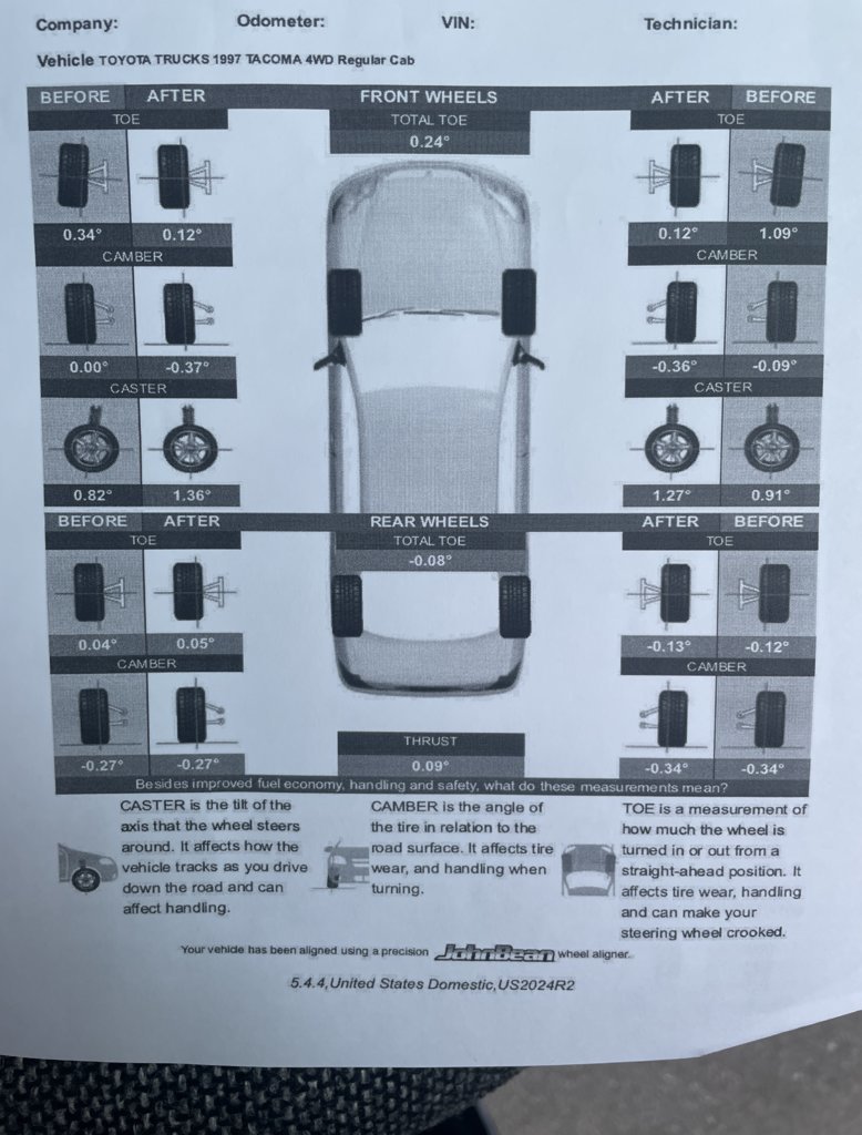

    I can try to post pics of the alignment sheet and steering wheel, but i noticed that my truck drives straight, but the steering wheel is slightly tilted one way... in a perfect world the steering wheel should be striaght. but now when its straight, the truck will turn to the right. Again, if i let my hand off the wheel, the truck will drive relatively straight, but the steering wheel isnt.
    Any idea whats causing this?

    466
    98 Tacoma
    i had a strange suspicion that they didnt adjust the tie rods because my old marks from an old alignemnt were still painted on there and didnt see new paint marks

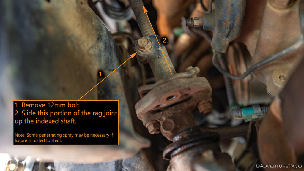

    Your problem is how the rag joint/intermediate shaft joint (connection for the steering wheel to the steering rack) meets the top of the steering rack. Certainly doesn’t sound like it’s slop in the steering but the steering wheel being off center.
    Park the truck, get your wheels as close to straight as possible, loosen the bolt holding the rag joint to the steering rack and slip it upward away from the steering rack (making it so movement of the steering wheel doesn’t engage the steering rack), then turn the steering wheel to dead center, reconnect the rag joint (which now turned ever slightly) to the steering rack and you’re done. I had to do this after replacing my steering rack and getting an alignment.
    See where Adventure Taco discusses the rag slip joint. Step #2.
    https://adventuretaco.com/guide/replacing-the-steering-rack-on-a-1st-gen-tacoma-or-3rd-gen-4runner/Step-by-Step: Replacing the Steering Rack on a 1st Gen Tacoma (or 3rd Gen 4Runner) – AdventureTaco

    98 Tacoma
    how does this look?

    2001 prerunner doublecab limited
    2001 with; cat-back side-swept twin exhaust, elbow mod, Westin bullbar with Hella 450 driving lights, Snugtop XTR camper shell, TRD off-road 2x4-black beauty.
    They NEVER get the wheel straight, in my experience. I learned here in TW, to adjust the tie rods equally, in small increments, as follows: to move the wheel to center when it's tilted left, turn the tie rod adjusters equally towards the driver side. If the wheel is tilted towards the right, do it towards the passenger side. I do this myself now with two monkey wrenches, moving those adjusters 1/4 turn at a time and making sure they are always equal moves on both sides, as I don't want to get lost on that. It worked perfectly.
    A lot of times, the tech will tend to align the wheel with the stalks (directionals/wipers) which are slightly off-center-left, which makes your wheel the same. I've concluded this, as my wheel is always slightly off to left after every alignment I get, and the wheel is perfectly lined with the stalks! True straight, to my eyes, lines up with the straight-lined bottom of the instrument cluster pod. Hope this helps you.
