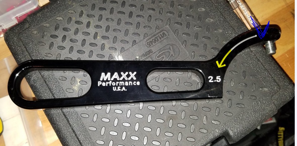

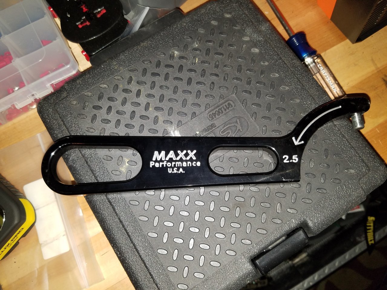

    I bought an aluminum spanner wrench and broke it pretty quick lol the punch tool only works when its in the right position, but I saw another member who cut the end of another punch off and stuck just the tip into the holes then used a socket extension and hammer to tap the collar around until the tool would reach the hole again.

    I was an idiot and did not realize the tool only works in 1 direction. This is where I broke mine

    if you use the one from King, the tip is angled. This allows you to get the punch into position almost no matter what.

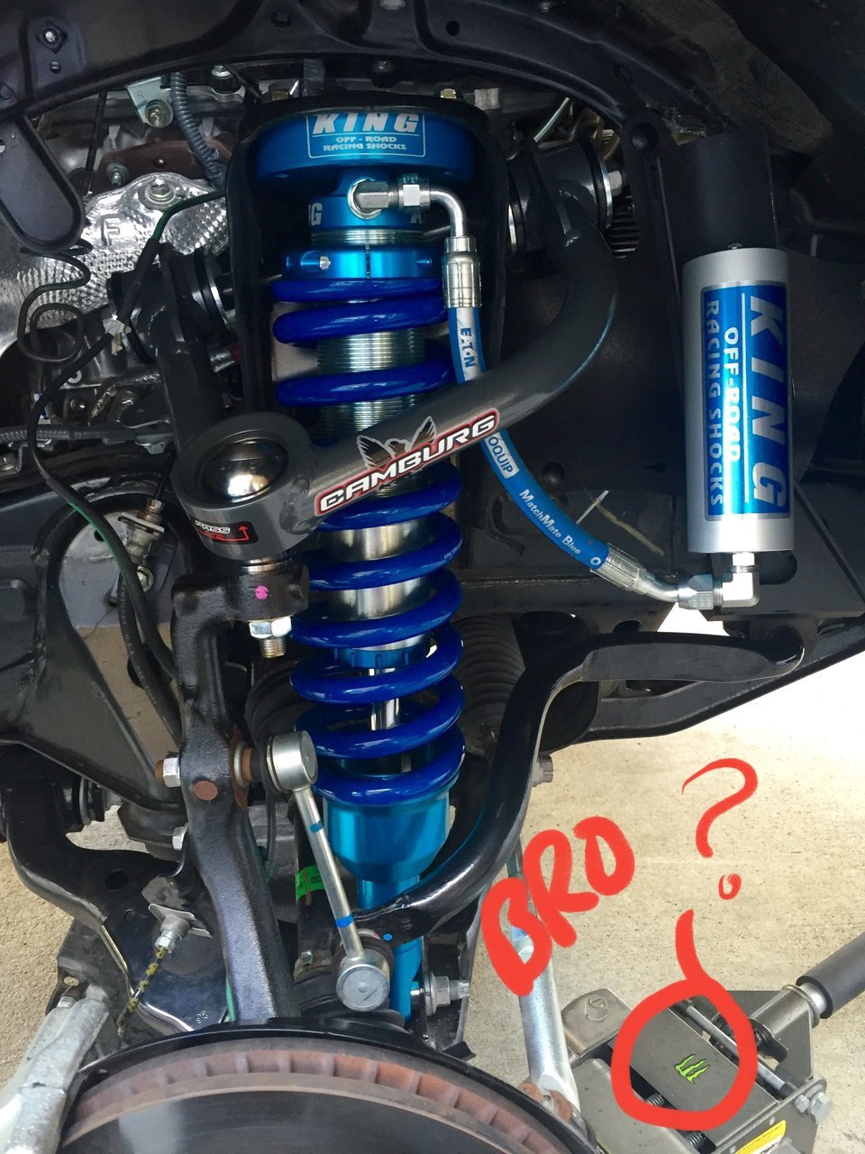

    That jack Bro Certified?
