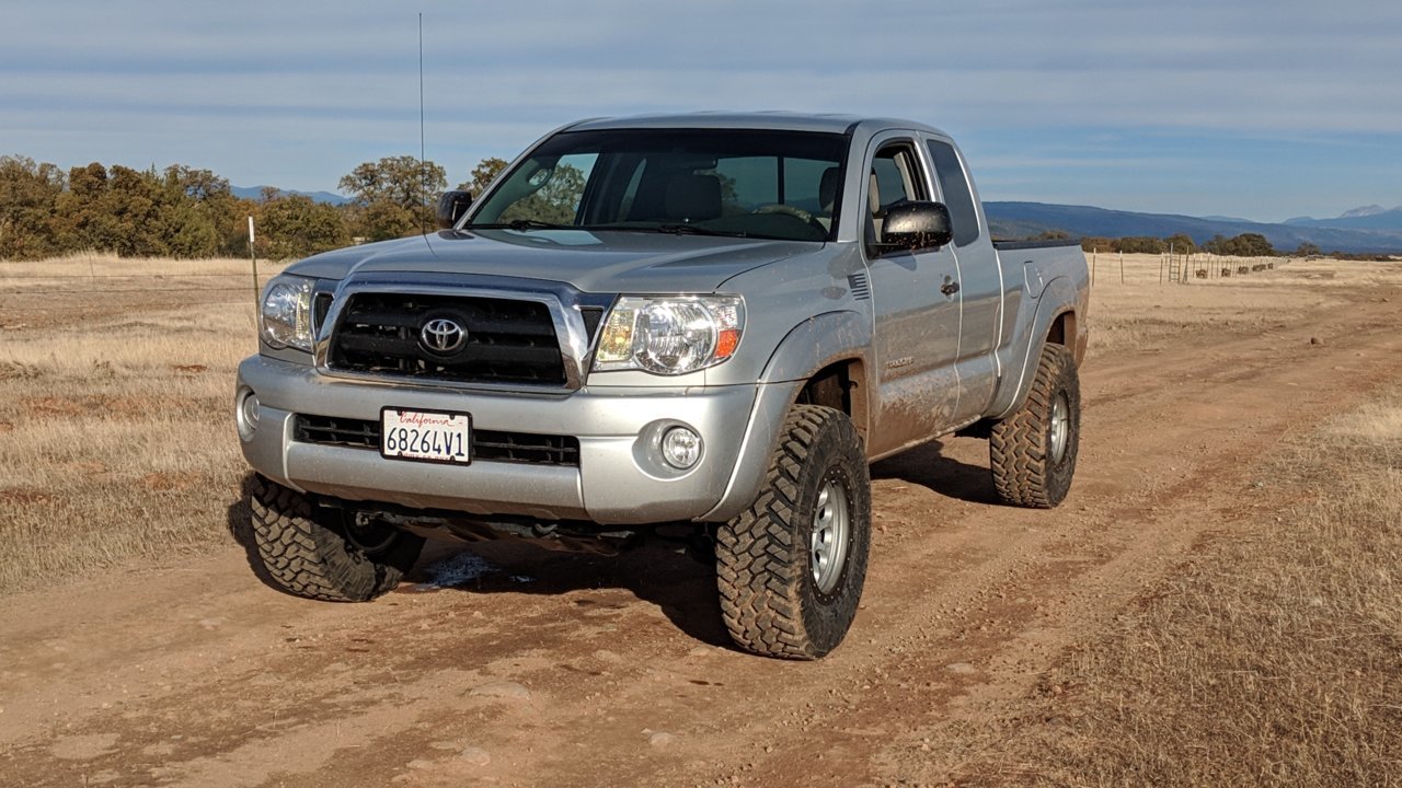

    I don't know if it's possible but I'd see if they'll remove it. Get a refund on it and buy some Bilstein 5100s, have a shop install them. I have a 2nd gen but here's what mine looks like with them. No rear lift. These shocks are roughly $350 if you do both the front and back, but you can get just the fronts for about $200. They improve your ride quality and are a better quality alternative to a spacer lift.
