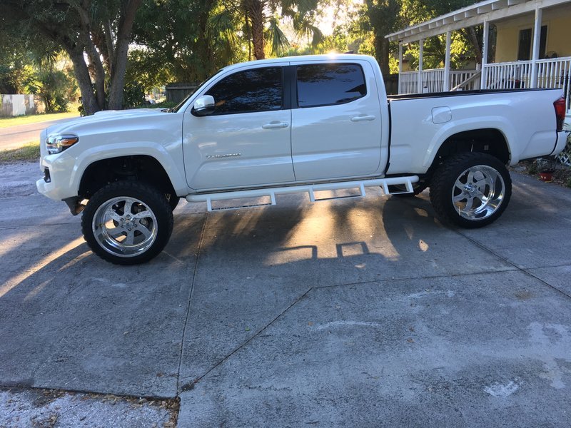

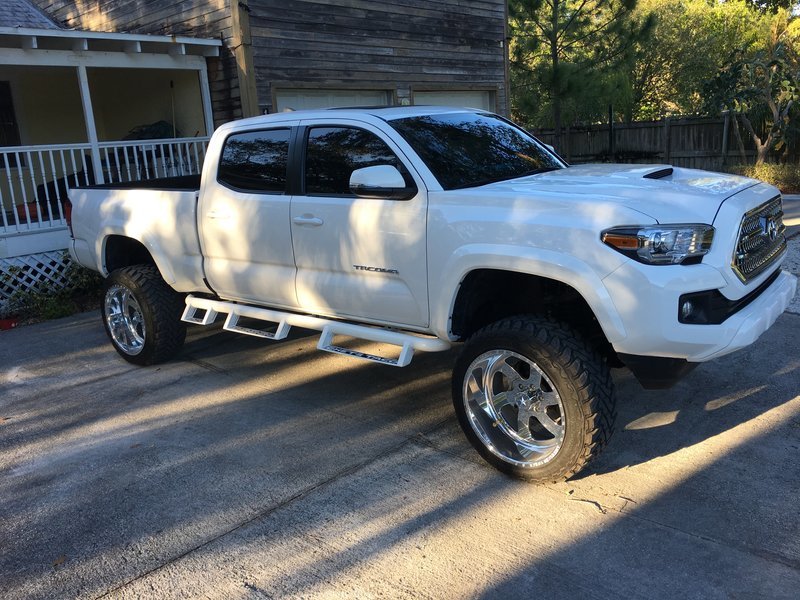

    Had the same issue on this
    IMG_0756.jpg What we did was hook my traction control switch up so each time I start the truck it's off. Whenever I would make a left or right turns ABS would engage the times traction control whenever I would make a left or right turns ABS would engage the times traction control would engage at times I would lose power to my truck. No longer now it's fixed I love driving my truck

    VSC needs recalibrated, even my 11 and 15 did this with a 3'' lift on exit ramps, no biggy. Good luck with dealer.

    Vsc was recalibrated no fix for me
