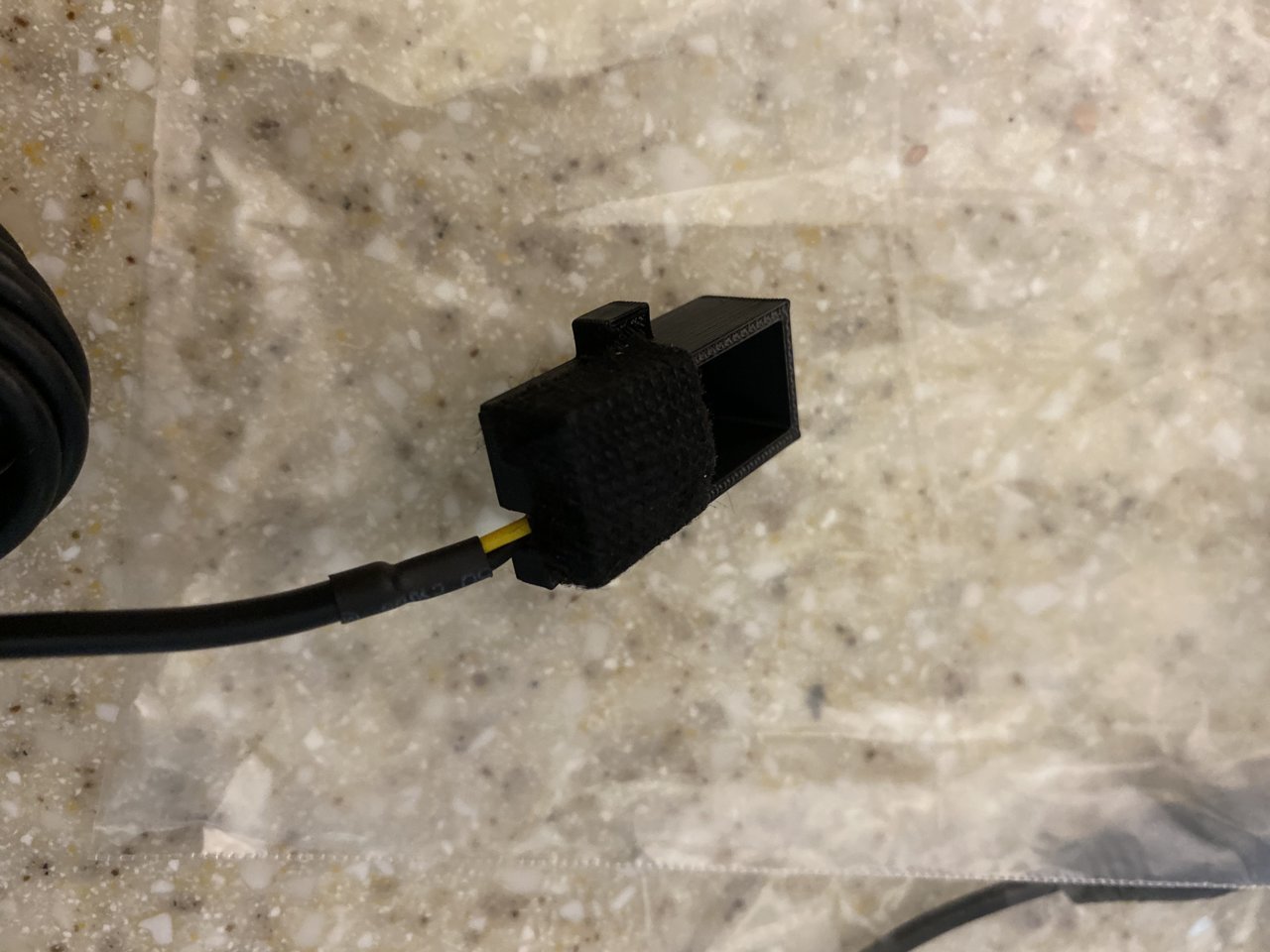

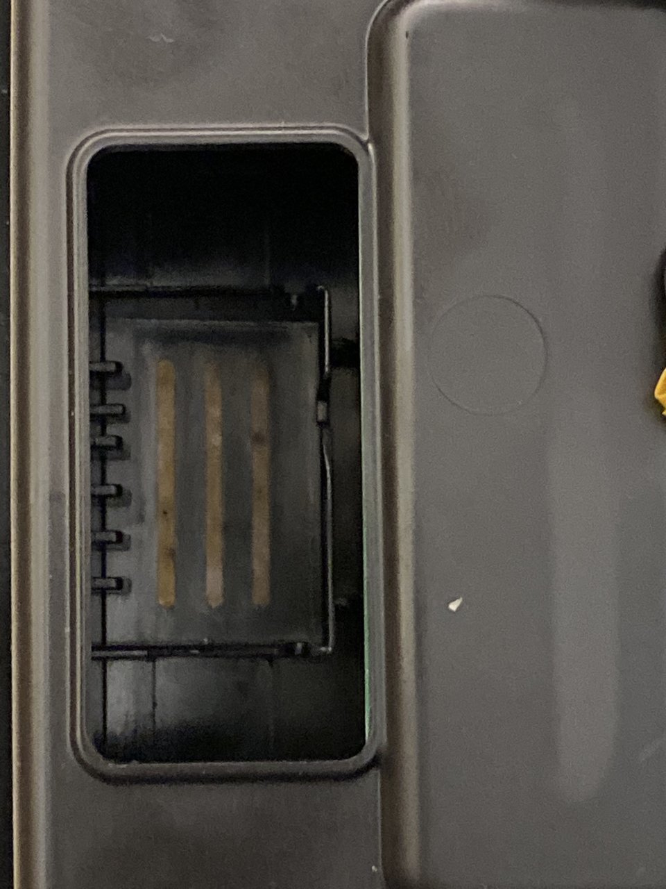

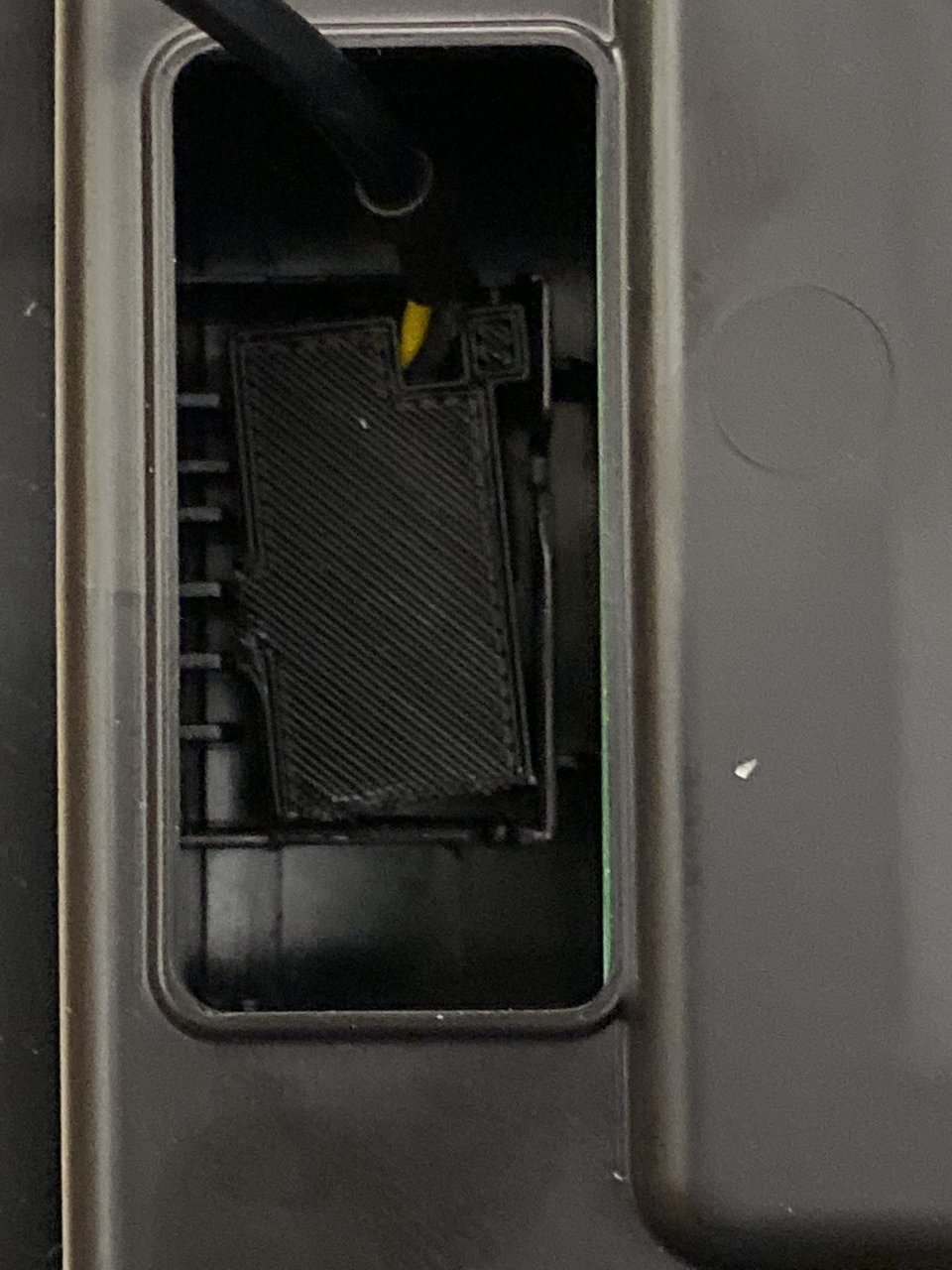

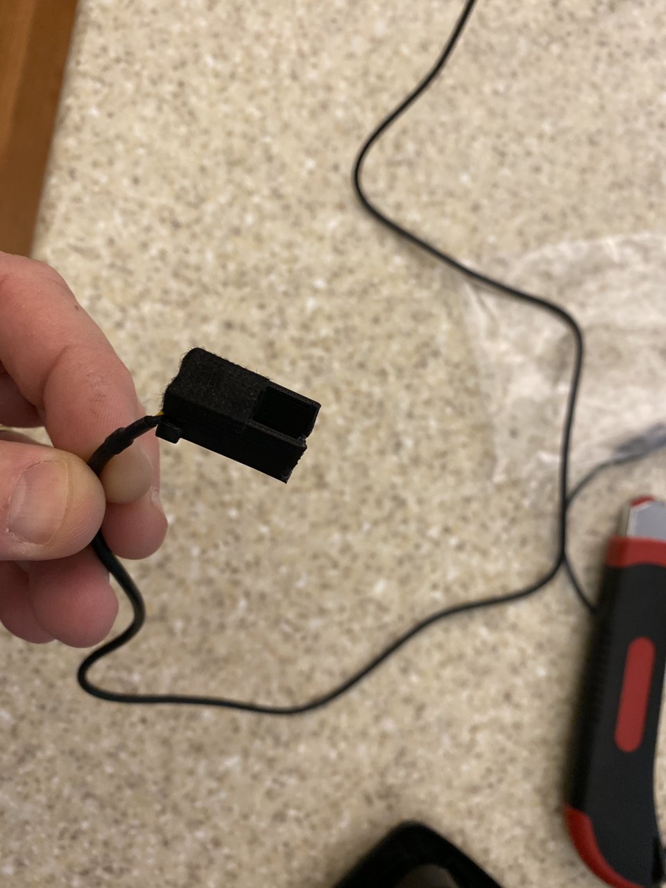

    After looking around, I almost gave up looking for a microphone replacement, for my aftermarket head unit, which fit in the factory location on a gen 3 taco. Then I found a video for a replacement mic that fit my Jetta. After getting it, I realized this would probably fit my taco with very little modification.
    So here ya go....enfigcarstereo.com. SKU - ENFIG_MIC_VW1 It comes as a standard 3.5mm mono pole mic plug. They also sell a 3.5mm to 2.5mm adapter if you need it for your head unit.

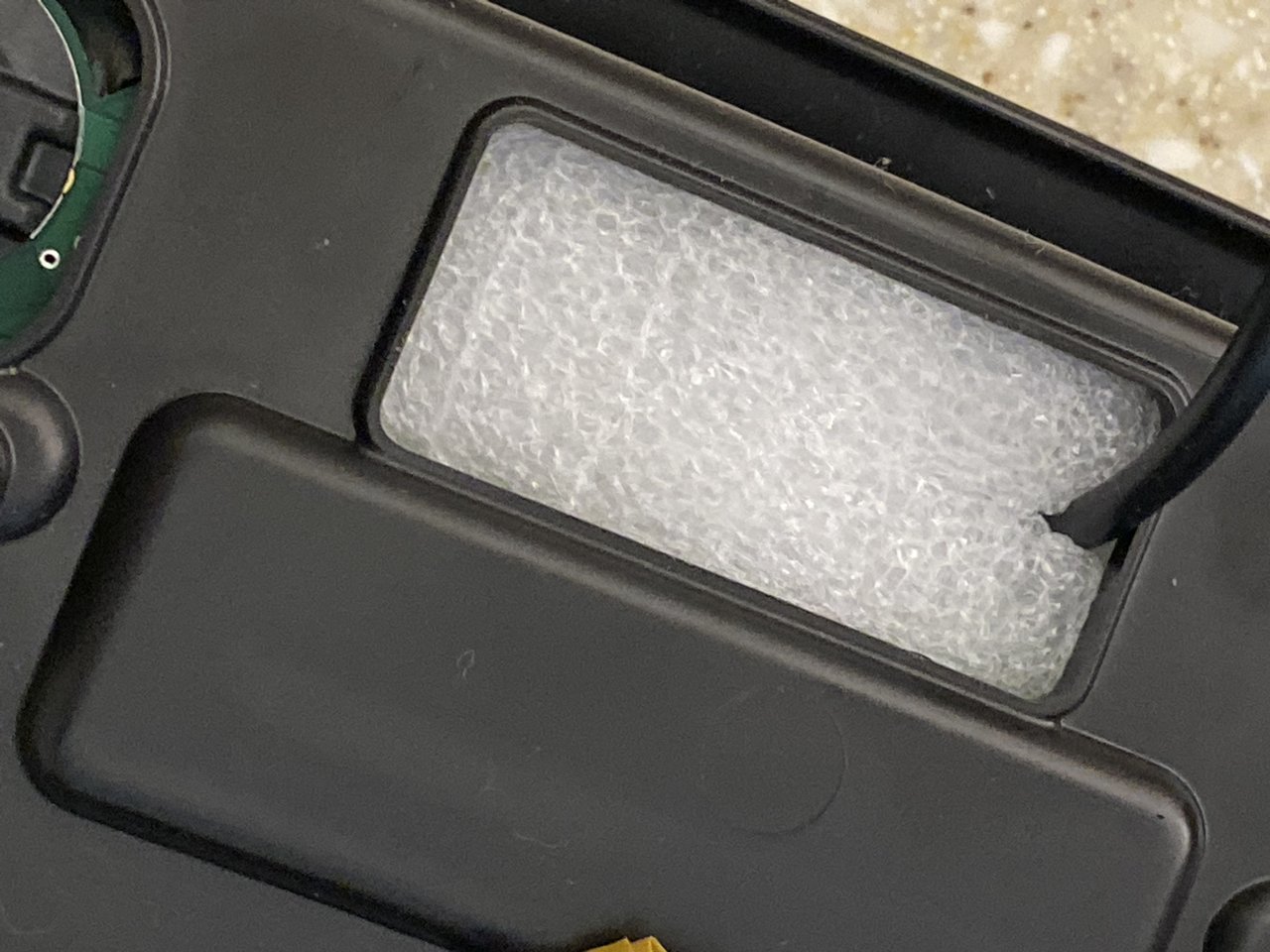

    Once I had the mic trimmed to fit in the slot, I back filled it with poly batting and closed cell foam to remove any chance of picking up road noise from the back hand side.
    The microphone is a little expensive, but it comes prebuild with more than sufficent cable to run across the roof and down either A pillar and over to the head unit.

    +1, just installed this Enfig mic, in the same manner the OP did. I did add electical tape to cover the top of the opening where the modded Enfig mic drops into the OEM spot, filled with polyfil and same closed cell foam as OP and then covered the housing opening with electrical tape. So far it sounds much better as I was only using the built in mic on the front of my Dasaita Android HU.
