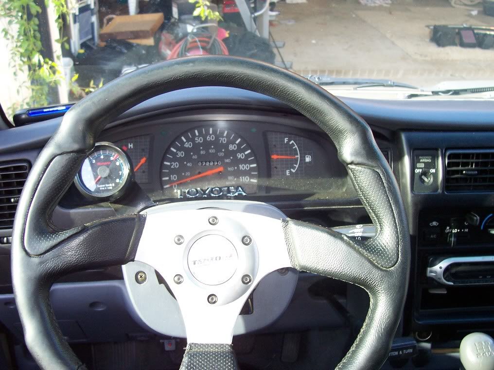

    i have an aftermarket wheel and i love it. find one that you like and buy a hub to mount it. its easy to install, just need a steering wheel puller.

    mine is a MOMO made for pre-tacoma toyota trucks, but its the same as a tacoma. but it only fits 6 hole wheels, like sparco, momo, etc...

    its a 2000. no check engine light, but the airbag light goes on. i just unplugged the srs module and it got rid of the light.

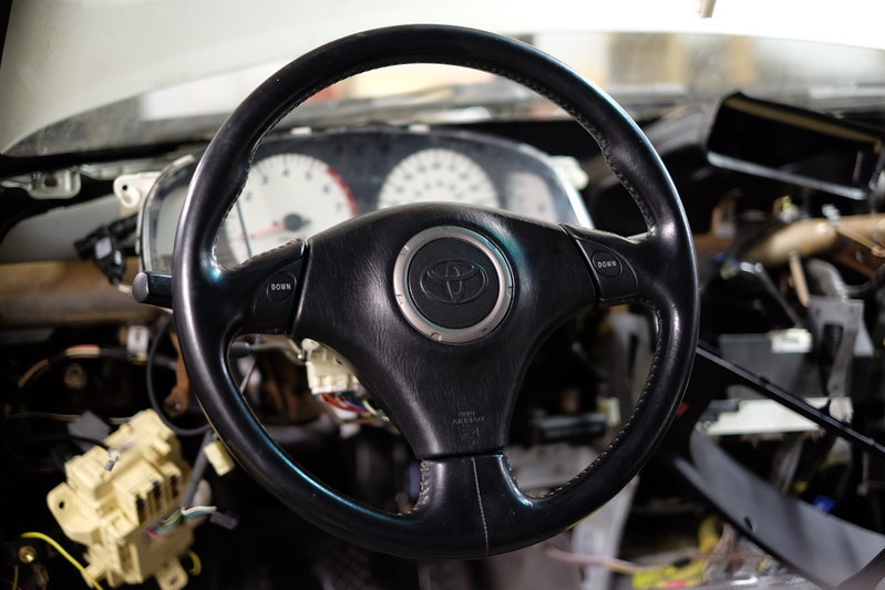

    I wanted a better steering wheel for my '02, a sporty black leather 3-spoker. I also wanted to keep the air bag. Taco TD came up with the best solution . . . IS300 steering wheel with a RAV4 bag. Best of all it looks OEM, the look I wanted.

    Any is300 wheel, 01-05. Any RAV4 bag, 01-03.

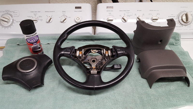

    I'm set for the sport steering wheel conversion . . . less than $200 in parts. The column covers were a purchase option. I wanted a second set of covers to paint satin black to match the steering wheel. I'll keep the originals as is just in case I ever want to revert back.
