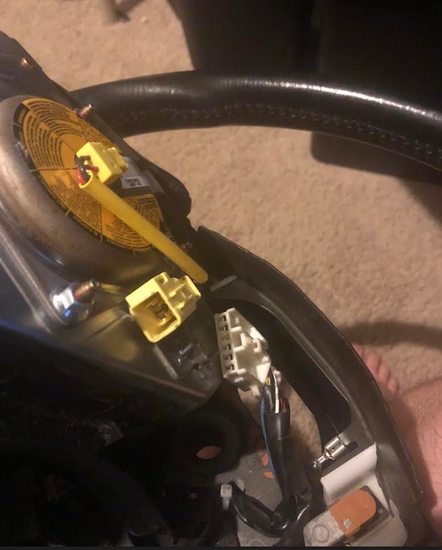

    Grabbed a IS300 wheel and rav4 airbag but I think i'm missing something here, lol... I guess the yellow plug is for the clock spring that's still in the truck, but whats the white one for?
    Sorry if this is stupid I haven't taken apart the stock one yet
    Also, anyone happen to know the part # for the two bolts on either side that hold the airbag in place? Neither came with 'em

    Could the white plug be for the button shifters if you got an Auto IS300 steering wheel?

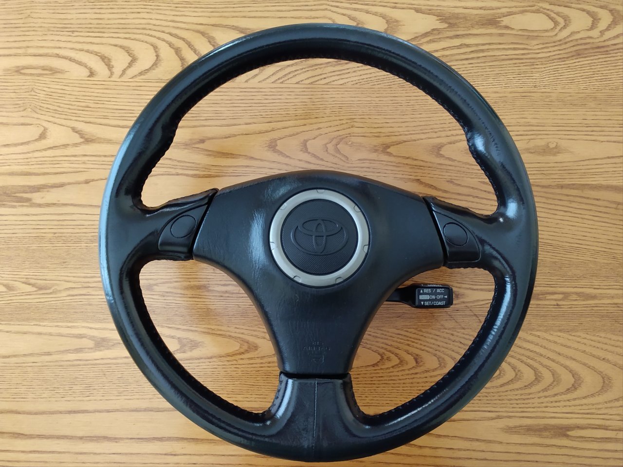

    This and cruise control. I snipped the wires going to the buttons and did my best to disguise them. I think they turned out pretty good. IMG_20190727_104235506.jpg
    Plug and play for 01+ trucks. No issue with cruise control or the Rav4 airbag not working or throwing an SRS light.

    The back ones I covered with Bondo and made them look like they didnt exist. The front ones I JB welded so that they couldnt be pressed and painted them. Looks like any other unused switch blank.
