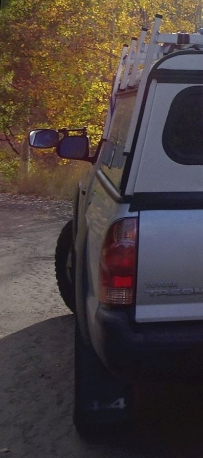

    Looking for electrified tow mirrors for a 23 Tacoma that do not stick way way out and impede entry to carport. Like to upgrade to turn signals for safety.
    Previously used clamp-ons (sandpaper needed to keep from slipping plastic-to-plastic clamp) and looking for a permanent solution. One clamp-on and one lens DOA on bumps and windstorms.
    The OEM mirrors extend 12" from face of window.
    Bought no-name #186480 from Topgear Autosport (WARNING TERRIBLE REP COMPANY) which are "TO FIT"... only they stick out 20.5" each side while retracted. Might as well strap on a stepladder sideways.
    Trying to return them....
    Found another mirror at Boost Auto Parts (a real person on the phone. Yay) that purportedly sticks out 16"... not as bad.
    I see OEM tow mirrors for Tundras but no Tacomas.
    What have folks found that works, fits, and is not enormous?
