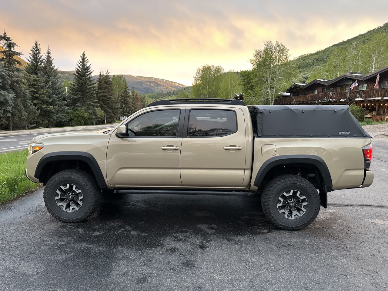

  5. Jun 4, 2023 at 6:05 PM
    HighCountryTacoma
    HighCountryTacoma Well-Known Member
    May 16, 2017
    #219192
    1,996
    Colorado
    2017 DCSB TRD Off Road Quicksand
    I just did mine at 11/9 and 650# spring. Rides firm but nice.

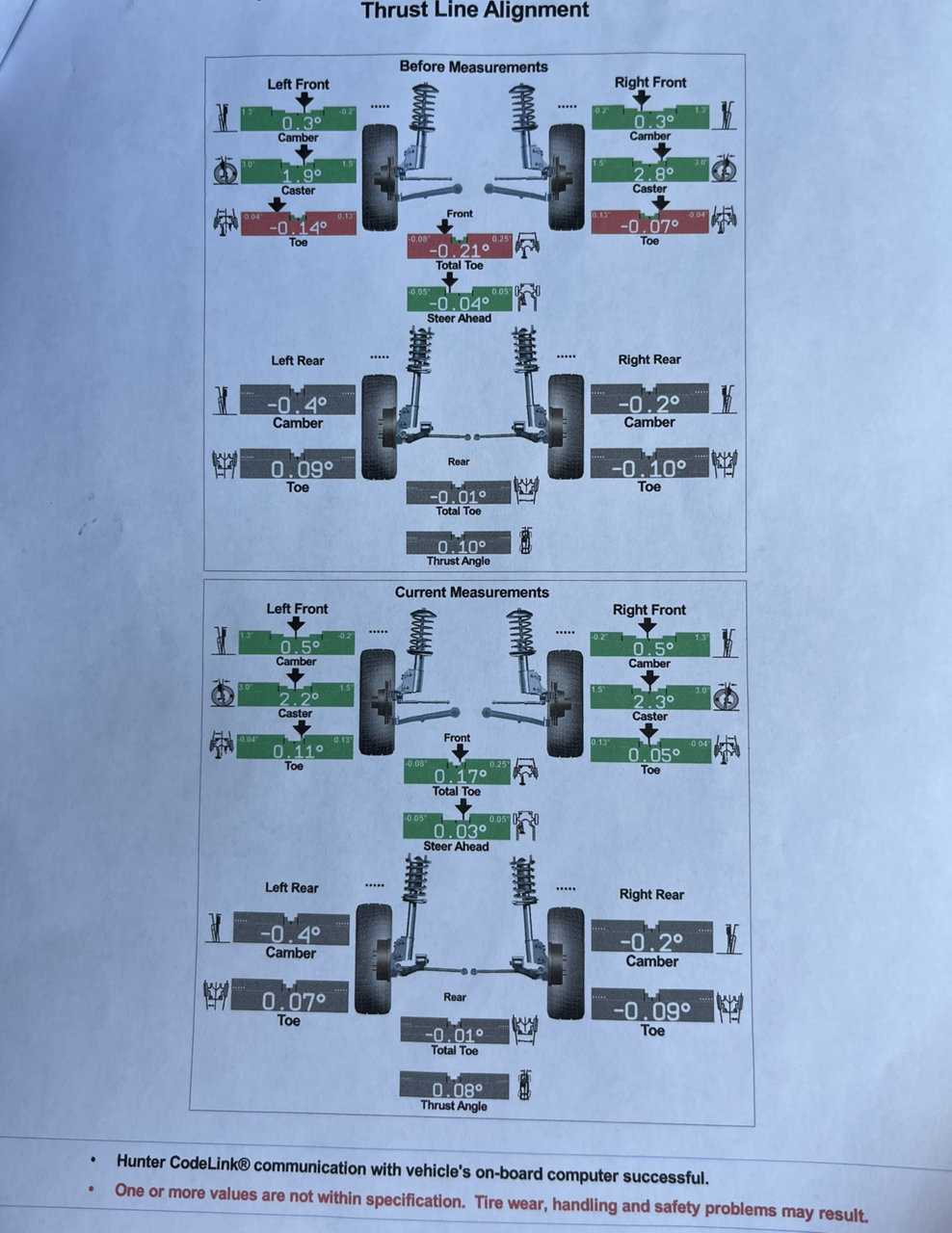

  9. Jun 4, 2023 at 6:14 PM
    Halloween
    Halloween Well-Known Member
    Nov 8, 2022
    #410220
    522
    Steve
    Toyotas a plenty
    Take it to a true (reputable) 4x4 shop. I’m on 285’s. Suspension adjusted to “no taco lean” and I’m straight as an arrow

  12. Jun 4, 2023 at 8:34 PM
    lilsmallz77
    lilsmallz77 [OP] Member
    May 11, 2023
    #424438
    19
    @Halloween thanks for the Alignment specs I live in Eureka CA we don’t really have reputable shops here that’s why I’m stressing but I noticed your in Eibach what setting are you on?
  13. Jun 4, 2023 at 9:04 PM
    HighCountryTacoma
    May 16, 2017
    #219192
    1,996
    Colorado
    I thought you meant level driver to passenger side in your earlier post. You will most likely be front high at 11/9 without lifting the back.
