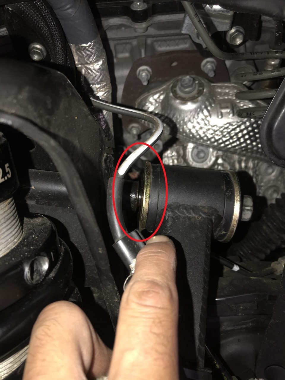

    Question to people running aftermarket UCA's.
    I have been chasing a clunking noise when turning the wheel back and fourth while parked. Noticed the UCA's has some movement. Went to tighten the UCA nut and noticed it was pretty loose and did not have any drag.
    The Nyloc feature was worn out.
    When I removed the suspect nuts i noticed that there is a gap that opens up in between the frame and UCA.
    Has anyone seen this condition when installing aftermarket UCA's?
    • Condition exists on both sides.
    • Gap closes when torqued
    • ~1/8" GAP

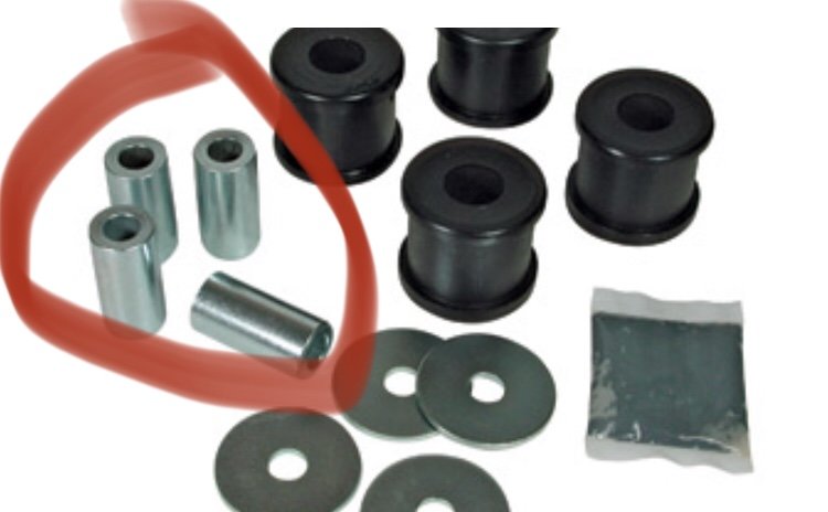

    You should have metal spacers in those rubber bushings that attach the uca to the frame...with a gap I would suspect yours are too short, missing a spacer or the washers are the wrong ones. It should be snug before you apply any torque.

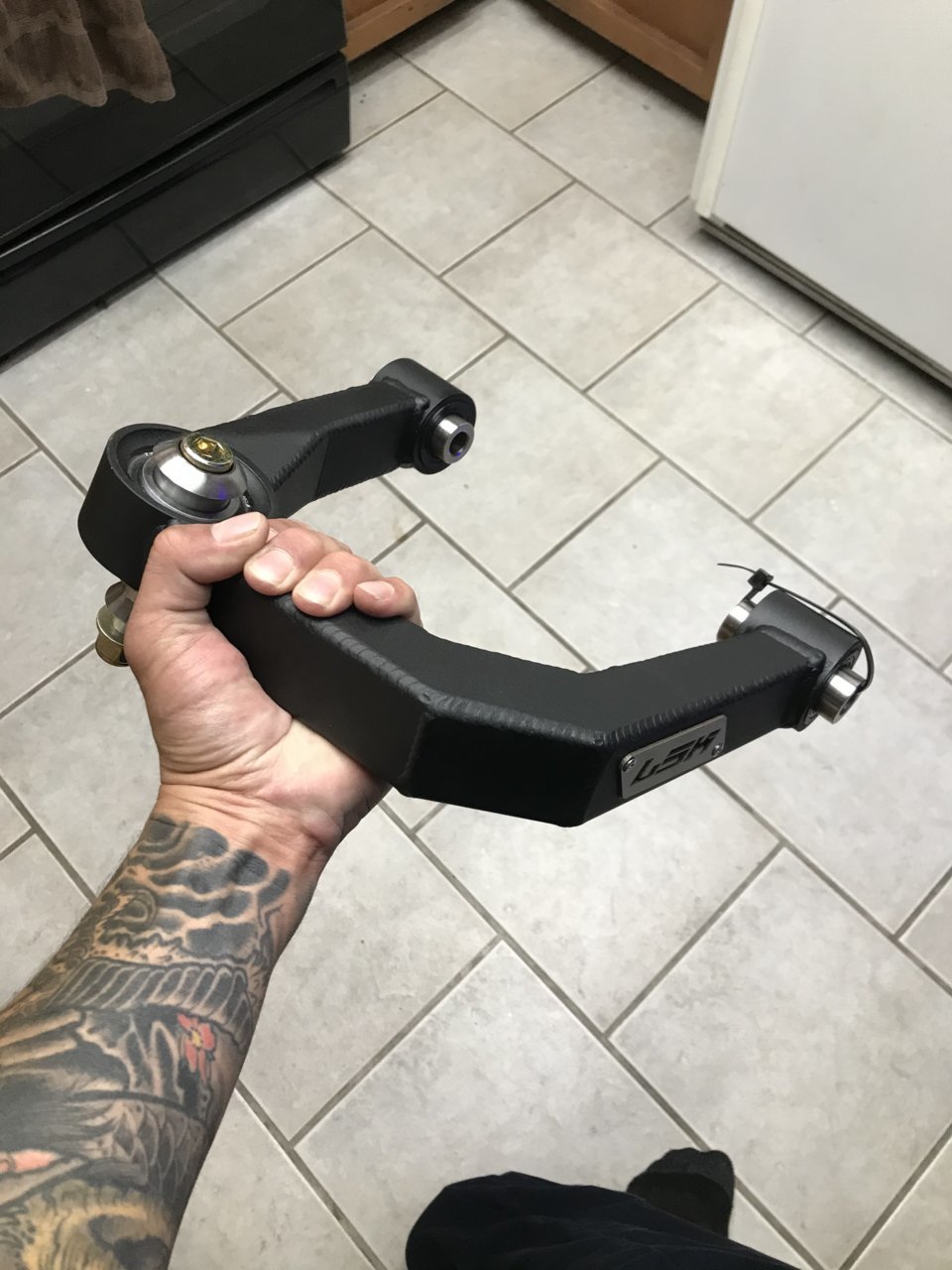

    Apparently LSK had issues with their earlier produced UCAs. If anyone is running their UCAs and they notice this defect. Contact them and see if you can work out a replacement.
    New arms arrived yesterday.

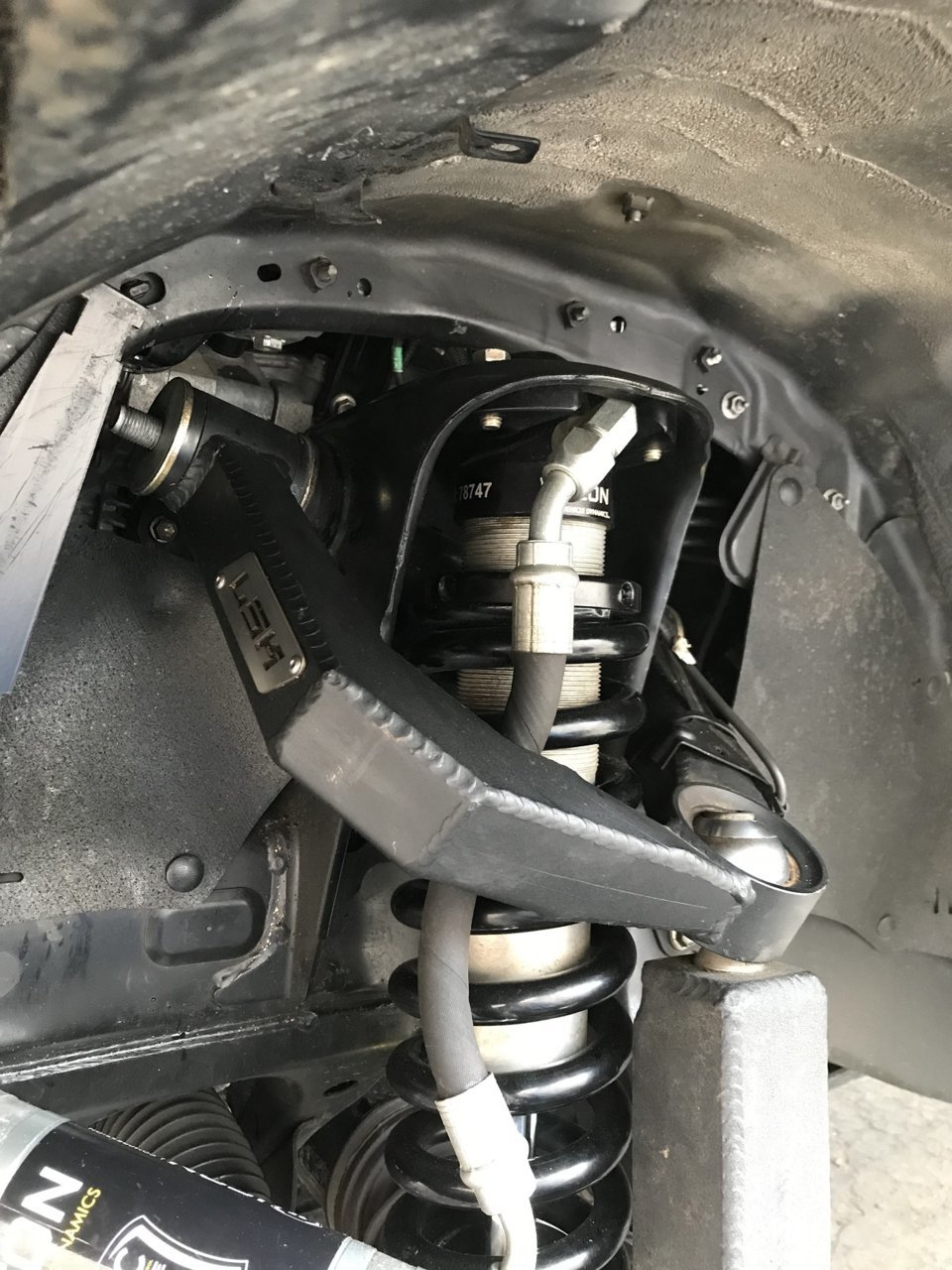

    @Ez2typethis I see you have the newer sealed uppers from LSK. Did you use washers like you would normally use on tradition bushing type? Or did you have source something with a. Smaller OD it did you just not use washers at all? Also, if it makes a difference, I plan to have their UCA mount gussets installed too.

    They didn't seem to have any forward to aft play when I put them up. So I didn't use any washers. Not sure how the gussets will change that up though.
