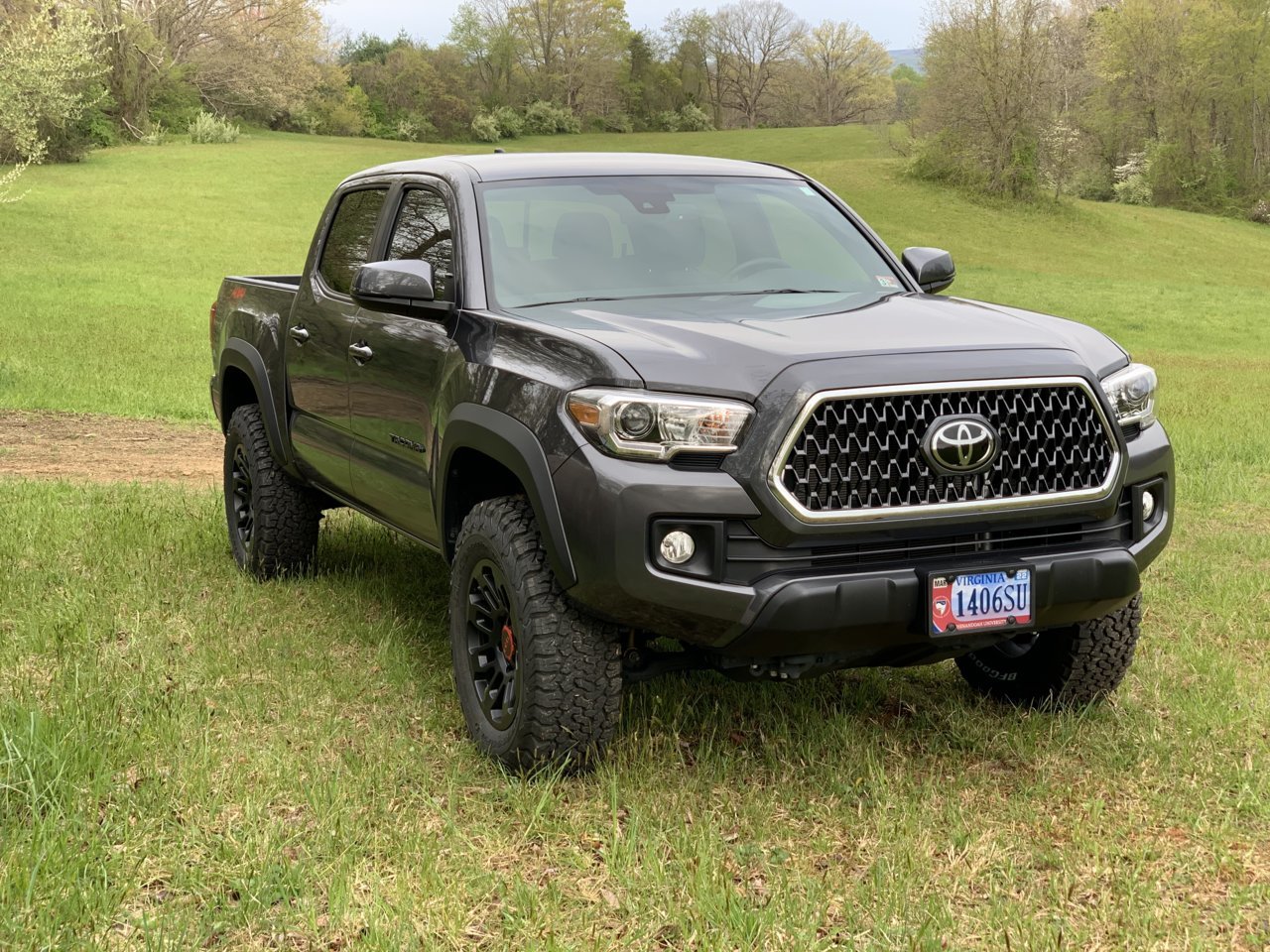

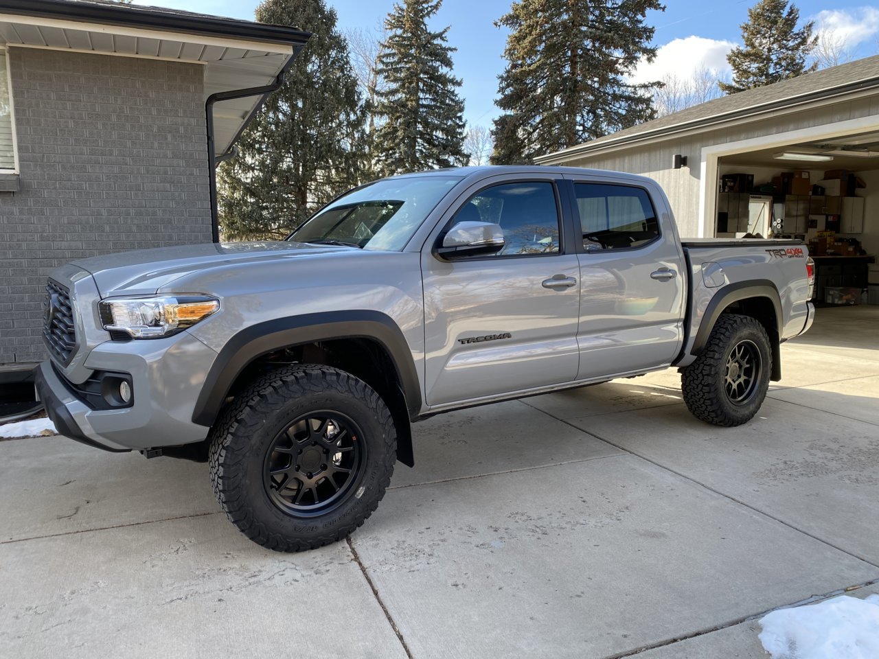

    Here is my stock suspension 2020 OR. Wheels are 17x8.5 w/ 0 offset. Tires are 265/70/17 (which is generally considered the biggest you can go on stock suspension without doing some cutting). Hope that helps!

    Helps a ton thanks! No issues with rubbing?

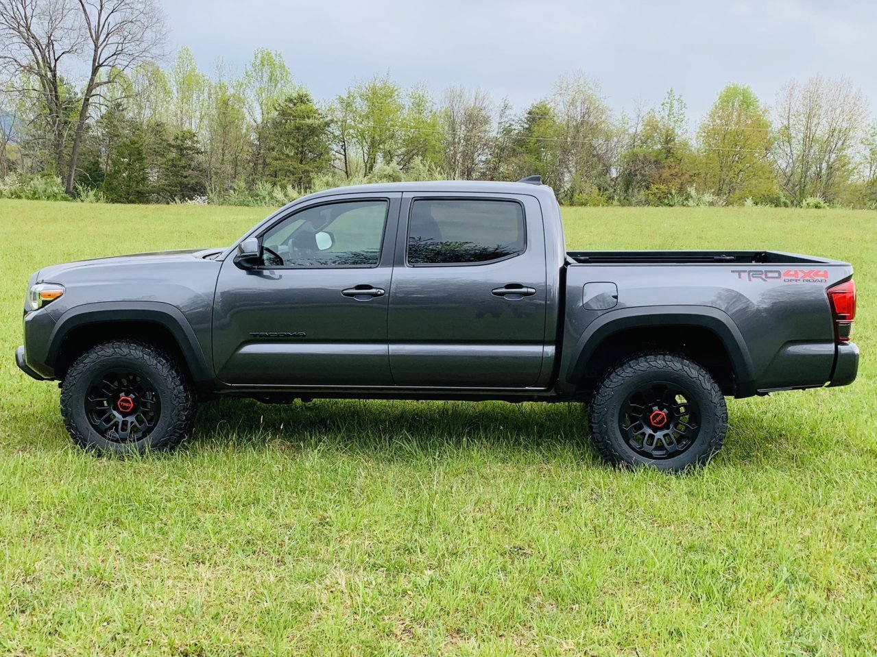

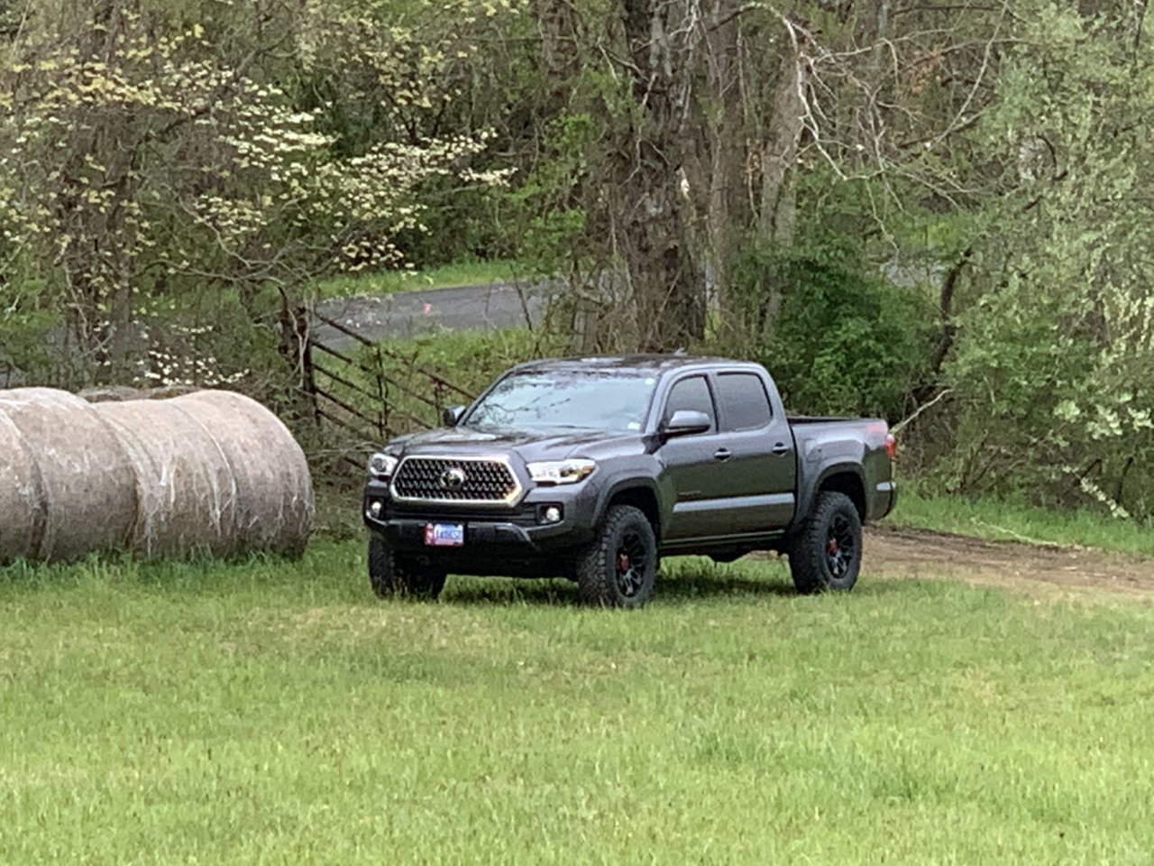

    17 x 8
    0 Offset
    265/70/17 BFG KO2s
    No rubbing
    Just make sure and remove mud flaps
