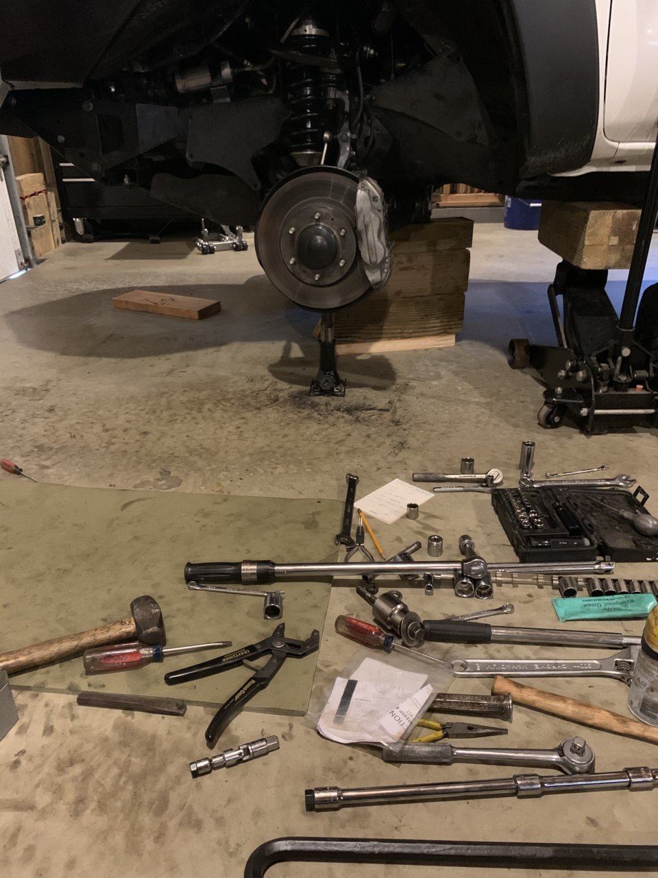

    ‘04 V6 5 Speed SR5 TRD downward spiraling project, ‘15 V6 6speed TRD daily
    The 1st Gen: All pro 3” lift (650 lbs coils, expedition rears with bilstiens),Timbren rear bumpstops, ubolt flip, diff drop, carrier bearing drop, 33’s on beadlocks ,ARB Bumper, winch, hand throttle, ARE canopy, roof bars, poly bushings all around minus the body mounts. The 2nd Gen: Leveling kit, roll up tonneau cover. 265/75/16’s
    So far, I’ve found that I end up spending more money on tools than the project I’m working on. Regear? Press, dial indicator, set up tools, sweet. Rock sliders? Sounds about like the right time to buy that welder I’ve been eyeing. I might have a problem.
