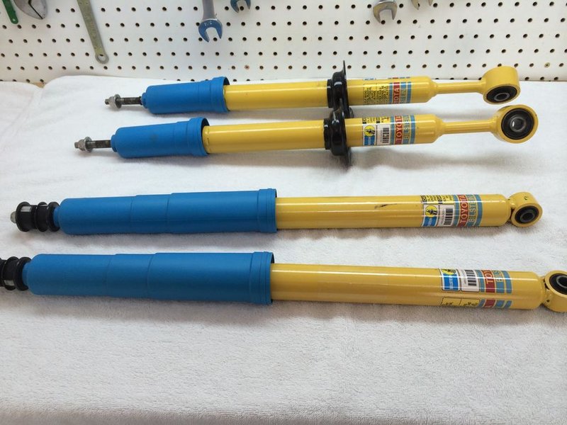

  15. Oct 17, 2020 at 4:28 PM
    #95
    Wattapunk
    Wattapunk Stay lifted my friends !
    Jan 26, 2010
    #30098
    4,075
    Uncle K
    TX
    2005 DCLB 4WD
    Pretty certain your factory Bilstein shocks looked like these when removed unless your truck is lifted but don't blame the tires just yet:

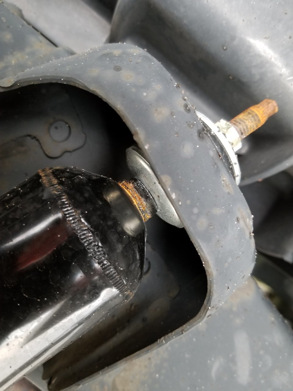

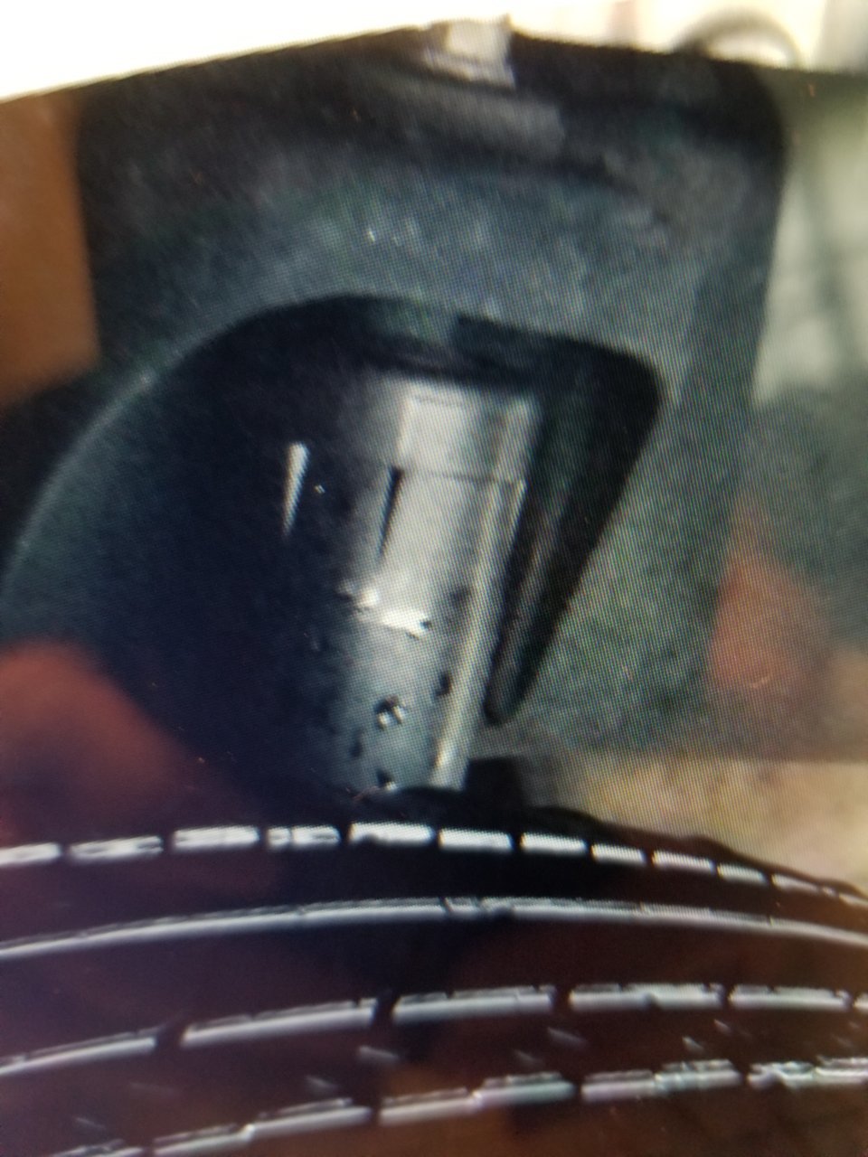

  16. Oct 17, 2020 at 9:20 PM
    #96
    LilEpad
    LilEpad [OP] Active Member
    Oct 3, 2020
    #342639
    30
    2014 Toyota Tacoma
    Wattapunk, after seeing your post I went back to review old pics. I believe you could be correct. At first I was just focusing on the dust cover, seeing all black. Closer inspection, that could be blue peaking through? First pic is of old shock, second and third pics day 18 of new shock :/
