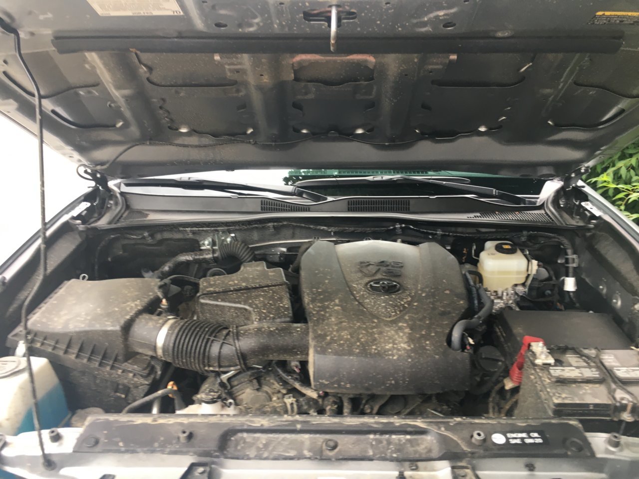

    What product can I use to clean out my engine? And any tips or advice for cleaning FL sandy mud from the undercarriage?
    Thanks!

    To clarify- wash/rinse the engine bay from sand and mud after some trails (not tear apart and clean for maintenance; it only has 1,100 miles on it lol). So, gentle spray with water?

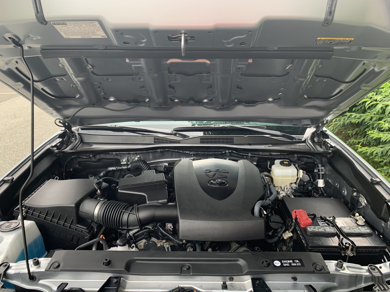

    Simple green, and plastic brushes. I pulled the battery out and covered the box behind it with a trash bag, just in case. Took about an hour, did wonders for the engine bay.
    I did use a pressure washer but stood on a ladder for more distance.
    Philly_, deanosaurus and Spare Parts like this.
  15. Jul 25, 2020 at 11:34 AM
    BKinzey
    BKinzey Well-Known Member
    May 5, 2016
    #186211
    1,520
    Beauford
    Hollywierd, CA
    2015 White Tacoma Access Cab TRD Off Road 4x4 V6
    RCI aluminum front skid, SnugTop, Sliders, bedside supports, LED interior, CaliRaised fogs & brackets, rear diff breather mod, DIY bed platform
    An HOUR? You are a better man than I Gunga Din.
    Looks good though.
