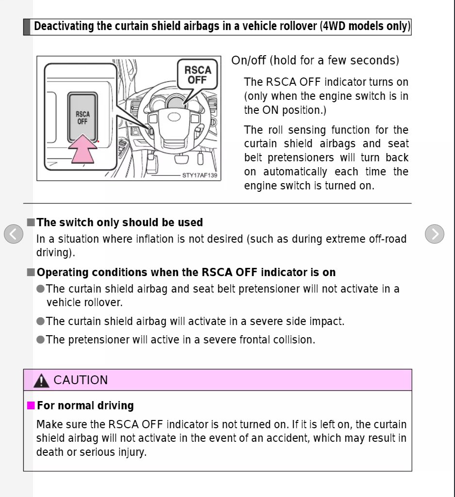

    #42

    Jun 30, 2020

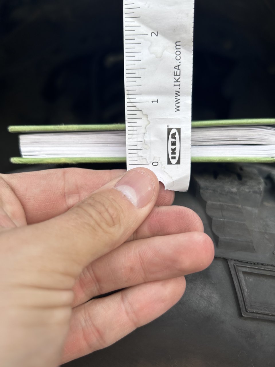

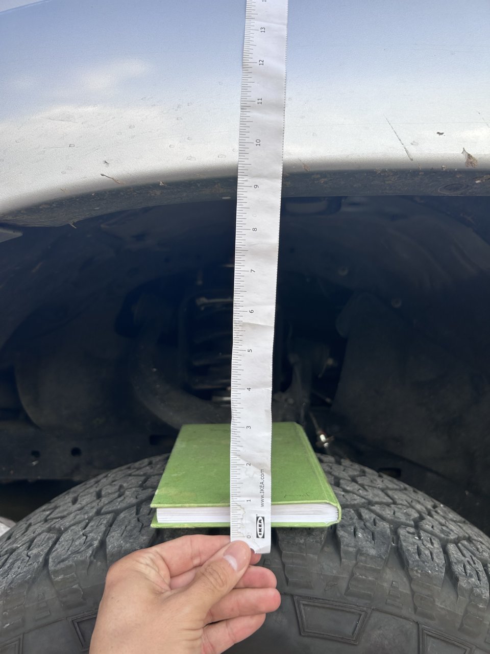

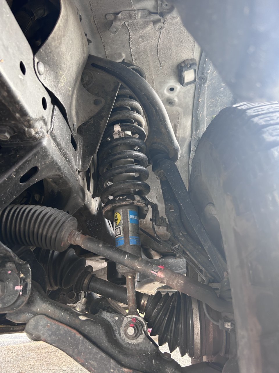

    #333050
    64
    Andy
    The Desert

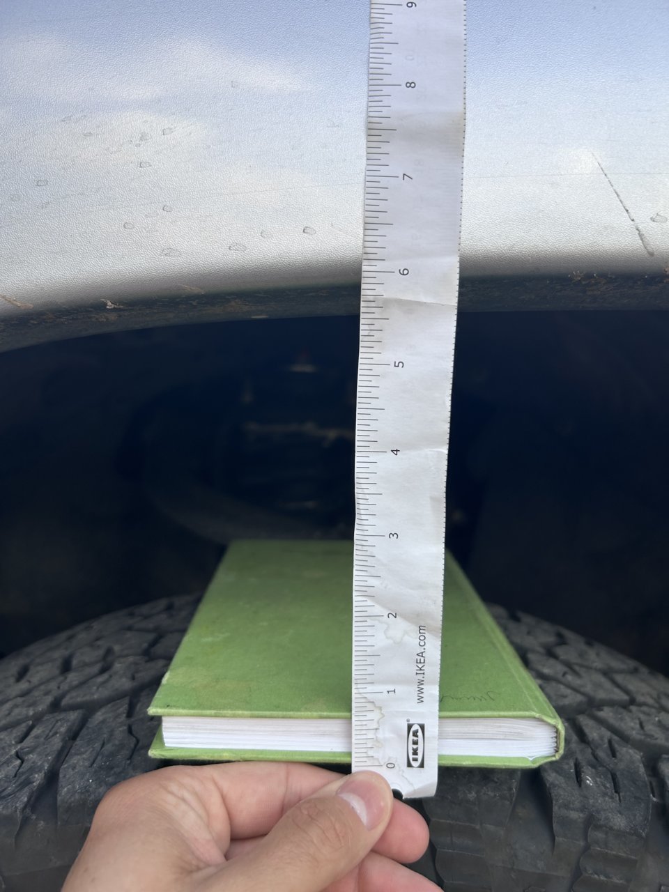

    I’m curious to know how your droop “increased” with 885s and 5100s over stuck?
    Ricardo13x[QUOTED] likes this.

    5100 are extended travel over the factory yellow shocks. 885’s provide the height without preload.

    Yes, 5100s are about 3/4s longer than stock, BUT you increased static right height by 1.5”. So that means you’ve got about 5.25” uptravel and about 3” of downtravel max. Stock is about 3 3/4 up and 3 3/4 down. Any more downtravel and you gonna start binding stock CVs/UCAs/LCAs.
    You can easily measure your downtravel by jacking up one side and paying attention to when your tire lifts off the ground.
    FWIW, I’m running 2” OME lift. I’ve only got 2 1/4 of downtravel. Nitrocharger shocks are stock length. So if I had extended length shocks, I would get 3” max downtravel.

    Don’t quote me on the numbers since I’m fully skidded. So give me a couple of hours to measure my current numbers. But I can tell you I’m like 1/8” from making any contacts or bind if I’m correct. Will provide sitrep later on.

    Numbers are in. Im currently Away from home and this is the only thing that I could have a measurements.
    First picture is at resting in the parking lot:
    Second picture is at full droop:
    The angle was kind of weird with the camera and therefore I opted to take a picture at the 0” level:
    third picture is no bind or contact at full droop:
    Junkhead[QUOTED] likes this.
