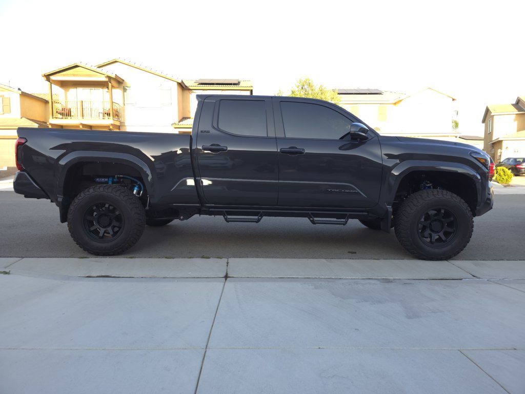

    RCI Engine Skid Plate, RCI roof Rack, air dam removal, King suspension, elevate UCA, ICON Rear Overlander Spring

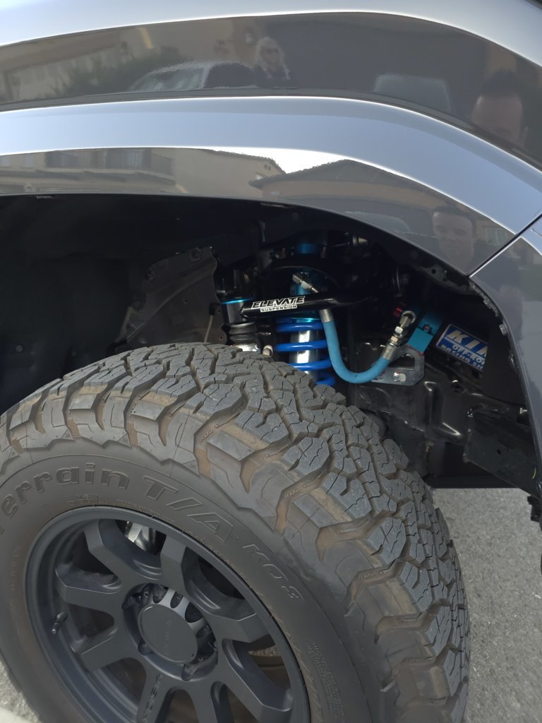

    King OEM kit for the 4th gen.
    Front: King P/N 25001-408A
    Rear: King P/N 25001-409A
    Rear Spring: ICON Overlander spring
    UCA: Elevate - sorry dont have a P/N
    First impressions, its wonderful. I had it installed at a 4WP that my buddy is the manager.
    The rear lift from the icon overlander spring is SIGNIFICANT, literally a solid 2.5-3in lift over stock without weight in the back. However, thats what I was looking for as i routinely have 1-2 dirtbikes in the back.
    The Fronts are currently set to roughly +2.0 - 2.5in knowing they will settle a little bit after some use.
    For the road, they feel good now that i backed off the compression adjustments all the way around. They are definitely a drastic improvement over stock, and give a massive confidence boost. They truck does not have as much body roll, and overall feels so composed.
    Ill do a YT video once i get to take it out in some dirt and find a good spot to bracket them.

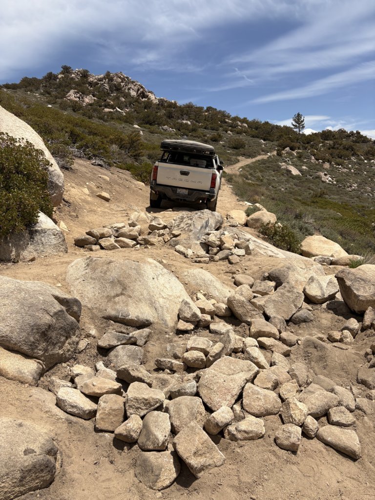

    We hit up the Cleghorn exit up the 15 freeway. It’s a quick drive from Orange County and then we take the extra credit runs off the main trail to make it spicy. This trail has bit me before and I had to replace my gas tank from the damage.
    I need to lift my truck as I’m dragging the rock sliders and the frame rails over large rocks..!

    Nice looking truck. I have a short bed Off Road on order that I should have in a couple weeks. Also have the same king suspension lift/shock kit ordered. I talked to King and they suggested keeping the same rear spring but I worry if it will be enough especially if I have a full size spare (running 35s) in the back and replace the OEM rear bumper with something more stout. I'll also want to tow a bass boat from time to time.
    It looks like you have an inch or so of rake when your bed is empty? Is that about right?
    This was the spring I was looking at - Im guessing this isn't as stout as what you got?

    Yes that's about right with the rake I have. The icon overlander springs are very nice when you have a few hundred pounds in the bed. Icons site states that it adds .5in of lift with 500 lbs in the back. The triple rate springs are similar to stock at the beginning of the travel and get stiffer progressively. The Dual-Rate/Overland spring linked here actually have some heft to them. https://iconvehicledynamics.com/accessory/26733/icon-accessories-icon-2024-2025-toyota-tacoma-rear-5-lift-dual-rate-overland-coil-spring-kit/
    I just got back from a trip up to the forest with the dirtbike in tbe back and gear and adjusted the kings to like 10 clicks on compression and it was absolutely perfect
