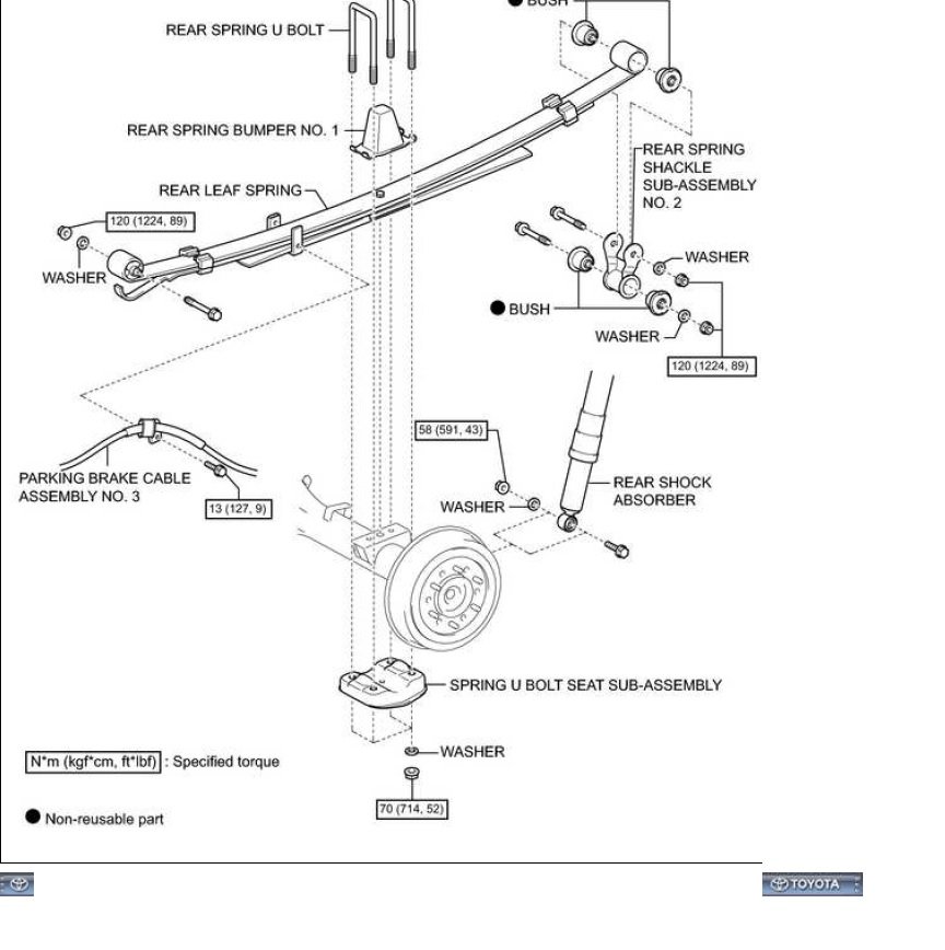

    The factory service manual...
    I created the u-bolt thread before the FSM came out.
    I used 75 ft-lbs because that is what I was accustomed to on my 2nd gen.
    52 ft-lbs is perfectly acceptable given correct diameter and thread size/pitch.

    I thought it was 83, but I haven't touched mine in a while so I could be wrong. The use of loctite is also part of OP's new problem.

    Would you care to ss it for me?

    I might be wrong but I recall the maintenance manual says not to reuse the u bolt nuts. I don’t know if anything bad will happen but since they are easy to do you might want to get 8 new ones.

    So they maybe torque to yield?

    According to this is not listed as non reusable parts
    edit: never mind those were for the bushing so not sure

    Aha, the Newton-metre rears its ugly head!
    How many folks here have torque wrenches with N*m units? Pretty sure mine’s in ft-lbs.
    Edit: I assumed this was a nod to the 70 vice 52 situash.

    U bolt threads are cold rolled and shouldn’t be reused.

    So it’s the ubolts not the nuts?
