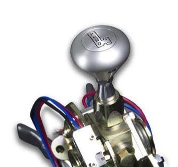

    You are looking for a Lokar component Desert Racing type shifter. It can be modified and installed in your Tacoma. Good luck.

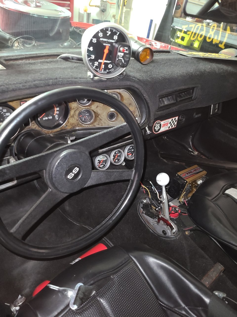

    Hurst Quarter stick installed in my Camaro :thumbsup:
