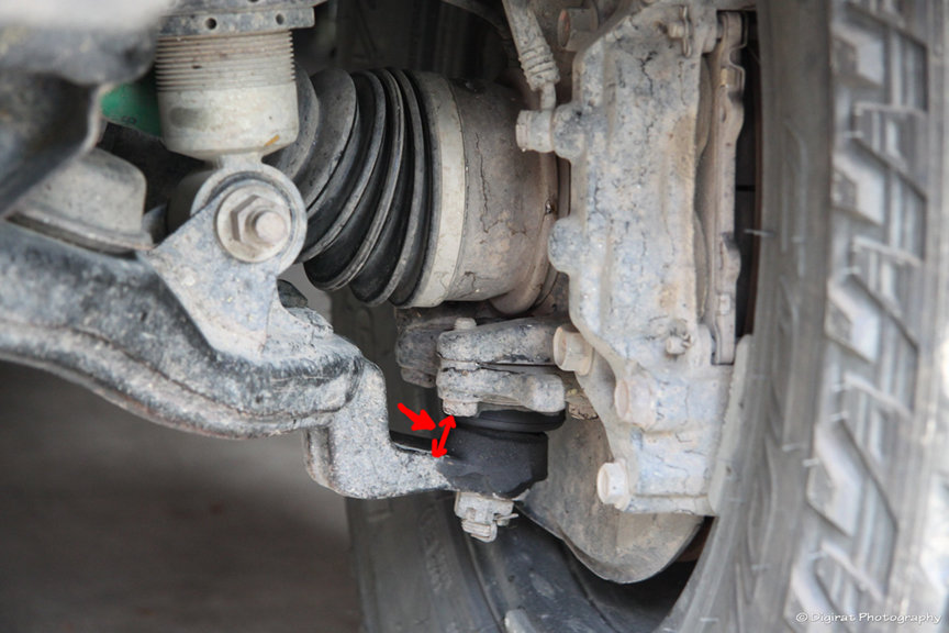

    with the wheels off the ground, I put a pry bar in this area between the LBJ bolt and the LCA. You can leverage it up/down that way and see if the ball joint has up/down movement
    pic is just one I found on google
    there was a video online awhile back of a mechanic doing this to a 3rd gen T4R with bad LBJs, where I got it from

    Great info, thanks for sharing pics of that!
