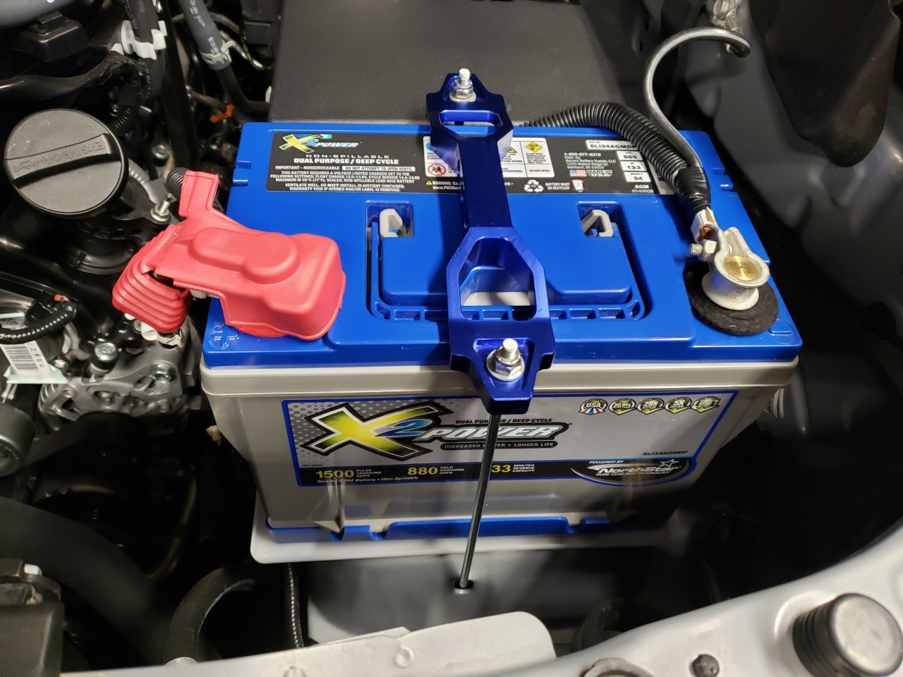

  13. Oct 9, 2019 at 6:08 AM
    Shellshock
    Nov 21, 2015
    #170338
    23,480
    Iowa
    27f fits no problem. I’ve got an x2power 27f in my truck (rebranded north star)
    Monte24 likes this.

  15. Oct 9, 2019 at 3:08 PM
    BOZOJUICE
    BOZOJUICE Well-Known Member
    Jun 22, 2016
    #190314
    66
    2016 dclb offroad 4x4 MGMSOLD/2023 ICE CAP PRO
    Looks like the wrong battery for that truck as ours takes 24f or 27f as the terminals are on opposite side of that model. Will it fit, yes, cables are stretched but in the event of a collision may give a problem. For example look at ShellShocks battery,X-power 27F terminal location on the AGM.
    G8R_Taco likes this.

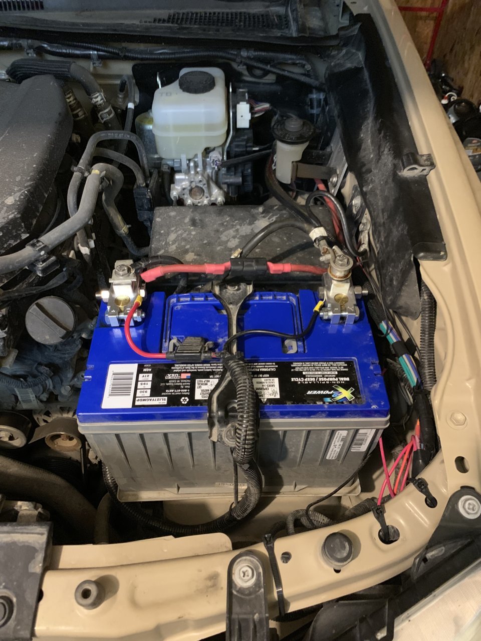

  16. Oct 9, 2019 at 3:18 PM
    #16
    ChrisK7UND
    ChrisK7UND Well-Known Member
    Sep 14, 2016
    #197268
    558
    Colorado
    2017 Tacoma TRD Sport Double-Cab
    LED Interior Bulbs, Hondo Garage Phone Mount, Tacoma Bed Mat

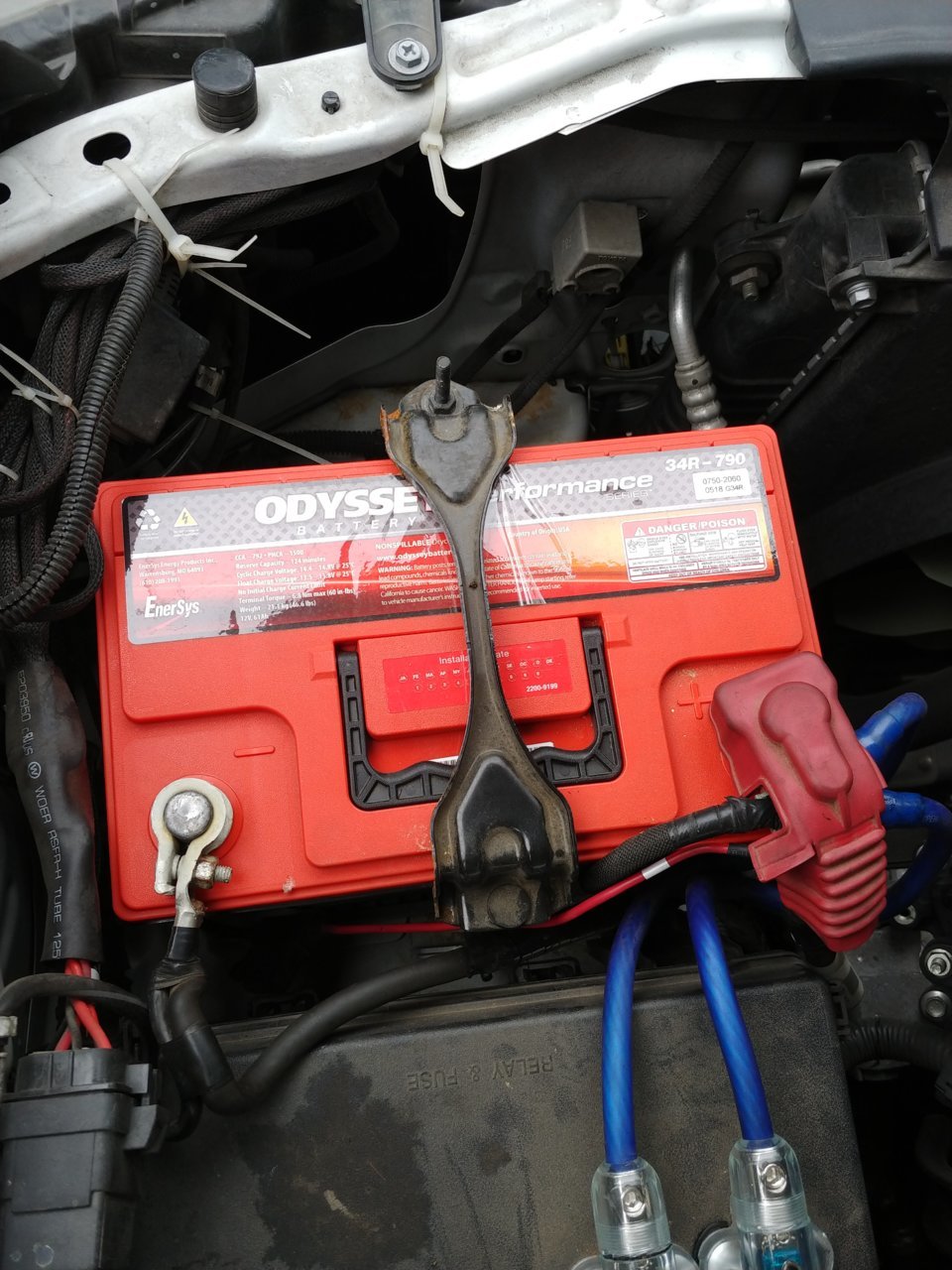

  17. Oct 9, 2019 at 4:04 PM
    #17
    su.b.rat
    su.b.rat broken truck
    Jul 30, 2016
    #193316
    9,869
    or a 34R..

  18. Oct 9, 2019 at 4:06 PM
    #18
    MtnFisher
    MtnFisher Well-Known Member
    Feb 17, 2019
    #283385
    1,088
    ZeroDrift
    Location: Behind enemy lines for now
    2019 Tacoma TRD ACLB V6 MT
    Currently running Goodyear DuraTracs with "ghetto" wheels
    34, no issues. Weighs less and cost less than the 24F yet has higher CCA. Cables are plenty lengthy , not stretched.
