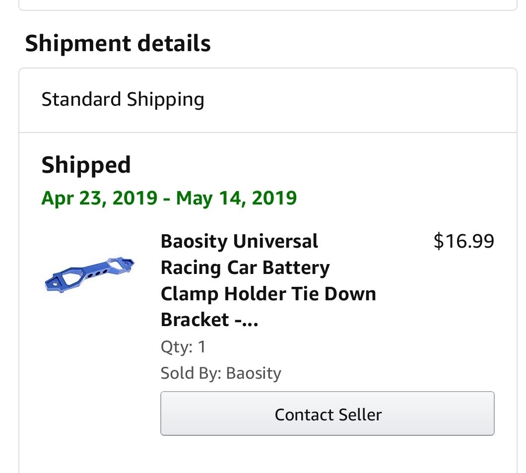

    Yes, so far so good. I check on it periodically to see if the battery has moved or shifted. You don't want to overtighten the clamp either as that could damage the battery.
