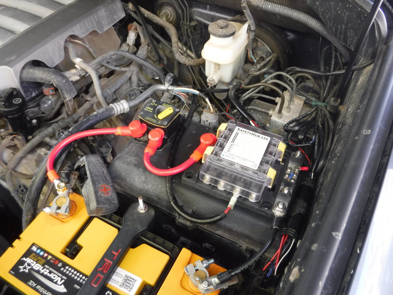

    Northstar here:
    I wonder how many people with wet cells ever check specific gravity even once?

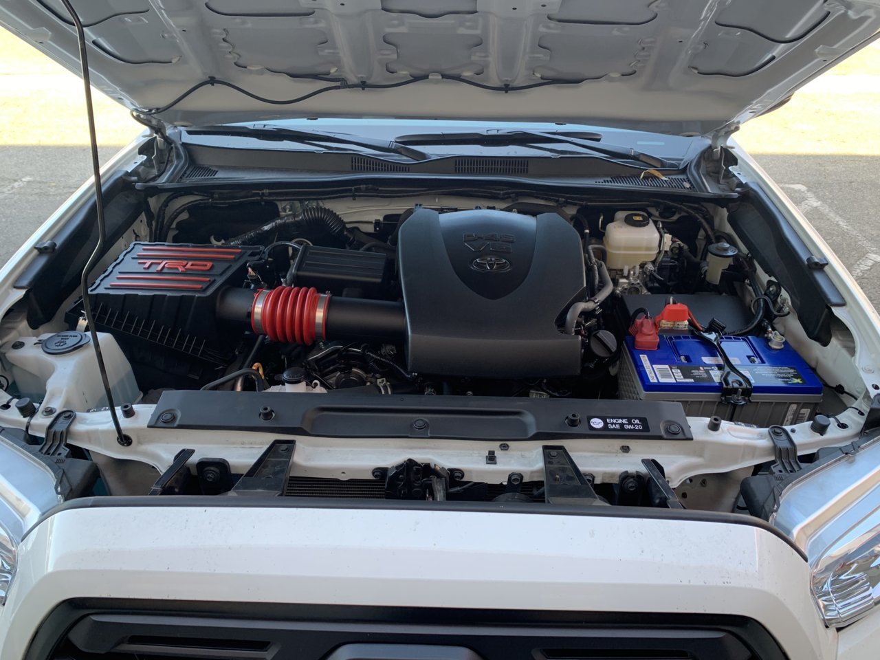

    Cool stuff
    X2 27F checking in. The starter turns crazy fast compared to the stock battery

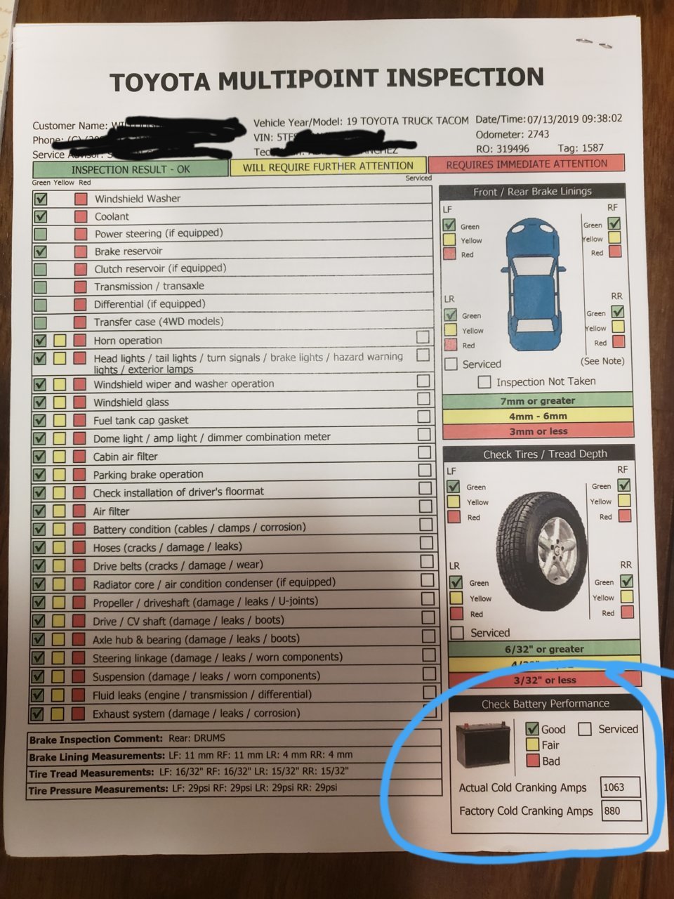

    My X2 has been stellar. Check out the load test results:

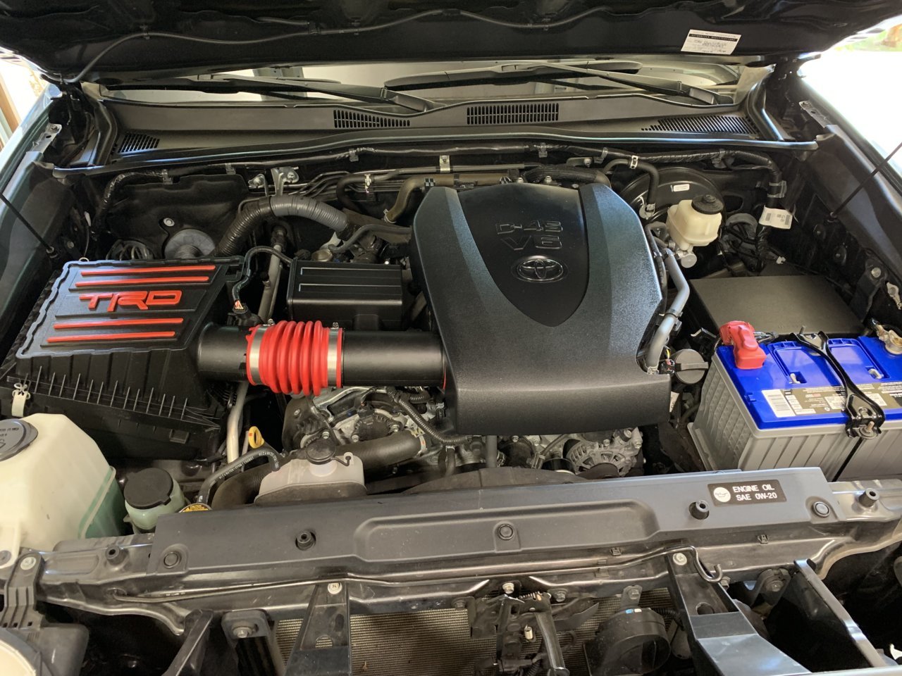

    Here is my 27F X2 from Batteries Plus Bulbs. My dash cam runs until a pre-set voltage and my truck sits weeks at a time but starts up really fast and strong every time. With the factory battery, the truck wouldnt start if i didnt unplug the dash cam. It fit well, I just replaced the plastic battery tray with one out of a 2nd gen with towing package and had to modify the mounting bracket by drilling out the fixed j-hook from the bracket and replacing it with a new j-hook with a screw/nut on the end. I still could have used the bracket without modifying it, but i wanted it to fit better without the bracket being slightly bent. I just wish it was red to match the TRD CAI that i have installed. 7C36E43D-0090-419B-888F-14D508DECA49.jpg
    Just noticed my engine bay looks exactly like @fake4x4 above! Even with the green windshield washer fluid!:cheers:

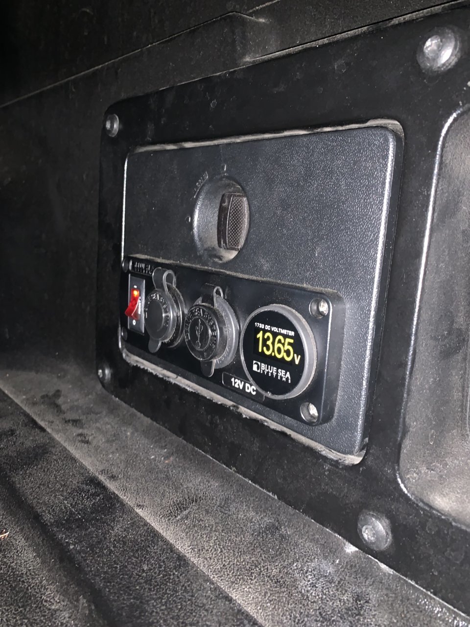

    The X2 27F AGM battery along side with this has been extreme useful, it feels good having access to a “hot” power source with the truck off. AD592A37-AB85-4826-83C5-7981480174FE.jpg

    Did you modify your book also like the guy above?
    I don’t need one now but have it on the purchase list for when the time comes.

    Did you mean Hook? If so, yes, that was me that modified my j-hook.
    I ground down the weld at the top of the j-hook attached to the existing battery mount with an angle grinder just enough to remove the hook, then i sanded the surface down and painted it black. Then i purchased a new j-hook and screw. I need to find my invoice to get those part numbers.

    Never said I “need” another battery. I’d simply like a little more. Like the member above said, he can feel how quickly his truck turns over compared to a stock battery.
    Maybe not scientific, but after seeing that dealer service invoice with cold cranking amps compared to stock above, it’s not like I’m what I’m noticing is far fetched..
