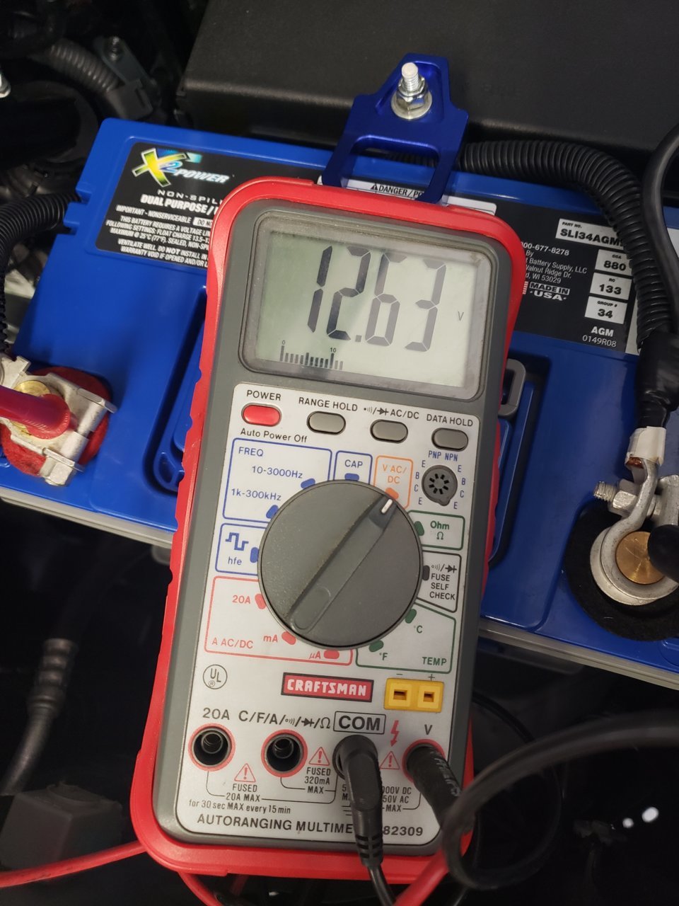

    Undercharging? My 2019 TRD Sport AGM's current standing voltage at 12.6V, on the OEM stock charging system:

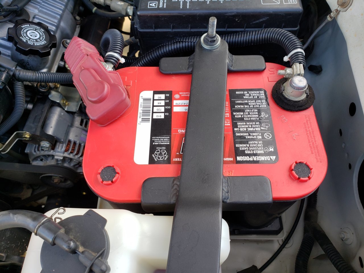

    My made in Mexico Optima AGM from my former 2002 Tacoma - OEM stock charging system, I did have to fab a custom hold down. It's still going strong, paid about $150 for it on sale back in 2016:

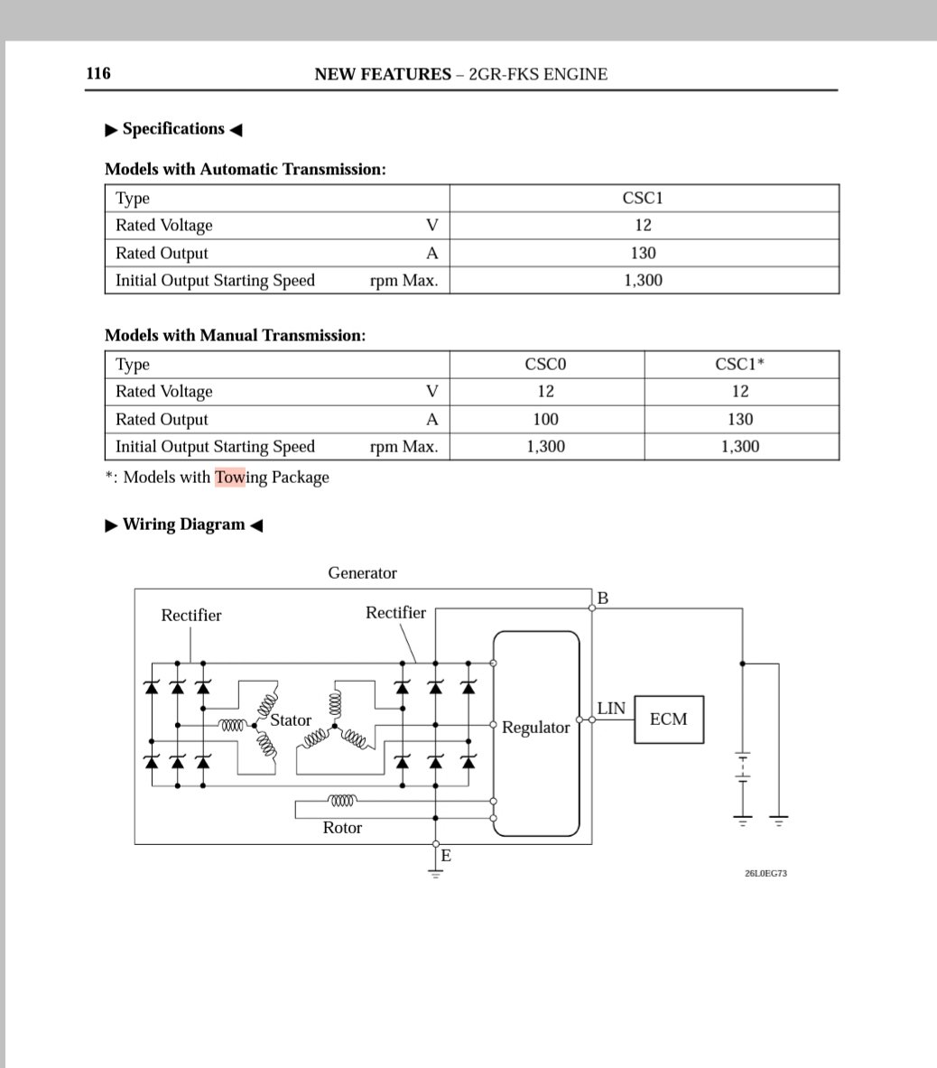

    Most of the 3rd Gen 3.5L V6s come with a high output 130 amp alternator, the CSC1:

    If mine is undercharged at 12.6V then it's not by much. Some sources state 12.6v is fully charged for all lead acid batteries including AGMs. One way to shorten a battery's life quickly is to overcharge it. It load tests fine and cranks over fast. Keep in mind I have been driving all week short trips, 3 miles one way back and forth to work so it's definitely going to be on the lower end of acceptable standing voltage.
