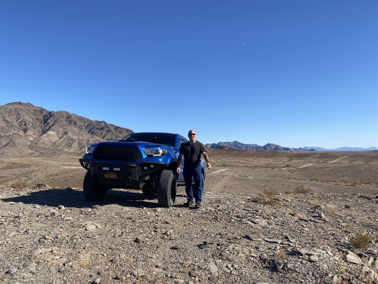

    I might could help Ya. Stock height, maybe a tad bit higher Vs some lift.
    pkmx[OP] likes this.

    After a little lift with 6112s and 650lb coils. They was fixin to throw me off this site after the above photo. Said I was ugly and such.

    That is one of the bumpers I was looking at! Did you do any suspension mods? Or does it look taller because of the bumper?
