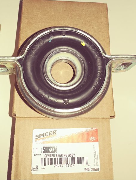

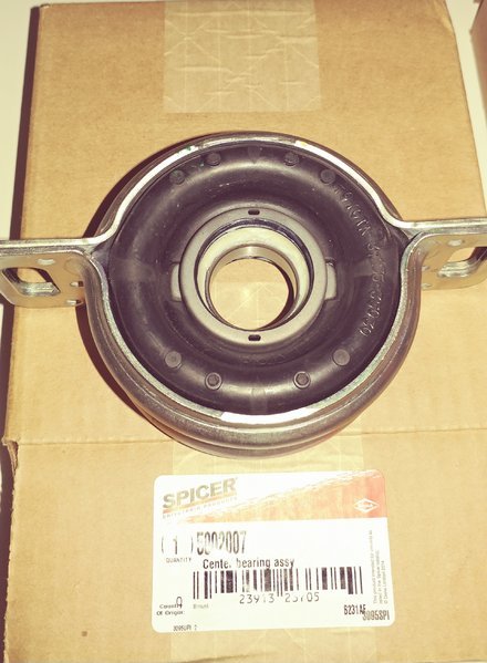

    I discovered that Spicer makes OEM carrier bearings and if you want to save some money you should buy Spicer branded ones. The part numbers for Spicer carrier support bearings are:
    2WD: 5002334
    4WD: 5002007
    Interesting note on the Spicer bearings is that there are Toyota part numbers on them. The 5002334 bearing has Toyota part #37230-0K040. Drivetrain America, which sells the 5002007 says its a replacement for Toyota part #37230-0K030, which is what is needed for 4WD. Having ordered the 2WD one by mistake, I ordered the 4WD one as well. The dimensions look identical. The only difference is the ends of the bearings on the inside. The 2007 bearing has a different Toyota part # however. It says Toyota 37235-35030, which after research has led me to believe its an OEM part number for overseas, probably a Hilux/Hilux Surf. Also there are differences in origin. 2334 is made in India while 2007 is made in Brazil. Also on the opposite side, the 2334 has Spicer, 5002334 and 4x2 on it but the 2007 has nothing more identifying it as a Spicer part with no Spicer part number, nor a 4x4 marking. As far as quality differences, the India made 2334 looks to be using a nicer looking rubber, mainly it seems to identify it clearly as a Toyota OEM product. Also the metal seems to have a nicer finish. Moving the bearing in my hands, I can feel no difference. Both smooth and quiet. Comparing the 2007 to part #37230-0K030 shows it looking exactly the same.
    Onto the main differences and this may be why one is 2WD and one is 4WD, looking directly at the cap around the outside of the bearing, inside of the rubber.
    5002334
    5002007

    Another carrier bearing option is the factory carrier bearing from Dana holding corp in which you can get through rockauto.com for $52.79. Just search under 2005 Toyota Tacoma, for some reason it doesn't come up for other years but it's the same part number - 5002334.
    I got one for my 2011 Tacoma DCSB and the damn thing even has Toyota stamped in the rubber bushing. Don't use the Dorman carrier bearing that thing is crap!
    DANA HOLDING CORP 5002334 [​IMG]

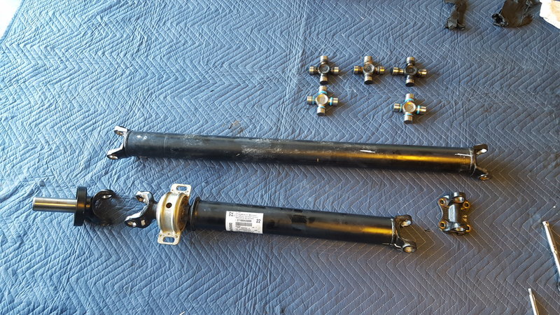

    The whole driveline of my 09 came with spicer components from the factoty. U joints, yokes, carrier bearing, etc. I know cause I just took it apart today.

    By the way guys I found the Spicer part # for 4WD. Its 5002007, not 5002334. The Spicer 5002334 bearing I got from rock auto has Toyota part # 37230-0K040 written on it. Did a little cross referencing of Toyota part # 37230-0K030 and got 5002007. So they are different but people have probably gotten away with installing the 2WD bearing because the dimensions are probably close enough. Wonder if it will cause any issues. Gonna have to research the exact dimensions.
