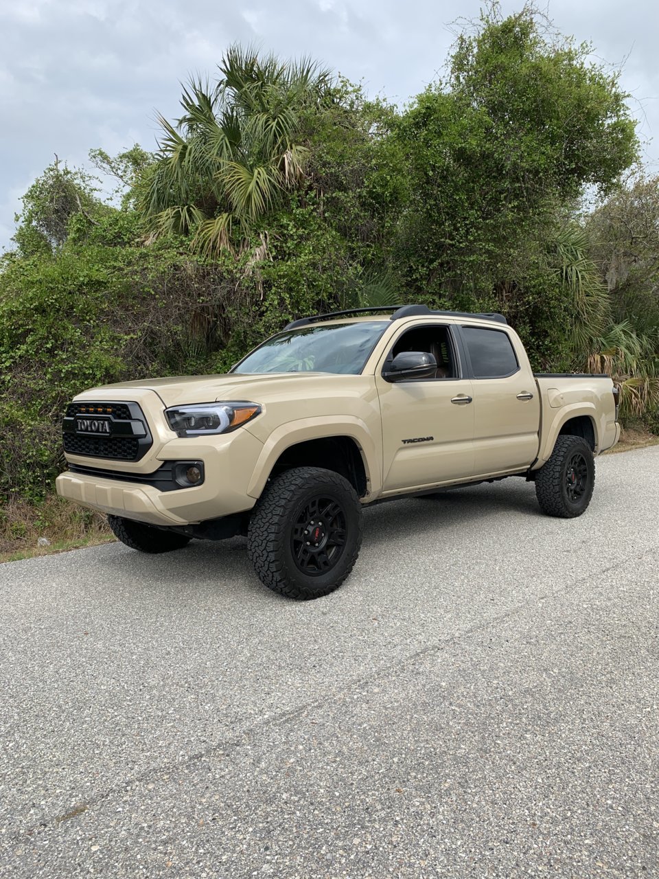

    Stock coils. I set it at the highest setting and I love how it drives now. Great handling and feels like a truck now. Felt too soft with the stock shocks until I got the 5100s. Popped a 1” block on the back and now it sits level and looks just like I wanted it to.

    Here is mine with 1” block on the back and at the highest clip on the front giving it 2” lift up front..
