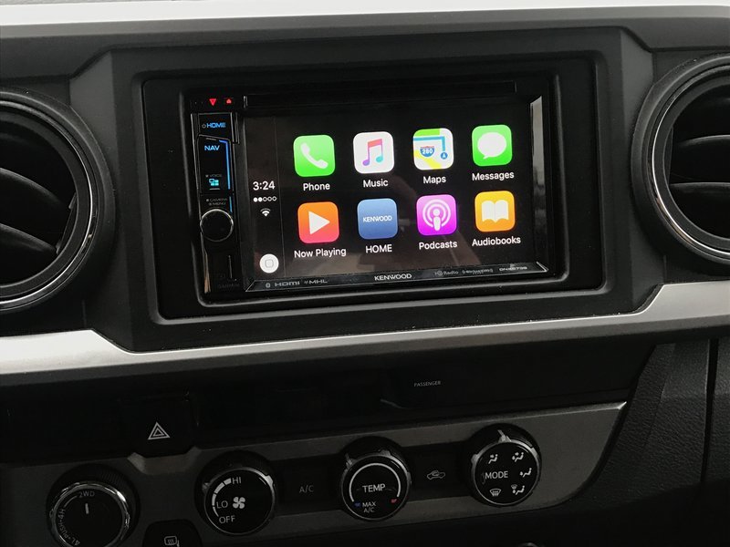

    Here is a picture of mine. Kenwood DNX573s with Apple CarPlay home screen displayed. My SR5 had the audio plus system without JBL. I installled with iDataLink Masteo and can still access all the settings my original could.

    Thanks for the photo ! I was trying to see what the deck installed looked like. I am looking at the two flagship models from kenwood and pioneer. I have owned a bunch of kenwood GPS units over the years but I am liking the look of this years pioneer. I appreciate the info.

    That looks great, do you have a picture of how the truck settings look on the Kenwood? Also, will it send data to the screen between the gauges?

    This deck pictured if I'm not mistaken is a Lil older. Still looks good and I'm sure functions better than factory for audio quality. The new ones or I should say bigger screens would prob look even better.

    Unfortunately I don't. It's kinda weird to get to, its settings, A/V, OEM setup. Then it's just a list and you touch to change so it looks kinda like this:
    Lights >
    Locks >
    It's not as nice looking at OEM but it's there. As for screen between the gauges it will send song info and messages like "incoming call". The navigation page will sometimes display turns and sometimes it won't. Not sure why but I haven't really looked into it because I prefer to keep that screen on digital speed and fuel economy.

    It's a current model. The DNX773s has a larger screen, which I almost got, but it lacks a volume knob, which I wanted.

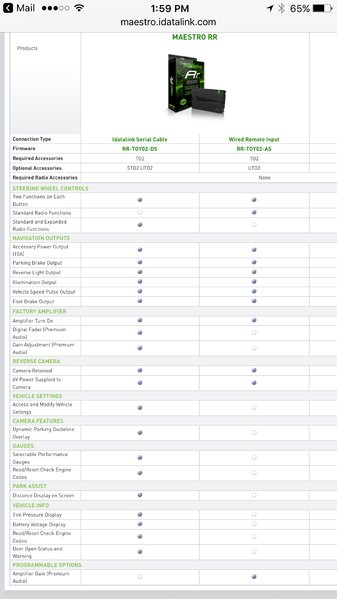

    As was stated up above.
    iDatalink Maestro RR covers all the OEM vehicle settings.
