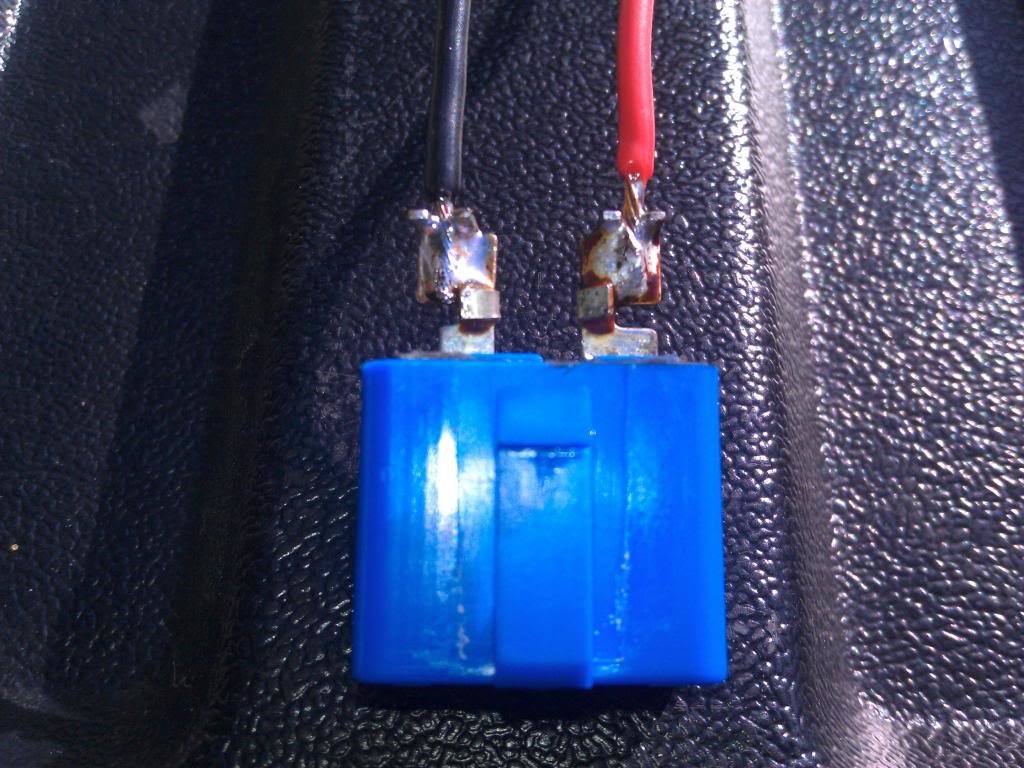

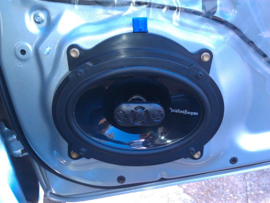

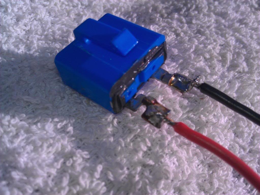

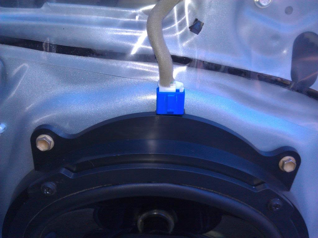

    Of coarse ideally you'll run new thicker wires to your aftermarket speakers from a 4 channel amp. But what if you're not installing an amp, and/or just don't want to bother with or don't feel like you need to run thicker wires? Enter this method :D
    Hack the plug off the old speakers, solder new wires to them to go to the aftermarket speaker, then it's just plug and play :)
    Just make sure to use plenty of heat shrink to insulate every thing at the plug (I use 3 layers since I sandwiched them in with the speaker adapter). Will be doing the rears just like this later.
