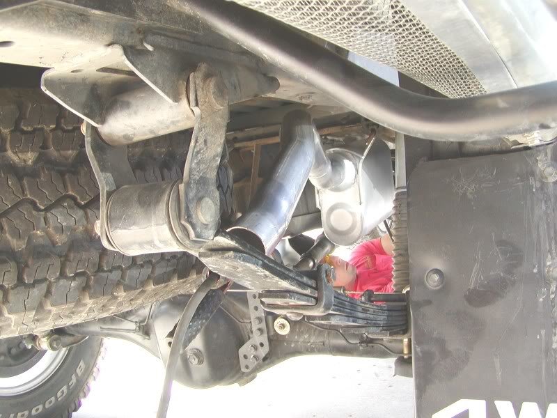

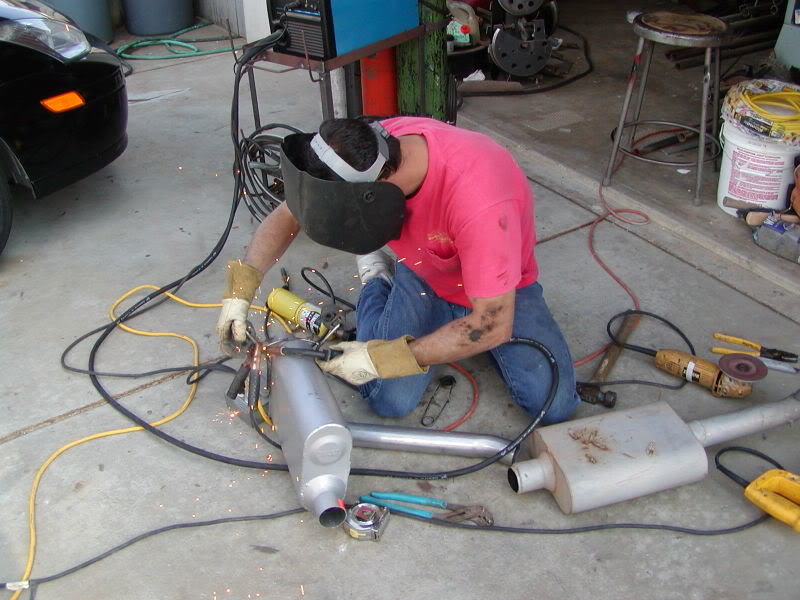

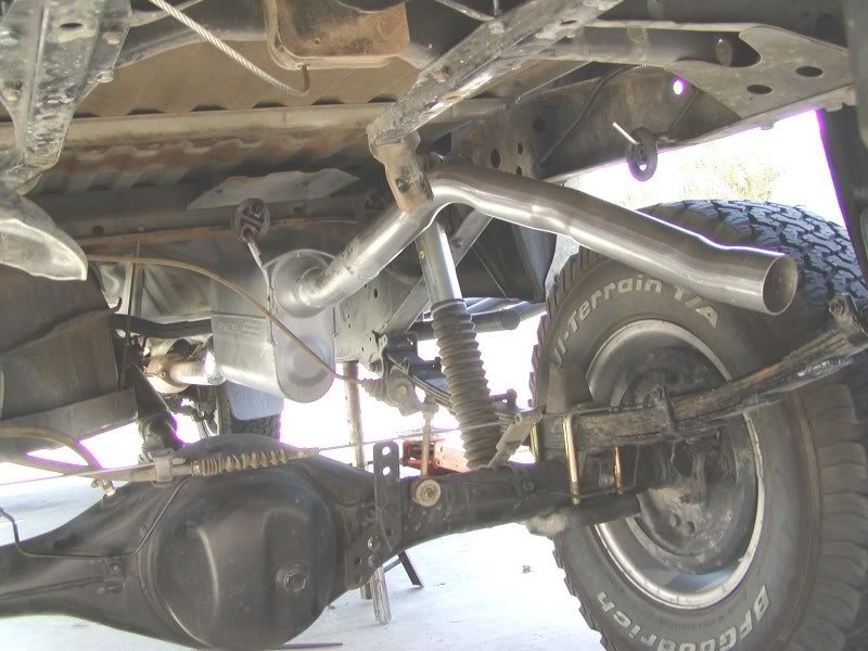

    I went with a FlowMaster 40 on my 3.4L
    Tho' a Magnaflow would've been quieter I'll suppose.
    3.4L sounds good with the FM40 tho'
    'cause I prefer to hear the exhuast note.
    Cost less then $ 100.00 installed.
    Maybe not purdy for the eyes...
    But it works well and has held up damn fine.
    Think I paid about
    $ 55.00 for the Flowmaster 40
    $ 10.00 for the 2.5" failed scrape tail pipe (from an install shop)
    $ 20.00 gift certificate and a 12 pak of bud to a friend for the welding.
    'cuz I didn't have my own welder then.
    I had my friend weld up the FM40 vertical for reduced impact/friction.
    The tail pipe was positioned and welded in place to arch over the axle.
    The muffler mounts and tailpipe mounts were altered slightly.
    But have stood the test of time.
    Rust is not an issue here in the SW.
    It's been on my rig since 2003 and has no leaks or rust thru.
    And has been hammered on thru many trails here in SoCal/Moab.
    I think it was well worth my low buck investment.
    TIG welded
    I have and know how to use my 220 MIG welder now
    and could do my own welding and replacement.
    But I haven't needed to as of 2016
    But if that day comes... It'll likely cost me even less ;)
